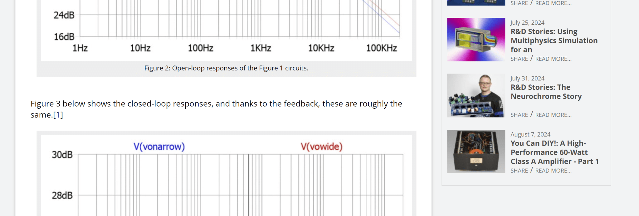

@flex2 - Nobody called you anything. All Jan did was to hold up a mirror.
Hopefully you've found time to read his article by now. I think he makes a pretty strong argument. Enough so that I thought of replying with a follow-up, until I realized that I really couldn't poke holes in his theory. It's refreshing to see someone who backs their opinion with data and established theory, in particular in a thread like this.

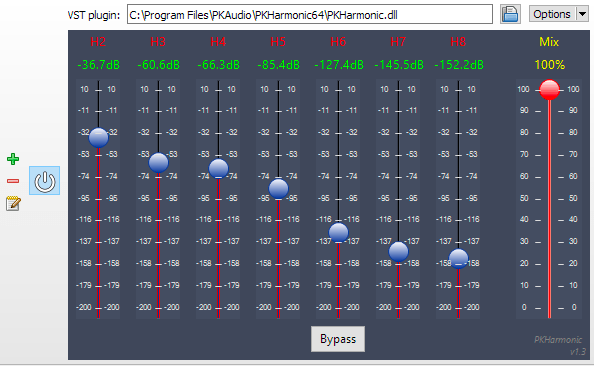

I think it's important to also note that what really matters is the threshold of someone being able to hear the distortion--not just being able to measure distortion, as the OP doesn't make that distinction very clear.
Hi and thanks a lot for the valuable advice I have a kind of conflict in mind
I notice that there is a need to show extremely low THD figures for the various projects
Meanwhile many comment on the fact that below a certain levels of THD further improvements will not impact the listening experience
i guess that in general low THD could be a sane goal ... but how low is not clear to me

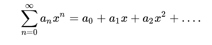

It is also interesting that the gain curve of a circuit can ,at least picewise, be expressed as an power series.
That can be expressed as
Compare that with a0 is DC, a1 is the fundemental. a2 is the amount of second harmonics, a3 is the amount of third harmonics and so on.
Så linear circuit has only a0 and a1. Unlinear has also the harmonic components a1,a2,a3 +++
So THD measures a2, a3 +++
