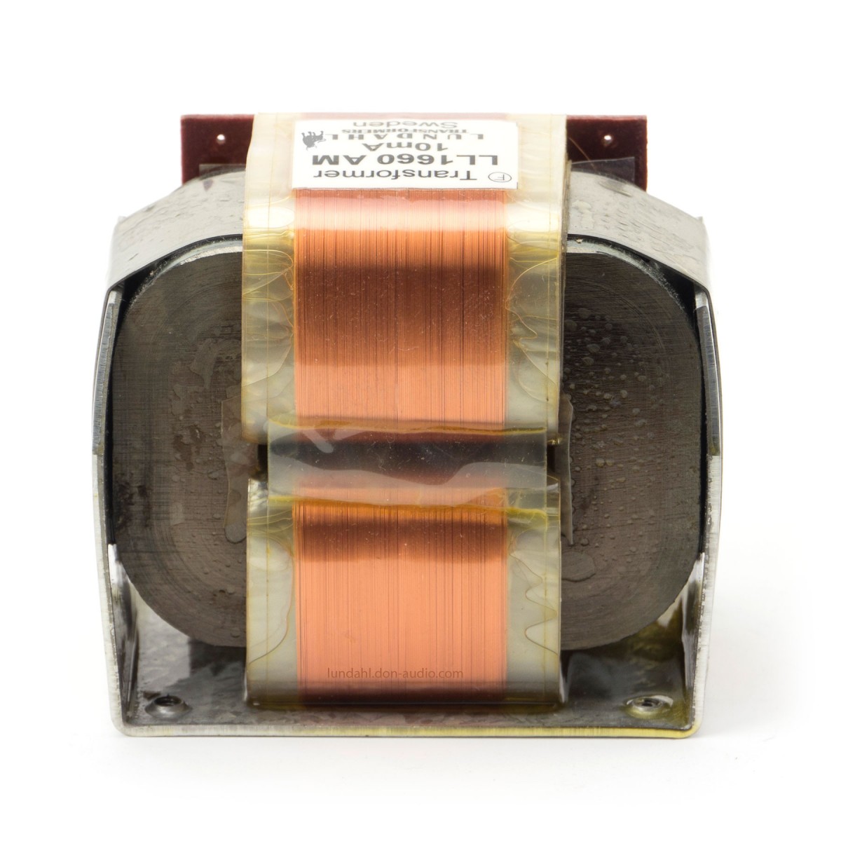

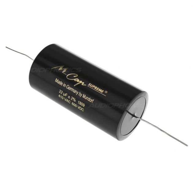

When is better ? Capacitor or Transformer Interestage. No which one is better.
When is better ?
I am not asking which one is better.
What is the relevant information to decide if is better a Capacitor or a Transformer coupling.
Maybe Plate resistance or Load resistance of next tube ?

With an interstage transformer, you can step the output voltage of the preceding stage up or down (and the current up or down for that matter), and you can't do that with a coupling cap. Interstage transformers are also useful for driving grids into A2.
For a circuit which has feedback around it, a coupling capacitor is a far superior choice. For a circuit where the finals are not driven into A2, a coupling capacitor is a good choice.
Transformers suffer from a number of distortion mechanisms, especially small transformers. Avoiding these problems when using a transformer is not trivial. Capacitor non-linearity are trivial by comparison. Transformer self resonance is typical less than 100KHz and can be within the audio spectrum while capacitor self resonance is typically 50MHz or higher. Any audio transformer must be loaded in order to avoid high-Q self resonance, and buffered by a relatively low impedance source in order to avoid low frequency loading. Transformer windings are a compromise between resistance losses and capacitance which aggravates self resonance frequency. Transformer cores are non-linear and saturate. Transformers are suitable for power supplies but rarely for high fidelity signals. Transformers are relatively expensive.

Btw capacitors have self resonance way below 50MHz and any audio cap bigger than an inch or two will have SRF <100kHz and those huge audiophile caps may even have SRF below 50kHz. So they need to be loaded as well. As a matter of fact even a dream perfect cap must be loaded b/c there must be a DC path at both ends.

Transformer coupling was the royal choice when film caps was huge and expensive . i have tried IT coupling many times with some lundhal models and at the end allways ended with RC coupling with a cheap russian silvermica cap . there is another path if you have power tube with current on the grid it's the CL coupling but you need a bigger Cap to avoid low F resonnance ( usually 1uf)
my choice :
for pentode driver CR coupling is the best choice ( high R)
for high mu triode IT coupling
for DHT low mu (high R) LC or CCS /CR

Well what's the performance at 100Hz? Or 20Hz? Transformers struggle at the low end due to saturation. PP caps can be less than 0.0001% distortion and nice and cheap, with less hum pickup.

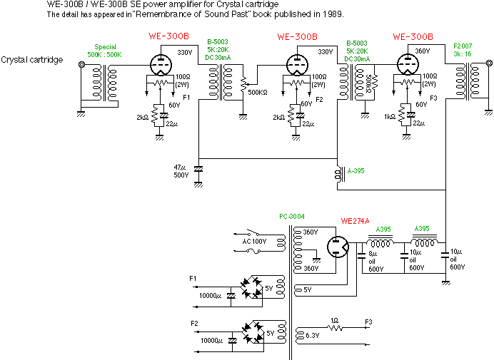

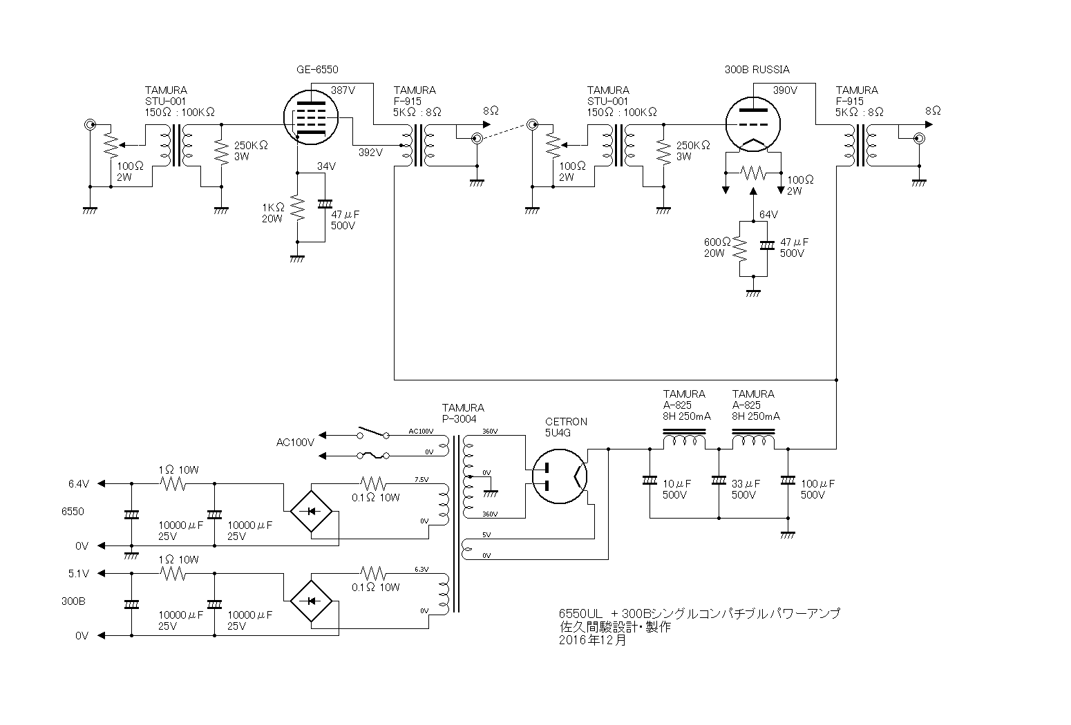

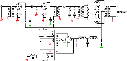

I know are Tamura and Tango transformers , but what about this ?

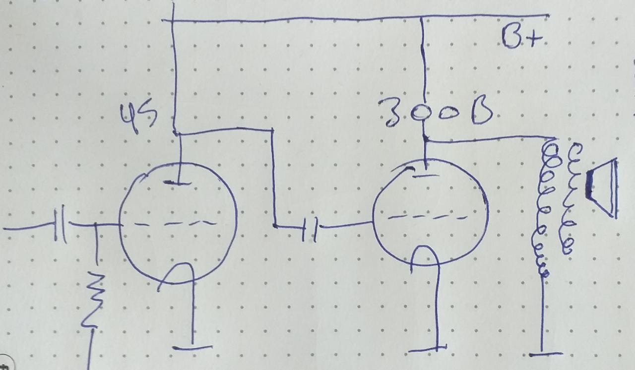

I do not know why , some people tell , nothing better than a good (Decent) IT transformer.
Some claim that a mediocre capacitor is better.
But would I like to know when it could be better?
I am building a amp with 45 driving a 300B. Is posible with Cap or only could be with one IT among them.
