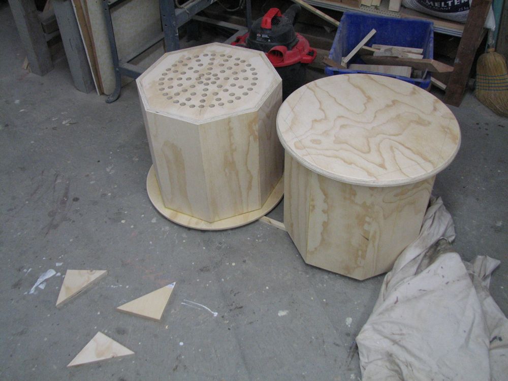

I'd imagine enclosures using holes or narrow slots (but no cloth or foam) like Karlson's 2nd K12 having a distributed port consisting of narrow slits, will at small signal, have input impedance which looks like a reflex but under dynamic conditions, the drag will cause the first impedance peak to disappear at some point.
Karlson's K12 with the slit vent, if driven by sine in the vicinity of Fb, produces very high vent velocities which would blow out a candle up close with 1 watt input. Also, there are many strong overtone harmonics created with sine drive and the slit vent K12. Those would not be there with a single vent. I perceived them as harmonic distortion but Dr. Geddes says the correct term is "modulated noise". Can this modulated noise alter the way music sounds? - or are the transients usually too quick to excite the effect?
Its an interesting technique for higher Q speakers. Your rule of hole diameter, spacing, and number to drill sounds like a good place to start.

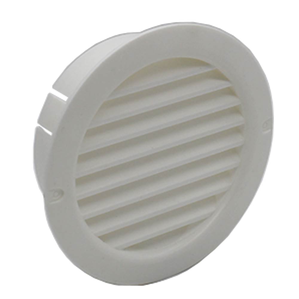

Like this.There's some sort pf PVC pipe grill which might make nice looking "variovent" copies.
probably - or perhaps sandwich the damping material beween two of this piece called a "termination grill" - It has the ludicrous price of $15.58 at US Ebay - They might be tough to press fit and keep in place - ?
here's more mucking with hornresp - looks like those grills might have too much area for some use ? - or just need more resistance.
