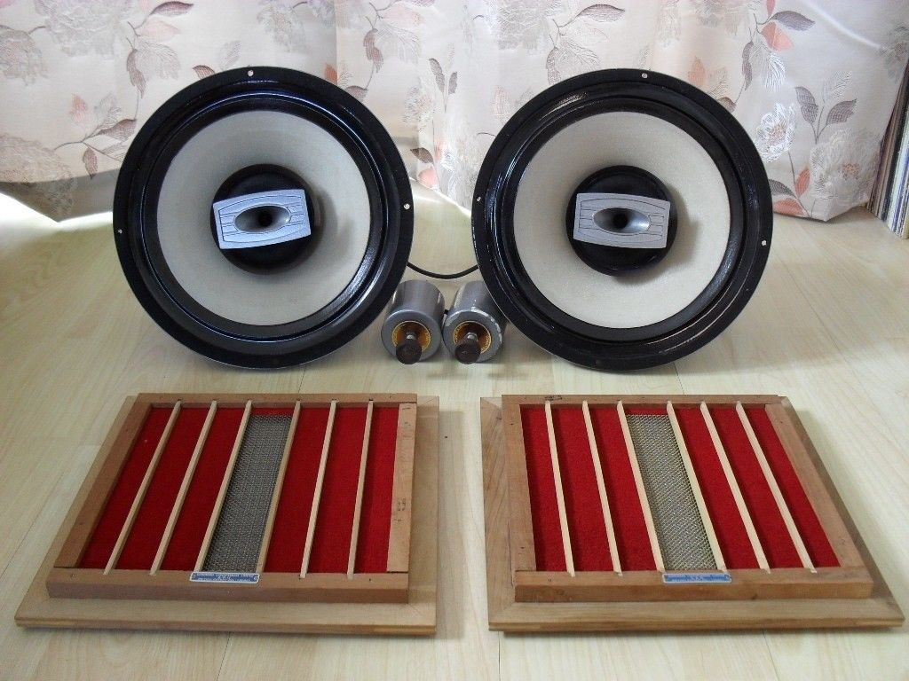

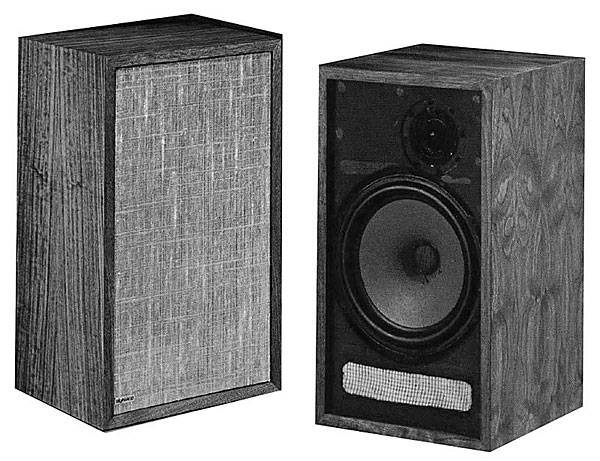

Yes freddi, the first mention of the use of an acoustic resistance unit (ARU).
As you will be aware, Dynaco would later adopt the design shown in Fig.1 in their A50 speaker which was vented, via the ARU, into the bottom half of the cabinet.
The design shown in Fig.3 was adopted in the A10 and A25 speakers which were vented, via the ARU, to the outside of the cabinet.
