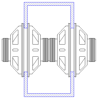

In 1998 Martin Logan launched the $120,000 flagship Statement Evolution_2 speaker which used eight proprietary 12" (30.4cm) paper cone drivers per sub-bass tower in a BalancedForce™ array. Picture 1 shows how eight woofers, each in a separate sealed enclosure, can be mounted in back-to-back counter-force pairs, and then optionally pair-stached into a line array topology that helps smooth out some floor/ceiling room mode effects.

2) putting each woofer in a separate enclosure assures that air displaced betweem the woofers does not interact to unevenly rock the cone suspension. Top-bottom woofers in one common air volume will produce unequal air force in the center than in the corners which can rock the cones, generating distortion and early failure. Similar cone-rock occurs in ported speakers if the ports are only in the center or only at the bottom of the cabinet.
3) back-to-back woofer pairs can be wired to perform as: bipoles, or dipoles, or cardiods with some added delay. This provides great flexibility for optimizing the listener's preferences for bass polar response, as well as flexible room placement and controlling room modes.
