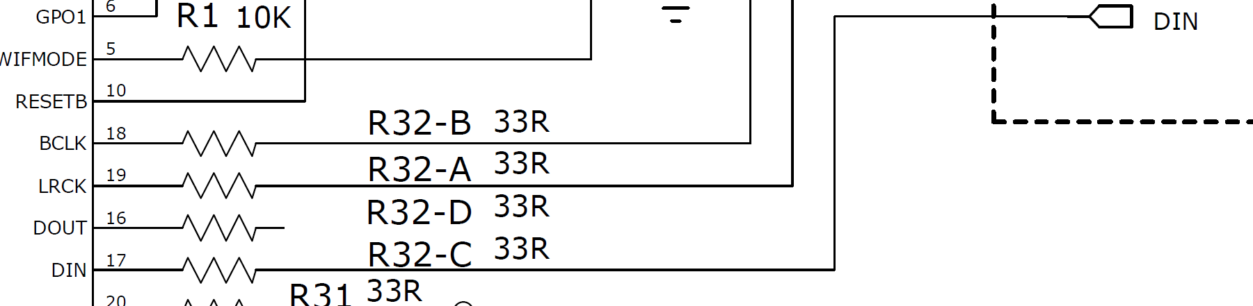

I see, @MRamone . I stripped the Whazon schematic down and made it suit your description.
I'm pretty sure WM8805 can take I2S feed and put it out at its SPDIF output. The datasheet does hide it somewhere in the software control area, and needs some digging and shoveling. Although Whazon does not use I2S as input, I do have a pi hat HiFi Digi+, that operates exactly that way with WM8804, same chip as WM8805 less SPDIF mux.

hi Nattawa,
I have been looking at the schematic you very kindly drafted for me and i have a few questions. Sorry in advance if some of them are a bit dumb...

- In the schematic that you drafted to adapt your project to raspberry pi, wm8805 pin 16 DOUT seems to be left unconnected. I think in your original design this pin goes to the i2s interface. Is it correct to leave it unconnected?
Original Whazon uses the audio interface as output, so Dout goes to a connector (although a jumper is provided so that Din can go to that connector as well as an option).

- *edit: regarding the DOUT connectivity. Could it be that DIN in wm8805 needs to be connected to DOUT at the raspberri pi side and not to DIN as indicated in the schematic?
"DIN" is named as seen by WM8805. It is a label given to a net, rather than an implication of its origin/target. However, I agree it could have been named "neutrally", such as "data" simply.
