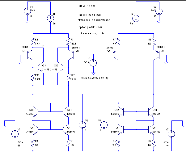

TIM/PIM and input stages
I don't recall, has the use of compound pairs for input stages been discussed as a means of reducing TIM/PIM? I've attached a picture of a circuit comparison I did between a normal diff pair and a compound diff pair. Sure looks like the compound diff pair improves the linearity of Iout vs Vin quite a bit.
Here's the sim if anybody wants to play around with it. I had to make the emitter resistors 110.4 Ohms in the compound pair to get ths same transconductance as the normal diff amp. This was to make up for the re contribution to gm in the normal diff pair.

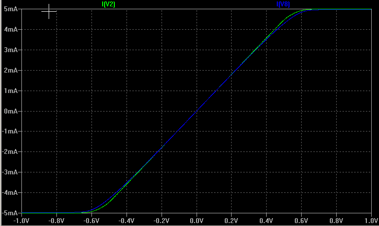

Looked at the distortion of the closed-loop amp after swapping out the diff amp. This was a 20 kHz with an output voltage equivalent to 300 W into 8 Ohms. At the moment, the output stage is an idealized unity gain VCVS. I've been looking for ways to reduce the distortion of the input stage/VAS combo. Here's the strange thing. Prior to putting the compound pair in, distortion was dominated by second harmonic, with the third 20 dB down from the second (about -120 dB vs -100 dB). When I put in the compound pair, the second dropped by 20 dB, making it the same as the third, and the third did not budge! I have a theory about this but you'd think I was crazy.
andy_c said:...When I put in the compound pair, the second dropped by 20 dB, making it the same as the third, and the third did not budge! I have a theory about this but you'd think I was crazy.
better make sure this observation is true for different BJT specimens, otherwise you could back up a cul de sac..
Here's what's interesting. The second harmonic of the compound pair by itself is no better than the second harmonic of the simple diff pair. So I started to think in terms of PIM rather than TIM. You'd expect TIM to correspond to third-order harmonic distortion mostly. But what about PIM? Well, for frequency modulation (same beast as phase modulation really), when the modulation index is small, the FM signal consists of the fundamental, plus only two sidebands, at fc - fm and fc + fm, where fc is the carrier frequency and fm is the modulation frequency. But for plain old instantaneous phase modulation with a single sine wave, the carrier and modulation frequency are one and the same. The fc + fm term becomes the second harmonic. So I'm guessing that the second harmonic that was dominating before was actually the manifestation of PIM.
