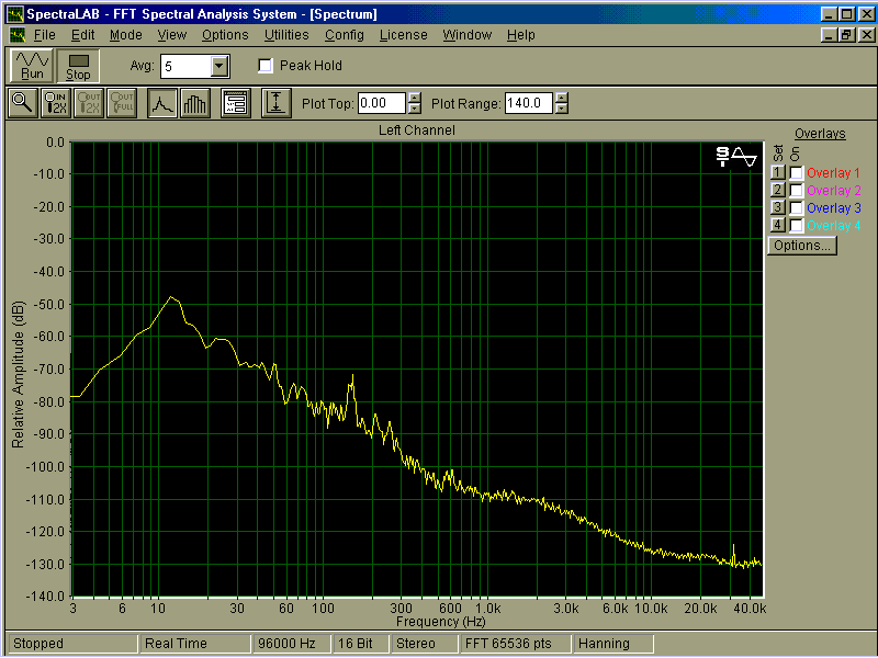

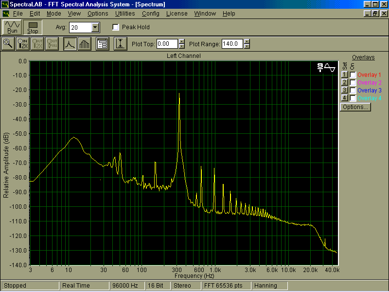

I was also measuring the spectral content at the output of CD players above 22.05 kHz. I will prepare the english version of the page.
