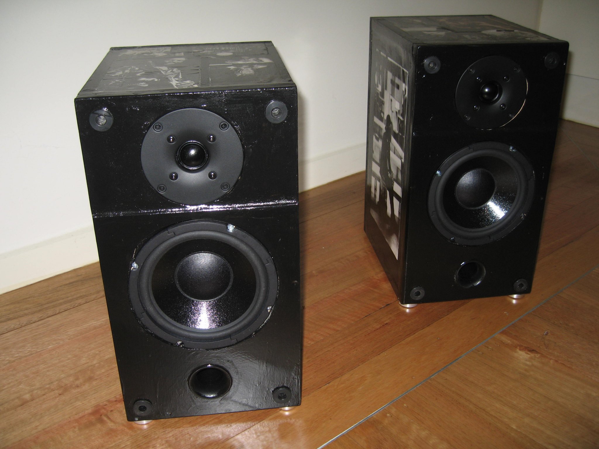

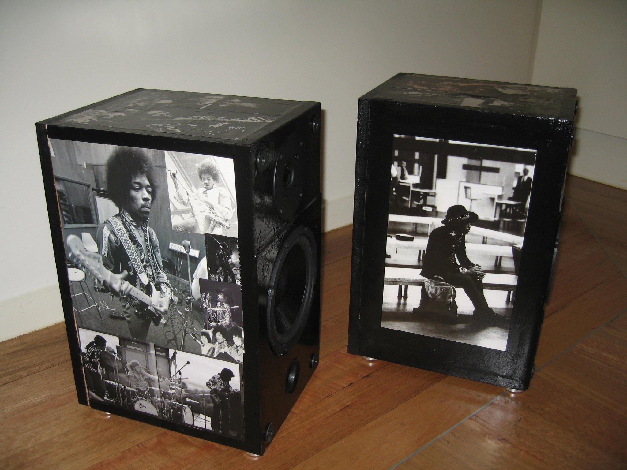

I find the imaging for both is fine; when it hasn't been, that's usually the fault of the recording/production.I should have mentioned that I'm hoping for some good/fair 3D imaging.
As you can see, my handiwork is pretty rough but these were the first cabinets I built. I use them on stands.

Trying to figure out who the guy is on the side of the box. Is that you? 😏I find the imaging for both is fine; when it hasn't been, that's usually the fault of the recording/production.
Geoff
I like the time alignment you've done on the baffle. How did you arrive at the offset? 😉
Actually I've never done a veneer finish.

The guy on the cabinet is the great Jimi Hendrix, passed away in 1970 and still the best electric guitar player.......
The 'time alignment' was an accident (!), it's not supposed to be like that, but it's only about 2mm and I don't think (or hope!) that makes a difference to the sound.
