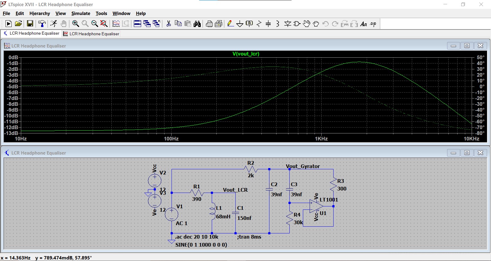

This was a design (the LCR bit at the left) for an equaliser for a headphone amp for folk with impaired high frequency hearing. The opamp is a different means of doing the same thing (a gyrator).
It will give you something to play with. Gyrators are at the core of many multiband equalisers.

I use LTSpice for my crossovers (passive/active line level, discrete or opamps) and everything else.
It is powerful tool that goes way beyond PLLXO if that´s what you eventually want but it serves your purpose anyway.
Its GUI might look a little dated but the program is constantly improved.
(I´ve been to a workshop from the programmer of the SW)

LTSpice is very quick to learn if at all coming from circuit lab.
Press R,L, or C to place the part. Put voltage sources in place, in- and output resistances. Make a AC-simulation and you´re done in literally a minute.
LTSpice is used by many engineers not without reason.
My colleagues use it for SMPS design and even HF-circuitry (pulse trains and eye diagrams)
