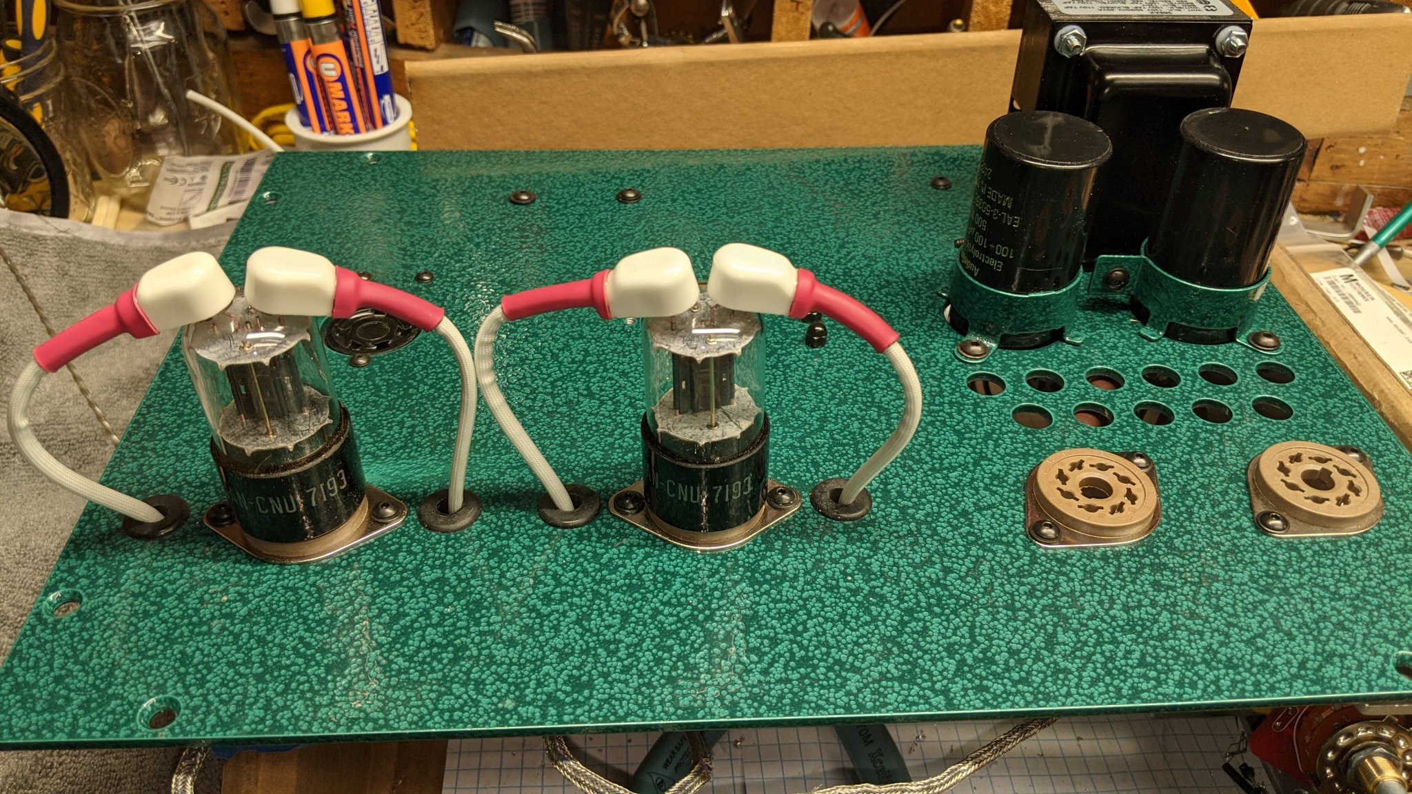

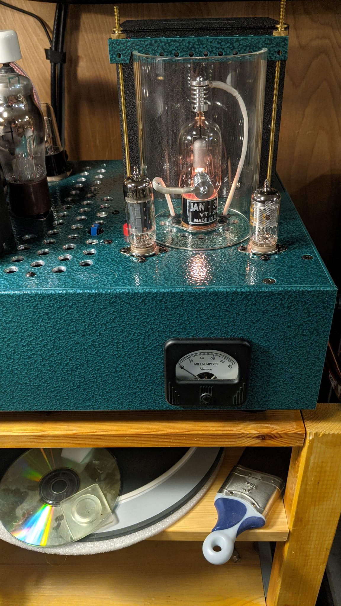

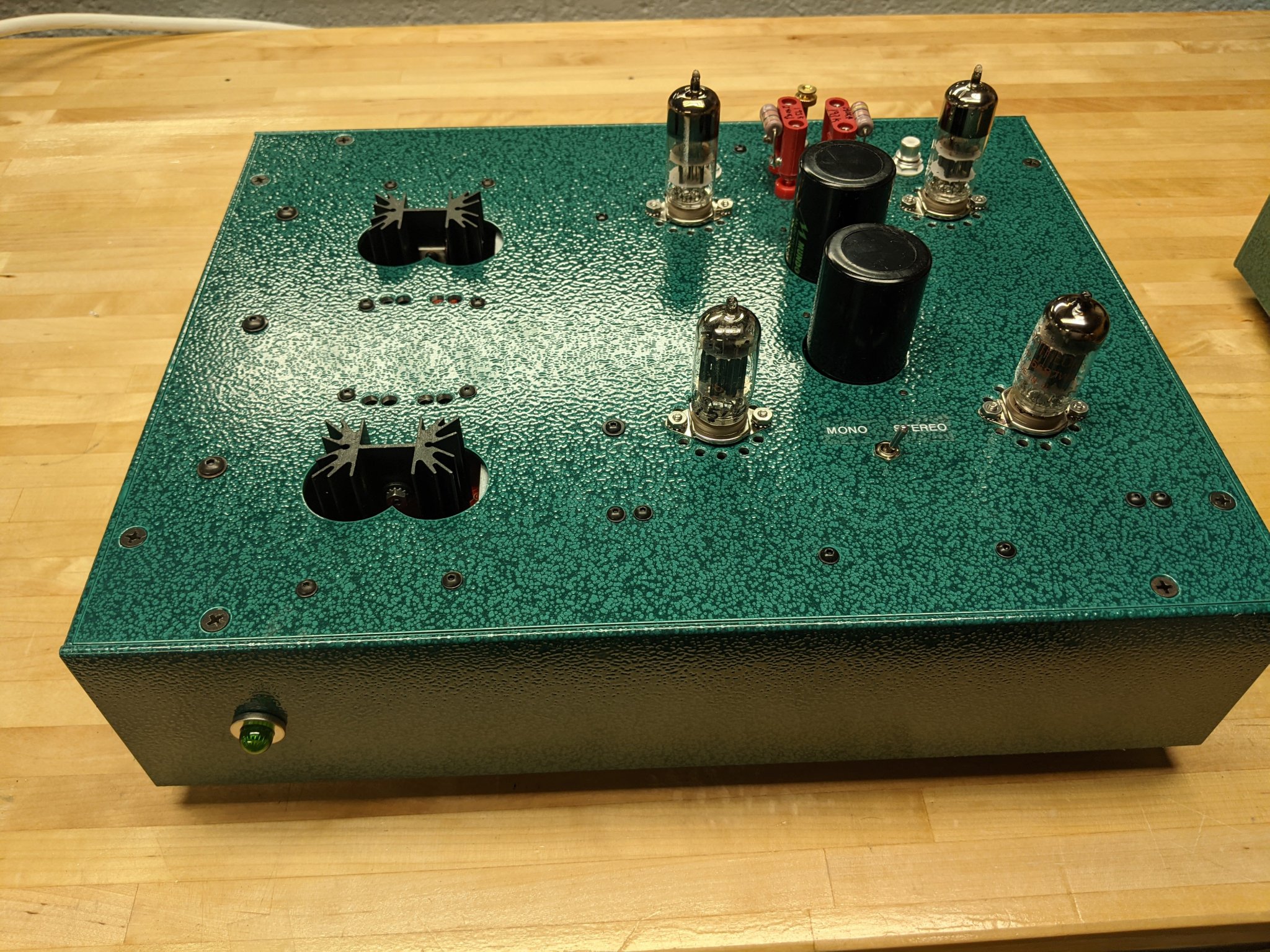

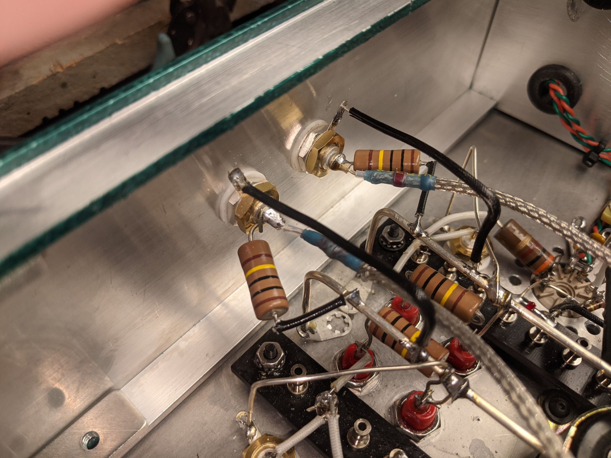

I powder coat my builds with malachite green hammer-tone at home. Takes a bit of equipment but worth it if you are going to do a few chassis.
The lettering is done with a Brother label maker with transparent film/white lettering. They make a black too. It is called lamination film I believe. Looks good and holds up fine for years so far. The label is very slightly visible under strong light.

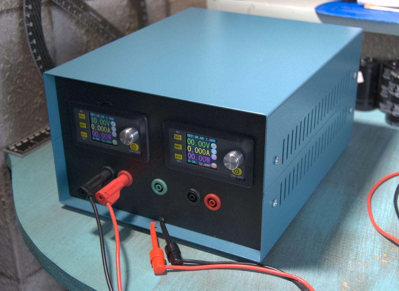

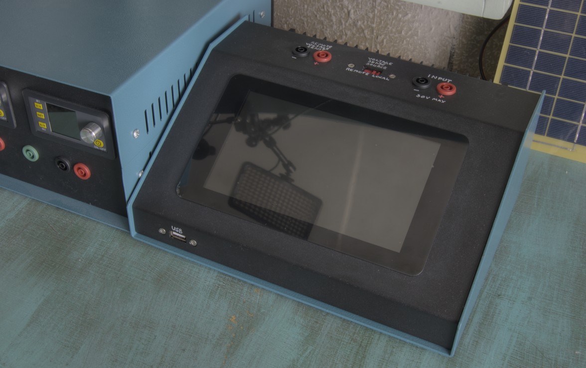

Here's a couple I've used:

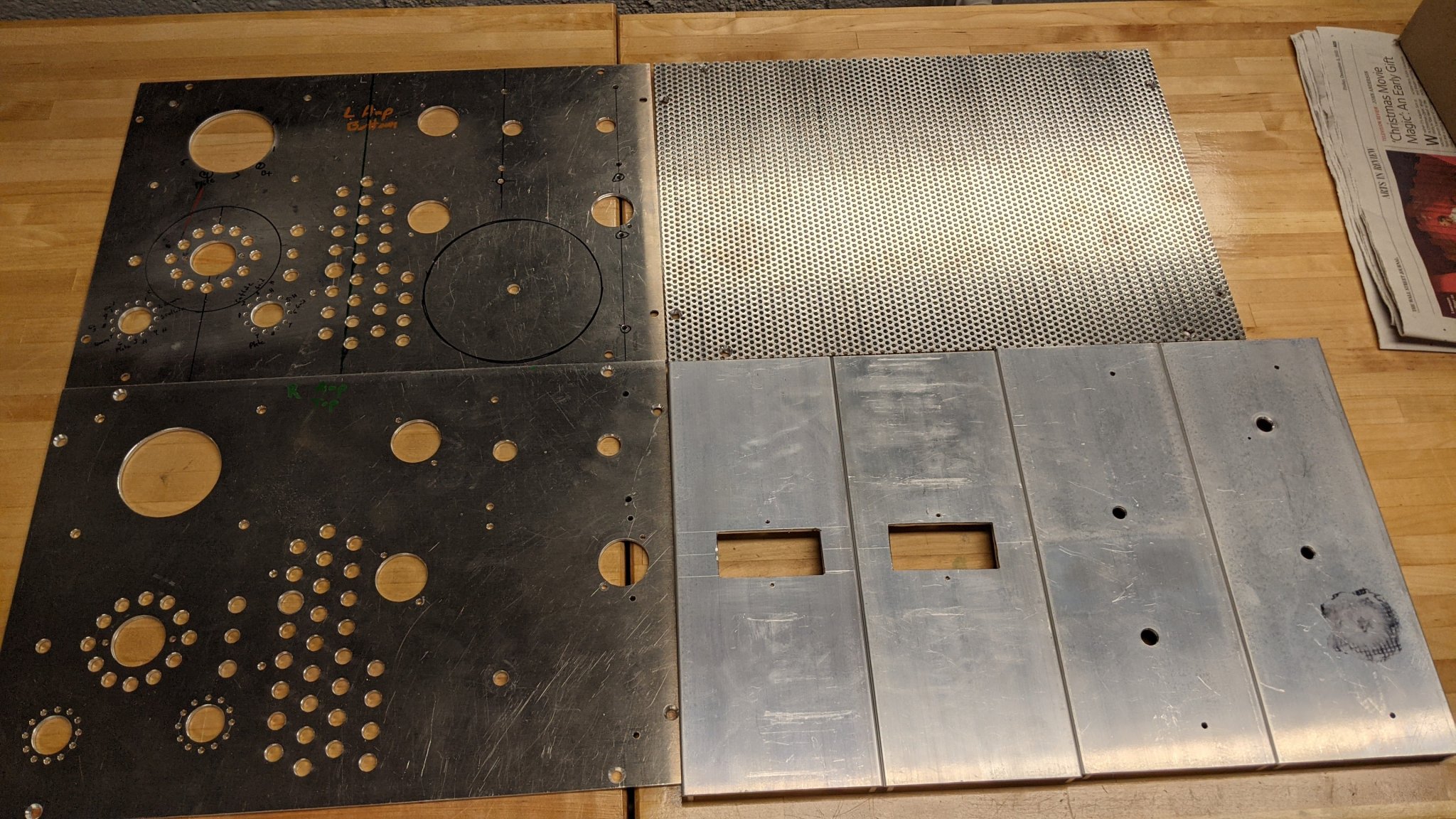

Nice work! I'm curious if you have had issues with building with aluminum vs. steel. I never built any tube gear on aluminum. Other people tell me not to bother with building on aluminum. What are your thoughts?.
There are some that say steel has problems such a eddy currents. There are equal numbers that say steel is preferable. Aluminum is so much easier to work with - for me. Unless you build the exact same on both chassis and compare, you'll never know.
Nice.
I've been thinking about switching to something different than steel plate on wood. Yea, eddy currents. I mount the transformers on the wood on the back.
Double sided copper PCB blanks makes an interesting box too, but only for something with like a separate power supply.
