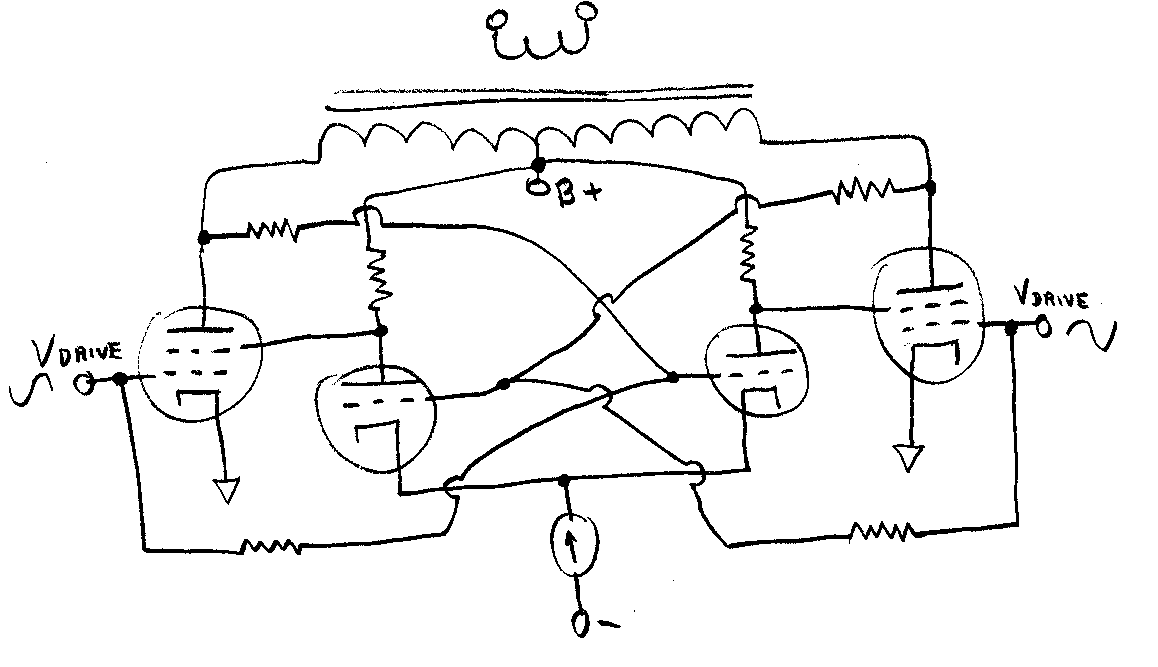

Andrewbee's link was an interesting read, but I see a couple of problems with the approach. First of all, the potential around a cylindrical object varies as 1/radius not linearly with radius. To get it really right would require a Finite Elements Electric field calculation program with a good physical model of the tube in question.
Secondly, if you do successfully arrange for the screen grid to always have the potential that would exist naturally between cathode and plate, then it effectively isn't there, so you have just ended up with a true triode in effect.
An interesting experiment would be to just take a variable resistive divider from the plate to cathode to drive a high volt. MosFet source follower controlling the screen grid. One could separate AC and DC ratios by using a cap and high value resistor to a screen bias supply. Then look at the distortion on a dist., or better yet, spectrum analyzer (M Audio 24 bit sound card, $150) while varying the ratios.
An economy test could be done by just using some variable power supplies for grid 1, screen and plate and a DVM. Set the tube up for a good bias point using a typical plate load resistor. Then adjust the G1 bias thru a range in small increments and see what variation of the screen supply is necessary to get linear plate voltage changes (with respect to G1 changes). Then plot the results. A bit labor intensive though.
One might even go further (out on a limb perhaps!) and arrange for an op. amp. and HV MosFet (drain connected to screen grid with a pullup resistor to B+) to control the screen grid voltage actively for minimum distortion. The op. amp would use a resistive voltage divider between the plate/cathode, and the G1 voltage as its inputs to compare (use inverting Op. Amp. configuration since G1 volts will be neg. and ratio'd plate voltage will be pos.), and its output would control the MosFet gate (make sure to get phases right or will oscullate, maybe will need a 50 KHz RC lowpass for stability).
If this works well enough, one might just use two of these circuits in a P-P amplifier and forget about the whole issue. (But you didn't hear ME say THAT!)

I should have put in some labels on the resistors. But, anyway, here's the intended mode of operation.
The plate (to LTP grid)attached resistor would be N times the value of the grid (to LTP grid) attached resistor, for an anticipated gain of N for plate swing versus input drive swing on the main grids.
If the pentode/tetrode is performing up to snuff at gain N, then the LTP grids remain stationary due to the currents thru the resistors cancelling, and the screen voltages stay the same.
If the plate is underperforming the gain of N, then the LTP grids get some signal and correct the screen voltages until the plate swings are nearly correct again. etc. (typical feedback loop)
Don

Those screens are an impractical load for that configuration, I think. Screens generally have to be driven by cathode/source/emitter followers.

I just thought of another neat little improvement. If the transformer has UL taps, then the plate resistors of the LTP plates could be taken up to them instead of B+. That way the LTP doesn't hardly have to do much to correct the screens to get the gain of N rule enforced, so should be more accurate. (with an effectively higher feedback gain in the LTP)
Well, I guess one would need to check the actual operation to see if the screen grids are being driven by the LTP close to the UL tap swings or not. If the LTP plate load resistors have near identical voltage swings on both ends, then they look like current source loads and the LTP would have higher gain available for feedback. Pentodes, rather than triodes, in the LTP might be better for gain too.
