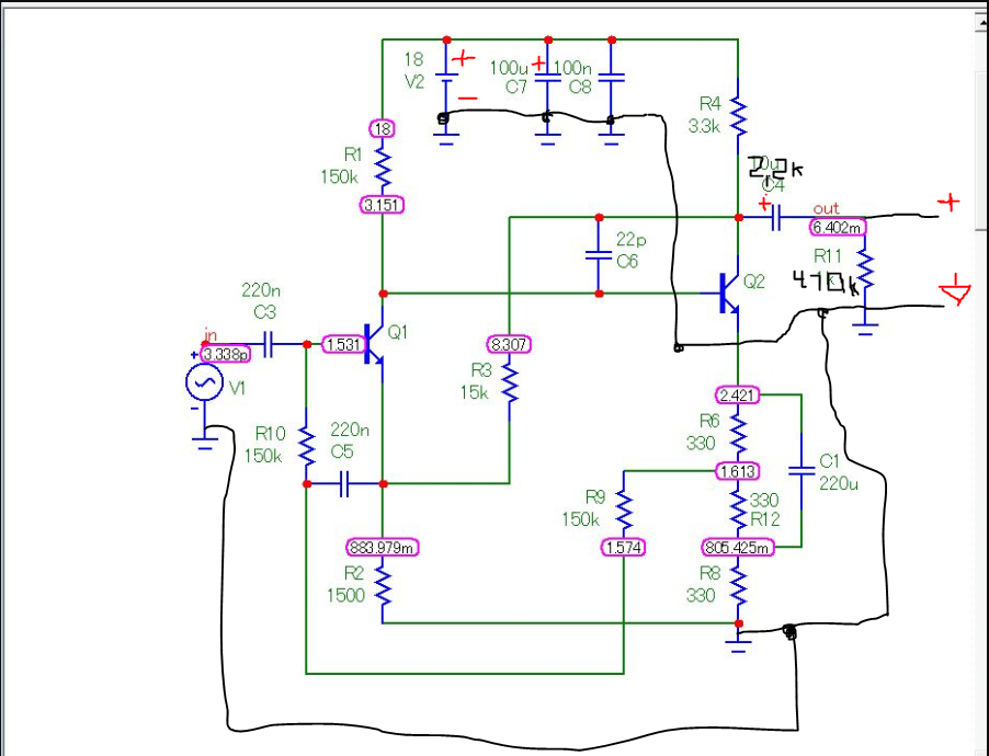

Thank you, it's hard to put theoretical knowledge into practice. will start building your recomended preamp circuit right now.
Additional question, wiring a volume pot infront of the input will basically function as a gain knob? And i could add mid scoop, trebble bleed circuit, in the same position as well? or should i install volume on input and the effects on the output?
There is no C2, but i assume it's replaced by V2 (the power supply).
C1 is 220uf, so should it be polar as well?
and last thing, you said " A 10uF 25 volt electrolytic should be all that is needed and it is placed across the supply to the preamp", so should i add that to the circuit, or is that replaced by C7 in the diagram?

The power supply is normally considered (assumed) to be good and so any decoupling is what we call 'local decoupling' and would normally be a small polar cap. If you want to keep C7 at 220uF then that covers it, it will work just fine.
Adding a volume control at the input doesn't alter the gain of the circuit as such, all it does is attenuate the level supplied to the preamp.
I wouldn't try and add any effects until after you have proved the amp works OK.

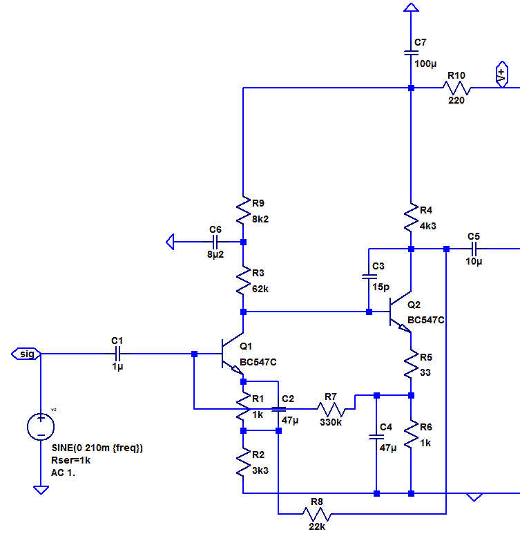

I would suggest a few things to improve the circuit's power supply rejection:
1. A resistor of maybe 100-220 ohms between the 18V power supply and the circuit, to form an RC filter with C1.
2. Splitting off maybe 10k from R1 and adding another 10µ or so capacitor to ground to form another RC.

I've built the circuit, and it's experiencing the same issues as the first version.
All of the voltages basically check out (8.6 instead of 8.3 on R3 is the biggest difference.
But the voltage at the output keeps jumping from 2.9 to 4.2, like it's oscilating between these voltages.
I used an smd electrolytic 2.2uf, 50V cap, and the voltage right before it is correct value, and stable. Maybe replacing this cap is the first thing to try, since the problem occurs right after it?
I will apply the recomended modifications, and will try to figure out the issue.
I used BC547C resistors, which i've seen used in multiple pre-amp circuits, although they're not technicaly transmitors made for audio use. Should i replace the with BC33725 (BC549 equivalent)? the unstable output voltage seems more important at this moment.

I can only imagine a bad layout resulting in either a ground loop problem or oscillation. [/url].
Your second recomendation, just so i understand correctly, is to add the resistor-capacitor-ground connection before, or after the R1?
I used 50V 10uf for C7, could that be an issue. And C1 is polar, i assume that's fine?
Could this be the issue:
I have my signal ground, connected to the ground on this circuit, should i leave it off?
The ground of the guitar pickup is already going to the DC ground wire. I believe i tried connecting only the signal on the last preamp build attempt, and the amp and preamp still had major disagreements. i don't want to ruin my amp with these tests.

Here is a similar circuit with both RCs implemented (based on the Sansui AU-5900 tone amp stage):Your second recomendation, just so i understand correctly, is to add the resistor-capacitor-ground connection before, or after the R1?
The stock circuit without them has OK PSRR (~55-60 dB), with them it becomes pretty much bombproof (>100 dB of input PSRR from about 50 Hz up).

You will not get around connecting both signal and ground to the input of your preamp. Its output signal and output ground go to the amp input. And your preamp's power supply ground better be floating, i.e. either batteries or an old-fashioned transformer power supply (nothing very big required, 3 VA would be plenty).
Given the partly high impedances, a conductive enclosure centrally connected to ground would be beneficial, even if it's just copper foil taped to a plastic case. (Al foil also works but is harder to make contact with.) It should get a direct connection only in one spot, but ~10 nF capacitors on other inputs and outputs may be beneficial to keep RF out (which is very much necessary, as the junction of a transistor at very low Ic - like the input transistor - is quite nonlinear indeed).
yes, my amp circuit has a + and - terminal, + recieves the output wire from the preamp, and - recieves the output ground from the preamp, or am i mistaken?
for the power supply wires, it's an 18V DC switching adaptor, with a white and bare wire. so + and -(ground). I thought the - connects to the ground of the circuit.
All the voltage values from the provided schematic match reality with the bare wire wired like this. but it therefore is also connected to signal ground. i was told to do this when building the first preamp, to connect the second wire from the power supply to signal ground. But so then the circuit has two ground connections, doesn't it? power supply ground, and signal ground, both connected.

I can't get a stable voltage reading right after the output cap. it should be 6.4m, but it jumps around between 5 and 3.2, it's easy to get a stable voltage reading at all the other points.
Connecting only the signal wire from amp to preamp caused regular high pitched popping, and connecting both signal and ground between amp and preamp circuits seems to be worse. i don't want to damage anything. i added an aditional decoupling capacitor before r1.
What could possibly be the issue, everything seems fine before the output caps. Should i just replace the transistors? Adding the recomended 220R resistor between the power supply and the circuit obviously changed all the voltage readings at all the points, so wouldn't that affect the paramters of the circuit? and that didn't give a stable voltage reading after the output cap either. i replaced the 2.2u with the 10u as the schematic originaly asked for, and that didn't change anything.

Nope. Ideally you'll use a 1/4" jack (either TS or TRS with T+R connected) so that you can use ordinary instrument cable. Flying leads are not exactly the very definition of good shielding. That goes for both sides, the input even more so.yes, my amp circuit has a + and - terminal, + recieves the output wire from the preamp, and - recieves the output ground from the preamp, or am i mistaken?

As indicated by the guy before me, you should be seeing just about no DC at all in this spot, and all the AC that your amplifier puts out. If the 5 and 3.2 indicated is in mV then your multimeter probably is reacting to a bit of AC. If it were in V then your output coupling cap would be accidentically reversed or defective - which would no doubt explain the racket.I can't get a stable voltage reading right after the output cap. it should be 6.4m, but it jumps around between 5 and 3.2, it's easy to get a stable voltage reading at all the other points.
