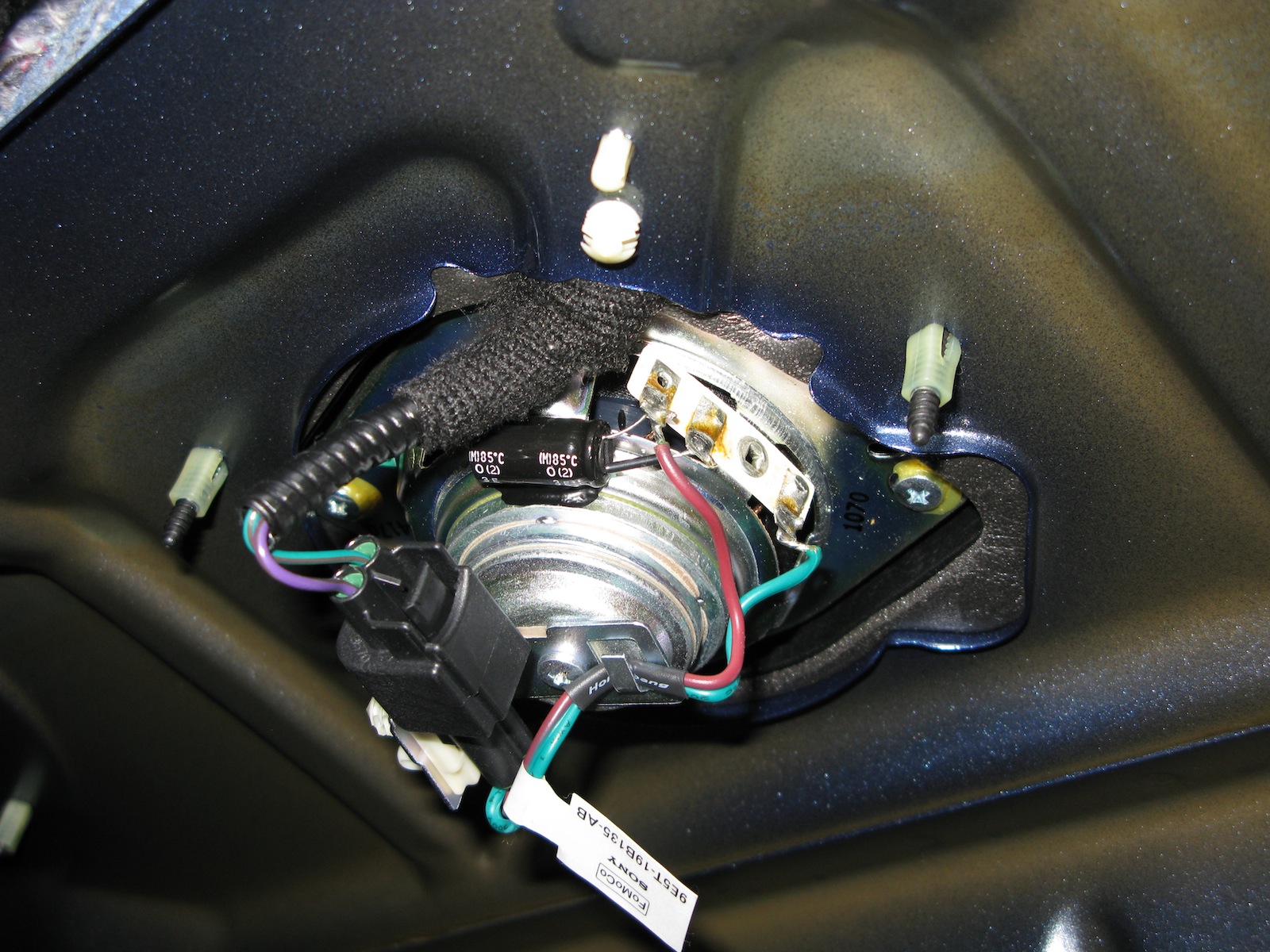

A while ago I was in the backseat of my car (2010 Ford Fusion), and I happened to notice the audio coming from the rear speaker sounded distorted in the midrange. I leaned Ford has a special speaker walk test mode that plays a sine wave through each individual speaker in the system (it’s sort of a 6.1 setup with 10 speakers), so tried it. Going around all the speakers sounded fine until it got to the rear center channel speaker (3.5"), which was noticeably quieter and strangely sounded more like a triangle wave than a sine wave. Investigating further, I found an electrolytic capacitor wired to the speaker in series (see pictures), which I understand is used as a high-pass filter to block bass frequencies. I initially couldn’t find the capacitance value on it, but looking at the end carefully the rating might be 68 µF (the tops of the numbers are cut off)? So I tested it and got 77.4 µF, which is about 14% high (not sure what the tolerance is). The resistance of the speaker was 6.9 Ω, which I thought was high for a car speaker. To rule out the amp, I grabbed an old 8 Ω bookshelf speaker that was known good and connected it to the harness side wires for the rear center speaker. I repeated the speaker walk test, and the sine wave sounded normal and was a little louder, so I believe the amplifier is working fine.

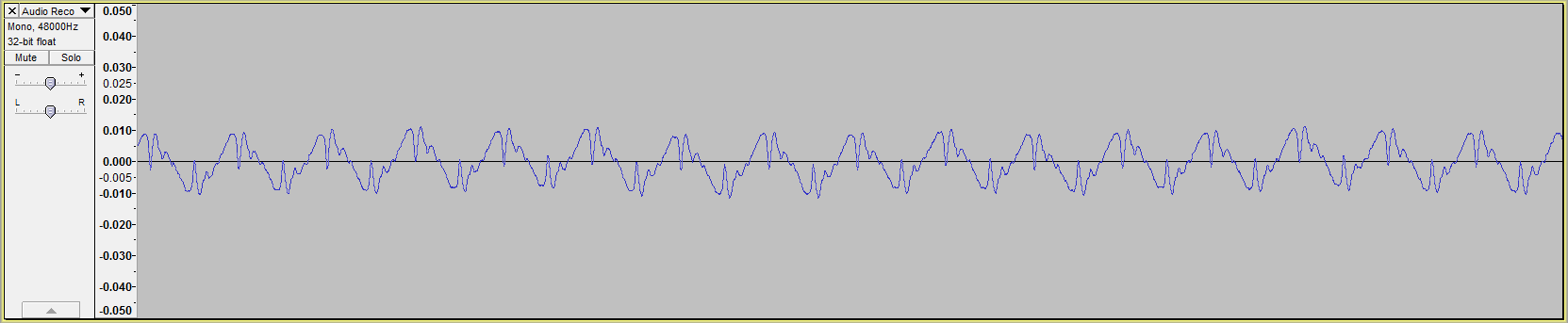

Now if you open up the audio files with a program like Audacity and zoom in on the waveforms, you can see some really strange harmonics going on in about the 200-3000 Hz range.
^ Yes, that's supposed to be a pure sine wave. 😕
So my question is, based on what you’re seeing and hearing, what is wrong with my speaker? Is it the speaker or the capacitor? Where are all those harmonics coming from? I should mention I tried bypassing the capacitor for one walk test and it still seemed to sound bad.

My shot in the dark guess would be an intermittent short either in the voice coil or perhaps in crossover components upsetting the amp chip. The chip going into protection could possibly cause that waveform. Replace the driver, then rip the old one apart to find out😀
Try another speaker to rule out the amp channel. If that speaker sounds good and your test shows no distortion then you know the original speaker is bad. If the 2nd speaker is also distorted the same way then you have an amp problem on that channel. You could also disconnect the speaker and look at the signal from the amp directly with a scope to see if it is a clean sine wave. You could also connect the speaker to another signal source generator and test it out of the system.

Well, I got the replacement speaker installed (only had to take out all the rear trim and seats to do it). The new speaker is electrically identical to the old one, but sounds normal. I even tried measuring the resistance of the old speaker while I pressed the cone in and out to check for any possible shorts and the reading was about the same (7.6 Ω) regardless of cone travel. Pushing the cone in and out yields a very slight noise (have to hold it <3" from my ear to hear), but I'm not sure if a tiny amount of noise is expected or not since I didn't want to push on the new speaker.
I haven't got to tearing it completely apart yet, but my favorite theory thus far is a loose voice coil that was creating unwanted harmonics. It might have been a manufacturing defect. If I ever get a setup for measuring impedance I'll have to test it.
