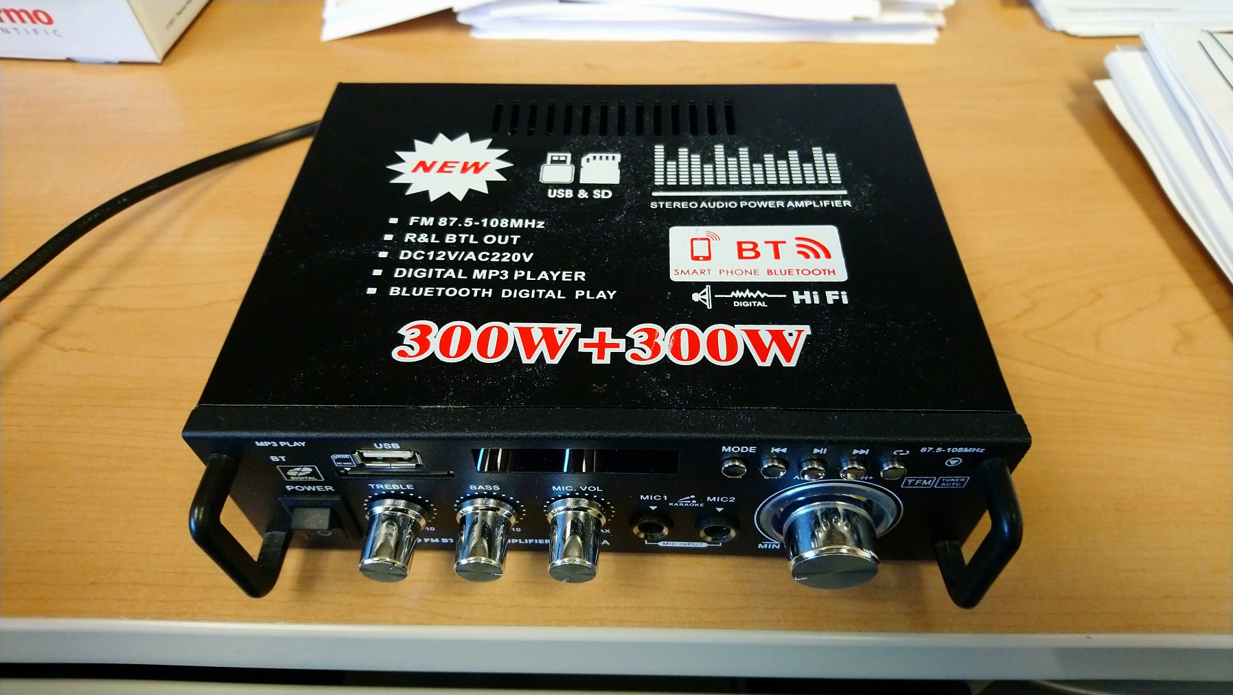

  • How do manufacturers get away with ridiculous claims? I will use any crap as a test amp but my latest acquisition takes the biscuit. A Samsung A/V amp claims to consume 75w.
When idle (not driven), 75W at mains' side seems okay.
Other readings are the max achievable output, probably only if that given channel is driven -> and nothing else of course.
The numbers, put together on a sheet of paper, under the specifications section, look impressive indeed, don't they... 🙂
In reality, this practice is very misleading/borderline criminal.
Do not buy anything from these manufacturers who indulge in such practices.

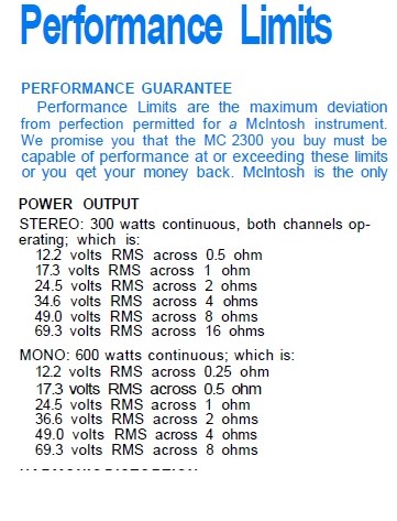

In the 1960's and into the 1970's, wattage ratings for serious equipment were mainly accurate.
For instance, McIntosh amps gave a clear explanation of their wattages - posted in their service manuals in charts stating loaded impedences and voltage levels - the honest ratings.
And these products DID put out the watts - conservatively rated, and beyond.
Come the 1990's and today - I've seen more and more bizzare ratings/claims show up.
A blatent 1000 watts from a 2 1/2 inch high box? - I tested that thing in the shop and it fell way short of even 100 watts!
Yet predominently written on its front was that "1000 watts" crap.
Somehow, corrupt marketing and obvious "standards" by the Institute of High Fidelity are ignored.
The below chart can be used today with any amp, any wattage.
These are "honest watts at various voltages/impedences.
Simple to use - if checking a "supposed" 100w amp @ 8 ohms, merely divide the voltage readings accordingly, etc.

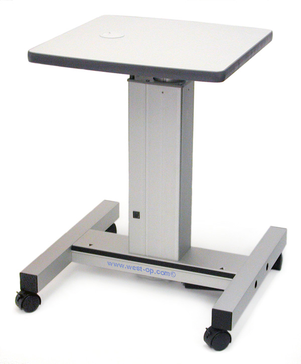

One handy thing I have in the shop is a roll-around table with a motor-driven elevation level.
I see they now sell for around $1,100.
