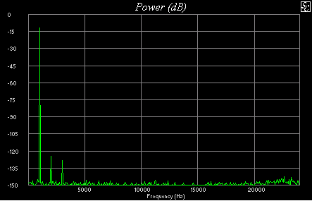

I myself use SampleChampion (what a name) from Purebits.com. The user interface can be better and it is somewhat buggy. But this doesn’t bother me much. It is a very powerful engine with loads of features (FFT up to 256k points). It uses MLS (maximum length sequence) techniques for response measurements although you can use sweeps too with some imagination. E-mail support is very good. Price is just under 300 EU and is definitely worth the money. With a Soundblaster Live1024, you can do already a lot if you stick to 48 kHz sampling rate. I am using a M-audio 24/96 soundcard and the the combo serves me very well. Attached is a screen capture of the distortion of the soundcard itself at 24bit/48kHz at –10dB full scale, input and output were connected directly. The picture is an averaging of 64 measurements. Without averaging the noise floor is about 20 dB higher.
