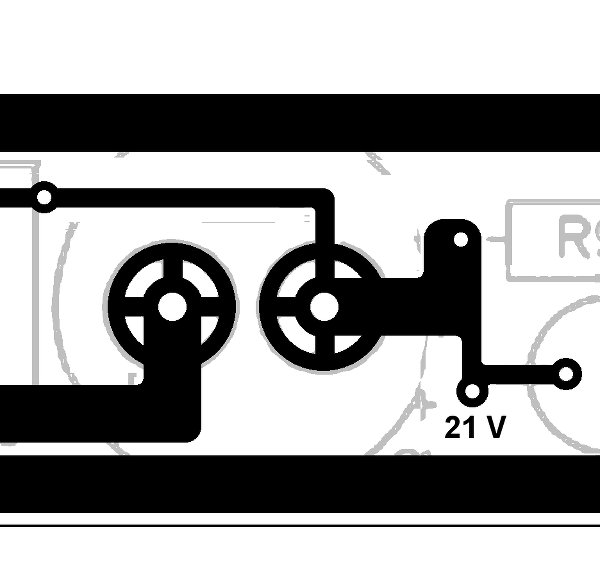

PCB designs often have an outer ring around a capacitor pad, with spokes connecting the ring to the pad (see attached image). What's the purpose of this?
Thermal relief for soldering and desoldering... Important when making a proper connection.

As an alternative theory, that pad symbol was used in old school PCB software to indicate mounting screws.

So *maybe* PCB designer wanted to indicate that screw mount capacitors may be used there.
What does that PCB snippet belong to?

While the thermals are harmless (if useless) in the posted example, I went over another of my designs which does have a ground plane and could no doubt use some thermals.
It's from Nelson Pass' F3. It's a pretty small cap (25mm diameter), so I don't think it's for screw-mount. (The FirstWatts are hand-soldered, but by-and-large don't have ground planes, so nothing suggestive one way or the other there.)
If you have ever tried to manually desolder the negative (can) terminal on an elco soldered to a ground plane you will appreciate the use of thermal reliefs.
Ok, I had no size scale reference, so it *might* have been a large cap, also saw it as "pretty large for a plain thermal relief", now knowing it´s a 25mm cap, those legs are barely 500 mils away, so each pad isn´t that large.
Personally I would have used a somewhat smaller but solid one but hey, to each his own 🙂
