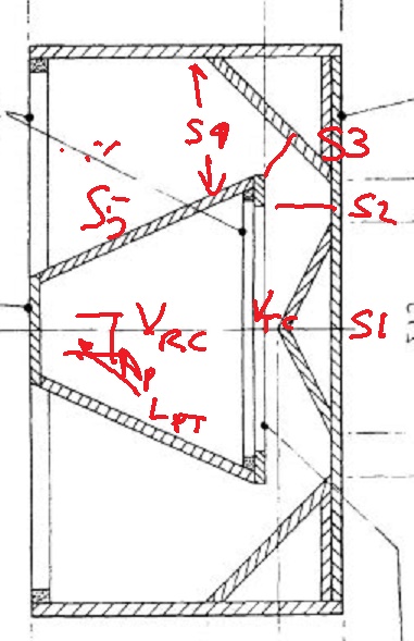

what's the proper hornresp input for this type W-bin?
- where the full cone area is facing a back panel splitter? I'm guessing the distance from the speaker baffle to the tip of the splitter to be 84mm and about the same for the top/bottom gap when the horn makes a turn.
Here's the way I'd probably approach it, though I would seek to optimize the design a little - the expansion at the back of the horn looks a bit wonky, and the reflectors in the corners likely pinch the horn a bit at that point. The pinch right at the throat of the horn can be replaced with solid cross-braces that are positioned to provide the required expansion there - I've seen that done with other W-bin designs, including the two that are still in use in my cousin's nightclub and it works fine and adds bracing where the horn needs it the most.
In fact, thinking about it a little, you might just be able to lower the resonant frequency of the horn a little by extending the depth of the horn a little and chambering the back section Cyclops-style.
I might put together a design spreadsheet for this if there's enough interest.

I'd try a simple model using this yellow line as the throat.

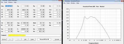

Freddi I've modelled the EV eliminator bin with an EVM 15L driver in hornresp. I can post the input screen later if you're interested.

Ok I've just checked the EV model I did and it seems I just worked out the horn length, mouth size and used the SD as throat area. I drew the box up in CAD so the figures should be near enough. The rear chamber was just over 19 litres and I allowed 3 litres for the driver.
Sorry it's not more accurate I was only trying to find out if it was worth building a pair as I have the drivers for them. (I thought they might go lower than my Edgar style 80hz horns)
Rob.
hey Rob - 14 liters would be too small for the stock back chamber - were you trying to flatten the passband and push system resonance upwards with a small chamber ? - oh - maybe it is that small - I'll have to look at the plan much closer
