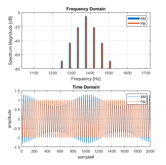

Just as a very brief and limited example, the good and well educated folks at Purifi have a couple of sound files that can be listened to with headphones. The interesting thing about the two files is that they measure exactly the same in standard measurements yet they sound quite different. https://purifi-audio.com/blog/tech-notes-1/doppler-distortion-vs-imd-7

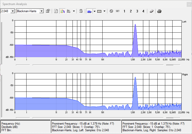

As I said earlier, there is no magic with audio. I downloaded both of the files (right-click the players then Save As), and the files do not "measure" the same. The FFT display in Sound Forge clearly shows the difference.
Try again?😛
What does it show, the files were checked before, then taken down and put back up?
Basically, each file should consist of 4 frequencies, with each frequency being at a fixed amplitude. The only difference between the files should be the phases of two of the frequencies. Perhaps choice of windowing is producing some artifacts?

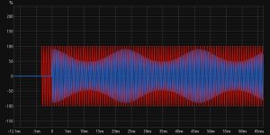

Impulse via REW sure shows a difference on downloaded files...(same as Purifi article shows)
Good, those do show up well in the time-domain view. But you would say most people are doing the same in terms of their standard measurements?For me, transfer function and impulse response are the standard base measurements.
No matter though, at least to some extent. There are things being missed by the overreliance on FFT power spectral density plots. A lot depends on acquisition settings, but even then some things just don't show well up in those very common standard measurements. Also, there can be considerable human error in interpreting results. Time-domain measurements don't fill in all the gaps either.

Here are the FFT screen caps for Pure AM and Pure FM, and these "standard measurements" clearly show a difference.The interesting thing about the two files is that they measure exactly the same in standard measurements yet they sound quite different. https://purifi-audio.com/blog/tech-notes-1/doppler-distortion-vs-imd-7
Doesn't look right at all. Should look like the spectrum shown in the article with a carrier and modulation sidebands (looks like your FFT bins are too wide to resolve the separate frequencies):Here are the FFT screen caps for Pure AM and Pure FM...
At over a 100 dB down. Where are you measuring. We have troble measuring electroinics with that kind of resolution.
