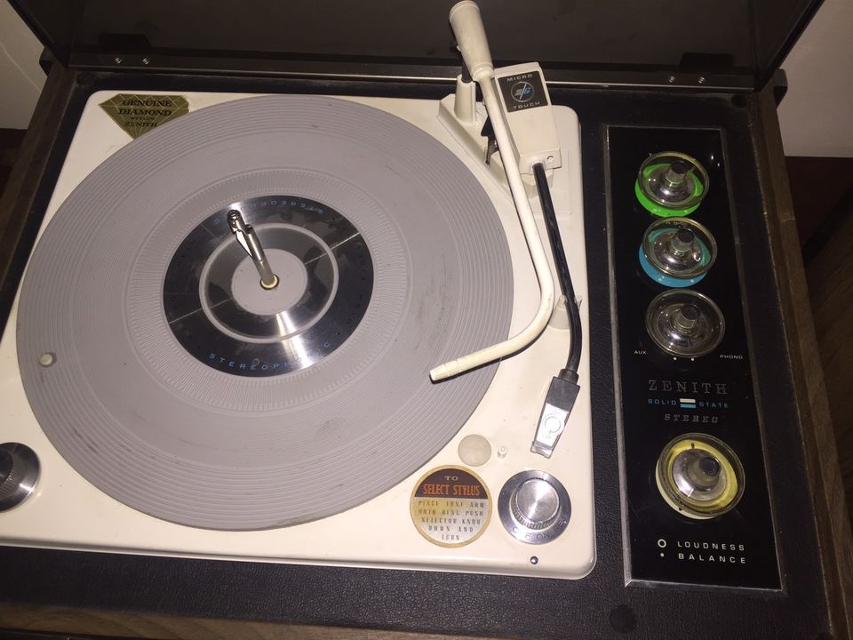

What's the most probable cause of this vintage TT problem?
I'm looking at buying a very cool and very retro Zenith record player and speaker system. I'm guessing it to be mid to late 60s to maybe early 70s. It's the kind with the cylindrical speakers with upwards facing full range drivers and the inverted hyperbolic cones above them to disperse the sound radially. It's so cool and retro looking, I really want to restore it and get it working again.
The guy selling it says the tonearm tends to auto-return all the time and doesn't stay on the record very long. What's the most likely cause(s) of that?
The thing apparently does play and makes sound but I expect to have to replace most of the caps and other components, etc. Might want to replace or re-foam the full range drivers as well. Not sure if the amplifier part is tube or solid state. I will go to look at it tonight.
There are probably damaged or worn out/ jammed mechanical linkages under the turntable , may just need some tlc and adjustment via a screw that sets the lift point .
nb this is just general advice and not specific to that model but they all worked along the same lines until optical sensors came along.

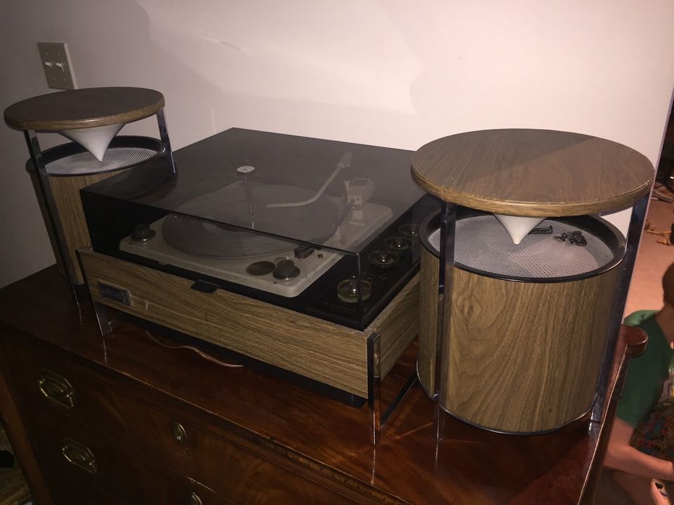

It's a Zenith Z565 Record Player with Circle of Sound speakers. Pictures are attached. I have some cool plans for this system which I will discuss in another thread.
I know people will say this system is not high quality and not worth doing anything with but I think it's so retro-cool that it's worth making upgrades and modifications to in order to make it as good as it can be. That may not be great from an audiophile's point of view but I'm hoping I can make it decent enough to listen to.
Stuff like this is so reminiscent of a bygone era and so undeniably retro-cool that it's worth preserving and making it useful again.

I have had a number of pairs of those speakers and have listened to them. Now you will find these looking the same from the outside, but i have seen them with different drivers. Th econcept is neat but even with the best drivers performance is mediocre. They are worth playing with, the turntable is, IMHO, best sent to the metal recycling. The amp is probably SS and as cheap as they could manage.

The turntable is a garden variety VM, with a "floating ceramic cartridge" that's supposed to track at around 2 grams. It does, but not very well. As I recall, the amplifier actually uses germanium output transistors. My college roommate had one of these, and it was pretty terrible.

The Speakers do look cool, and the general concept of "saving" it from the scrap heap is admirable. I have many pieces that are just on shelves as nostalgia ornaments. If I saw that at Goodwill I certainly would have dropped 10 bucks for it .... But beyond that ...
With some tweaking and possibly new drivers the speakers could be listenable, if placed correctly ..... and connected to a decent amp and source.

For turntables, that table will NEVER sound very good no mater how much modification is done to it. So get a Pro-Ject table and do a Plinth-Ectomy, and fit the Pro-ject into that Zenith box and use just the Zenith box and dust cover just ... as a box and a dust cover that matches the speakers.
