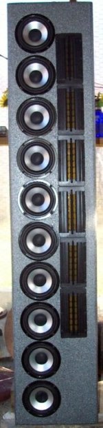

Nice experiment, but the enclosure is going to be tall. Taller then 34".
If the box is going to be ported the tall box will act as a tube creating standing waves which will screw up the port resonances. In essence it'll be a hybrid transmission line - bass reflex.
My experience with line arrays has taught me to build them in seperate boxes. My first array started out to be ported. I could never get the port tuned right. I then added baffles to load the drivers and break up the standing waves and I still couldn't tune the port. I went sealed and loved it. It still had bass and more then I expected.
The line arrays I'm building now 'are' in seperate boxes. 3 of them to be exact. The 3 will be glued together and an outer cover of finished plywood and 1/2" MDF will cover the seams and add a constrained layer to the box to help stop box resonances. Making them sound dead.
You could also add a shelf half way in your box thus making two seperate enclosures. 2 ported boxes will be easier to tune then one tall one.
Have you checked out Dual Chambered Reflex Boxes???

Thanks guys. You all are amazing. 🙂 You've not only answered my questions, you've touched upon some of my unspoken fears and doubts.
First of all, I'm glad that the equivalent driver parameters thing has been sorted out. Thanks for confirming that I'm on the right track.
Now for my thoughts and plans. I'm playing with this driver from Peerless India.
(This driver is quite interesting even to non-Indians, incidentally, because a modded version of this has apparently been supplied under OEM order to GR Research and is sold in the North America as their famous M130. The key diffference between what I'm getting here and what the M130 gives, as far as I can see, is the Fs.) I'm getting an Fs of 80Hz, much higher than I'd like.
The published parameters are tallying well with my SW-measured values. The Vas that I got after my quick-and-dirty added-mass measurement is about 4.8L. (I'll do a sealed-box measurement later.)
So, for a vented box of 5L per driver, I'm getting a manageable 30L total internal volume, but that's too little bass (F3 of box at 58Hz or so). Using Unibox and moving to something like 15L per driver, I can drive down the F3 to about 44Hz, which, together with a down-firing port and ground coupling, will probably give me adequate bass. (Remember, I'm new to all this, I could be wrong... so please shout loudly if you think I am.)
Therefore, at a total volume of 90L, plus lots of bracing, I'm looking at a box which is tall and slim from the front but will probably extend more than two feet at the back. So it won't be a slim and sexy column any more, except from on-axis. 😀 And then comes the problem of vent diameter. With an equivalent driver diameter of something like 15", I don't think I should use just a 2" vent. So I wanted to build a 4" or 6" vent, and that makes the duct quite long.
I had toyed with the idea of doing one chamber per driver, maybe with each having its own slim little ducted port. What should I do? Regarding the TL behaviour of my big box, I don't think that danger is very serious. This is because at 90L, I'm not going to get a tall slim box... I'll probably go for a large box with narrow front baffle but with a sloping back, extending to a base which might be two feet long. In other words, the shape of my enclosure may be more like a triangle than a column. See the Aksonic speaker's design to get an idea:
except that my box will probably extend at the back much more.
Therefore, I'm now wondering whether I should go in for one large down-firing port in one big triangular box, or whether I should make multiple chambers, each with its own vent. (With the multiple-vent approach, I lose the ability to have a down-firing port to enhance bass via ground effect.)
What do you think?

Here are the parameters and the output from Unibox, when I tried modelling it as an "equivalent driver". The parameters of each driver were: Fs=80Hz, Vas=5.3L, Qes=0.63, Qms=2.53, Le=0.292mH, Re=5.8Ohm, and Sd=95 cm2.
By calculating the equivalent parameters for my line-array of six, I got the following and put them in Unibox, telling it that this is a single-driver design:
Then, by playing around with the box model, I'm getting this set of values:
What do you think? The box size is huge, but I may be able to build it as a tall box with a slim front baffle and a lot of extension towards the back. Will it work as a vented box?
BTW, what's "flush end" for a port in Unibox? I thought the opposite of flared was flush. But if that's true, how come Unibox gives me the option of "no flush end"? It'll either be flush or flared, so what's this "no flush end"? Is there a third type of port end?

It depends, as long as the tweeter is at ear level it's ok. If you make the line of woofers longer, you'll get more SPL with the same power imput. It will also be high WOW factor. I would consider using a tweeter with sensivity higher if you go with the longer line just to make the crossover easier.

Got it. I guess then in my case, I'll put the tweeter at the top of the array, given that my entire array will fit in 36" height or thereabouts. Thanks. 🙂It depends, as long as the tweeter is at ear level it's ok. If you make the line of woofers longer, you'll get more SPL with the same power imput. It will also be high WOW factor.

About 36 inches high? Yeah better stay with top of the line. It's because some people do 84+ inches high line arrays so if you use a single tweeter you put it in the center of the line.
