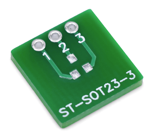

sc-59 (SOT-346) steady hand

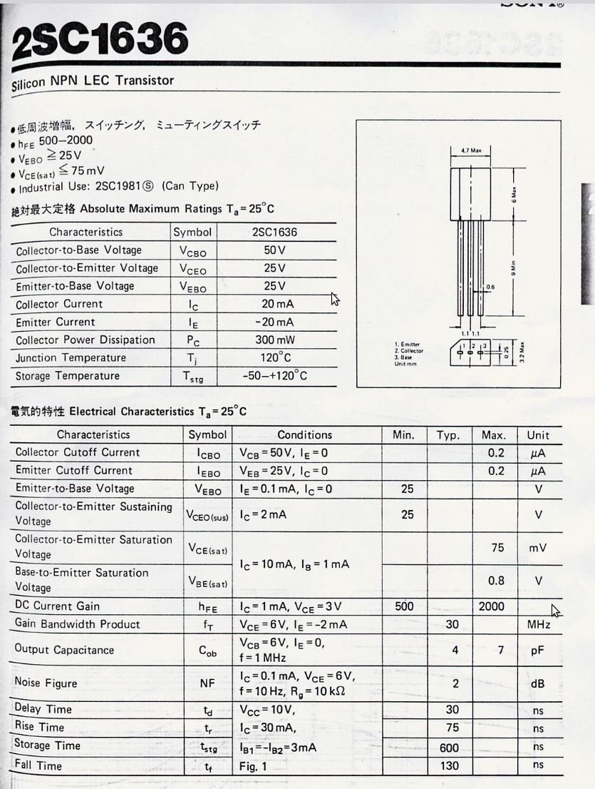

I also didn't know about these "muting" transistors. As I see in the datasheet of the 2SC2878 it has a very high Vebo at 25V. The 2N3904 only has 6V
Also, is Hfe important here? 2SC2878A is in the 200 - 700 range and 2SC2878B is in the 350 - 1200 range

hFE should not be an issue for the normal transistors but the 2SC's are unusual in that they are symmetrical at low operating voltage meaning collector and emitter can be reversed and it will still work as a transistor.

A regular transistor like the 3904 cannot replace a dedicated muting transistor: it has a considerable offset voltage and is completely asymmetrical.
You would need a much lower base drive resistor, and even so it will still leak some signal, distorted if the drive isn't strong enough.
The series diode is required to avoid parasitic conduction in the off state.
