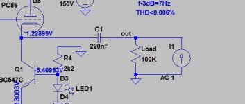

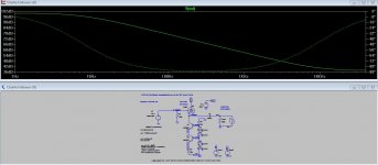

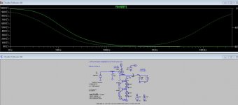

Whats the best way to show output impedance with LTSpice?

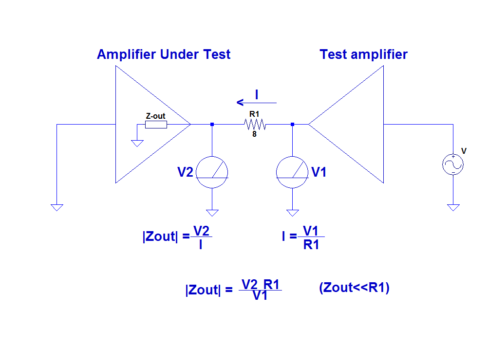

Work backwards from (a) the sensitivity of your AC millivoltmeter (could be an Oscope); and (b) the maximum undistorted power output of the test amplifier.
To get a feeling for the numbers involved, how many millivolts will be registered on the AC millivoltmeter, when you use a test amplifier that pumps {let's just suppose} 15 Watts RMS into the test circuit. Assume the amplifier-under-test has an output impedance of 0.1 ohms, when you perform your calculations.
Thanks for the diagram, about what kind of voltages do we inject? 2.83vrms at 1kHz ok?
It depends mainly at what current level you want to do the measurement: a good amplifier should have little difference between high/low currents, but if the OP stage has crossover issues for example, it could manifest itself by a larger impedance at low level.
I= V1/R1, and you can determine V1 from the input voltage, based on the gain, just as Mark said.
If Zout is too large compared to R1, and you don't want to make a differential measurement, an obvious fix is to make R1 larger.
If you stick to the differential measurement, but you only have a scope available, you can use its subtract function to measure the differential voltage between V1 and V2: it will be vectorially correct too (provided the channels and probes are reasonably well matched)

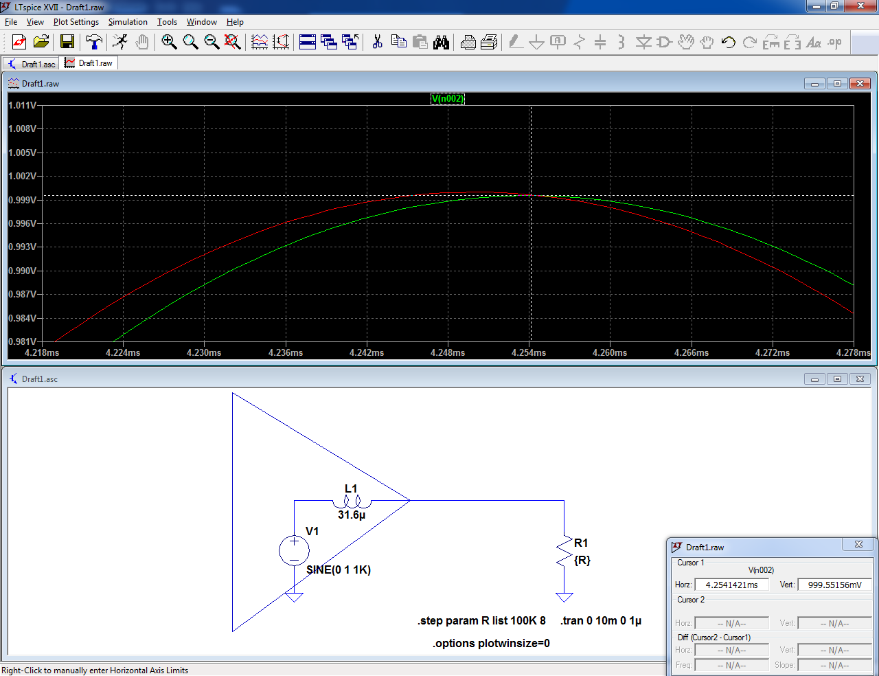

I put it to you that most Zout figures are really taken at one frequency, like THD.
I never said anything else, and I do not say you have to make a frequency sweep, I just pointed out that depending on the frequency, different effects might kick in, resulting in a reactive impedance.
Even if the reactive effects are negligible, the loading method has another weakness: the accuracy.
For a 8Ω amp having a damping factor of 100, the output impedance will be 0.08Ω, meaning that for 10V open-circuit, you will measure 9.99V loaded.
What is going to be the reliability and accuracy of the value obtained that way?
It is an extremely useful tool, as is Mark's technique taken directly from the simulation.
It will generally yield extremely optimistic results, which could explain its popularity....
You can make it as accurate if you wish by using 8R and 6R, for example, and at any desired frequency and measured with a rms DMM. You can even include your 31.6uH inductor if you wish.
RMS measurements are not required, and the value of the inductor can only be accounted for if you have some means of determining it, meaning using the proper method.
It is a rule of thumb which is very helpful during bench testing........ and that is what it was intended. X mentions 2.83Vrms, 8Vpp, that is a useful output to benchmark.
As I said, making a correct measurement is not difficult at all, and does not require special equipment, except a test amplifier, which will generally be available for free since most of the amplifiers are stereo (at least)

Regrettably there are physical components connected in series between the amplifier's output node and the speaker binding post on the chassis exterior. They are significant contributors to the magnitude of the output impedance, at frequencies below 1.1 kHz.
One more thing: I showed the A.U.T. + test amplifier setup in the context of |Zout| measurement, but it would be a pity to use it for just that miserable purpose: it can do a lot more.
The first interesting thing to do is to examine the residue present on the A.U.T.'s output: ideally, it should be sinusoidal (if the stimulus also is, obviously) but in fact it will generally not be perfect, because it concentrates all the current-related errors and distortions of the AUT, to the exclusion of others (typically voltage-related ones).
It is easy to test the voltage-linearity aspect of an amplifier: just remove the load.
However, using conventional testing, voltage and current cannot easily be disentangled.
With this type of test, you can see the effect of current practically in isolation, which is very useful, not only in reality but also in sim.
When an amplifier has a sub-ppm THD level, simply measuring it is already a challenge; attributing it is even more difficult.
The setup acts not only as a discriminator, but also as a concentrator: the amplitude is perhaps 100x smaller than in regular conditions, but the absolute level of current-induced distortions remains the same, which considerably eases measurements.
Applications do not stop there: you can also look at the way the amplifier reacts to maintain its output node at ~0V when subjected to a high perturbation current.
You can examine each critical node, VAS output, VAS input, etc and extract useful information based on the amplitude, phase and shape of the signal.
In short, it is a goldmine of information for a keen designer.
