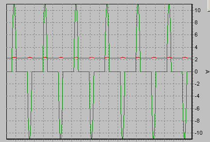

Suppose the power supply is drawing 240 Watts. That's an average of two amps (and I will be lame by ignoring the difference between average and rms...). So that's a peak of 20 amps!? Is that number real? I would like to hear from haldor.
OK, so what's the resistance of four contacts and 12 feet of 18 guage. 1 ohm? 0.5 ohm? Let's say it's 0.5 ohm, then at the peak current of 20A we lose 10 Volts across the transformer primary. That seems to mean an additional 8% of sag under load than what the transformer is already causing!

I'm not sure I agree with the the peak current draw of 20 amps. Assume you have a resistive load drawing 240 watts from a 120 VAC, 60 Hz line voltage. This will draw 2 amps RMS which results in a peak current draw of 2.83 amp (at the top of the waveform).
The amplifier John referred to will only output it's rated 240 Watts during a short transient, otherwise our speakers would burst into flames and we would all go instantly deaf. Most of the time our amps aren't putting out much more than a watt or two (unless you work in a disco).
If your amp was putting out 240 Watts continously then you would expect to see significantly more than the 2.83 amps peak current dependant on the cap charging duty cycle. If you WAG (wild assed guess) a 30% charging duty cycle then this would result in about 8.5 amp peak current. We will need to actually measure some real amps to see how good that figure turns out to be in real life.

Hi Phil, agreed, if the current waveform is a sinewave. But if I understand correctly the power supply does not draw current from the line in a sinewave, but only when the capacitors are charging.
Here's a shot from the duncanamps PSUD program. The red line is the load current, the green line is the current in the transformer secondary. It would be interesting to know how the waveform looks by the time it gets back to the line cord.
JohnR

Oh, sorry Phil, I guess I should have read your whole post before replying!
