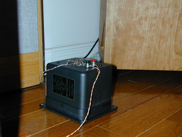

I like outside the box. Since this is a DIY forum, I'm assuming tweaking and trying different configurations is part of the game and you can't beat this configuration for making it easy. I'm using Altec 604's and I'm finding there are countless opinions on how to do a crossover for these - I'm sure I'll go through several designs & component options before I find the one I want to live with long term - I'll then mount it in a pretty box, maybe sand loaded, and leave it beside the speakers. I really don't think there is an issue with a few more feet of speaker wire, at least in the low power SET world I'm in.
On the mechanical/vibration interference thing, I don't know how much this really applies to a passive crossover in a speaker box, but I was amazed at how tapping on some capacitors in a recently completed DIY tube amp could be heard through the speakers. Maybe just tube microphonics but who knows - keeping passive parts out of the giant resonator box just seems like a good idea.

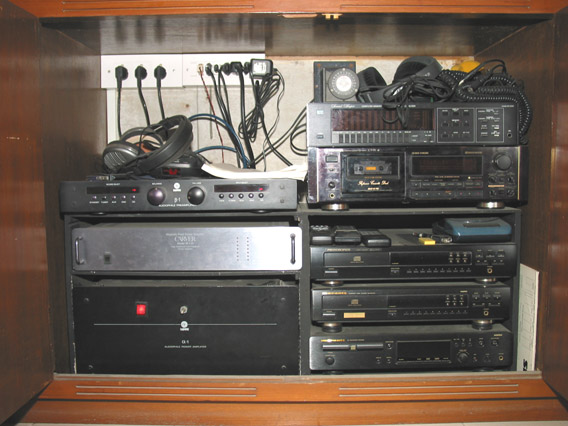

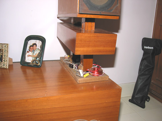

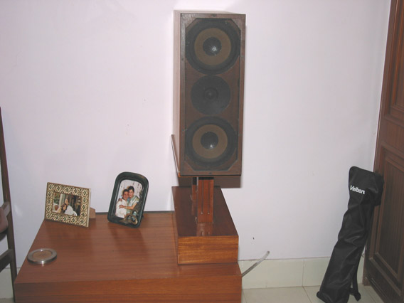

when the doors open....the amps are fan cooled once the temp gets to 55deg C and there are 2 vents that you guys cant see in the photos one from below the electronics cabinet and one behind...this keeps everything discreete but the main speakers. the subs face rear so all one sees are 2 boxes (each 30"Wx24"Dx18"H).
