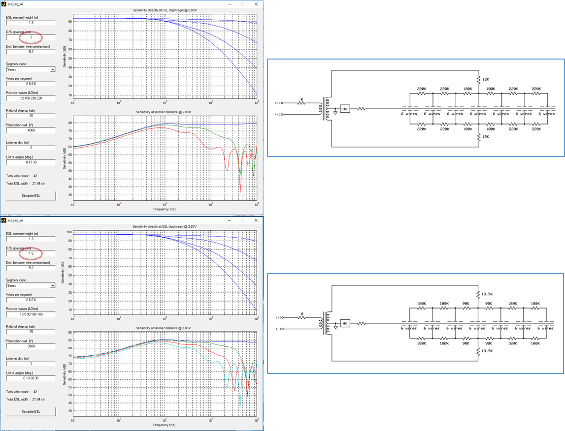

thank tou very much, my amplifier is near 50 watts....do you think it's too low for a 1:100 transformer? I already have a subwoofer up to 120 - 150 hertz so I would be happy if the esl goes down to that frequency
<<Moving response from another thread here, since it is specific to the panel you are building.>>
Since you are working on a hybrid, you can pick up even more sensitivity be reducing the air-gap to the more common 1.5mm size and setting bias voltage to 3.5kV – 4.0kV. I was actually working up this example as a good starting point for you when I saw you had posted yours. Attached are schematics and response for both.
Yes, I think for 42 wires what you have is a very good starting point for a hybrid ESL. As CharlieM did, you will likely not need to use the 12K resistor for the center segment. Instead, set them to 0 ohm and adjust the value of the nominally 1 ohm damping resistor on the primary side of the transformer for flat high frequency response. Since your step-up transformer only has a ratio of 75:1 and you show a 2mm air-gap, you can pick up some more sensitivity by increasing the bias voltage a bit above the recommended 4kV to something like 5kV – 5.5kV.played with the spreadsheet and esl_seg_ui in this week this configuration with seven segments (42 wires) seem to be interesting (with normal commercial resistors values...) it's a good starting?
