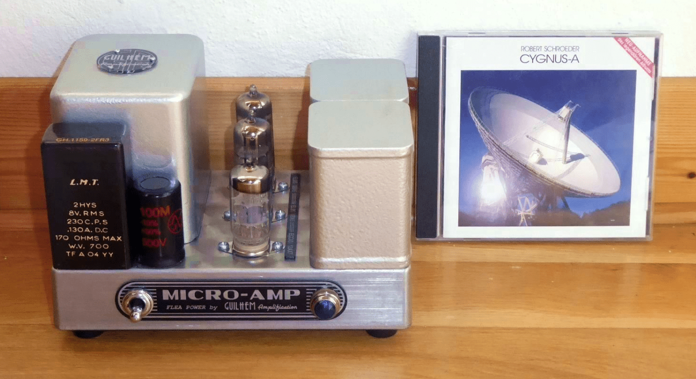

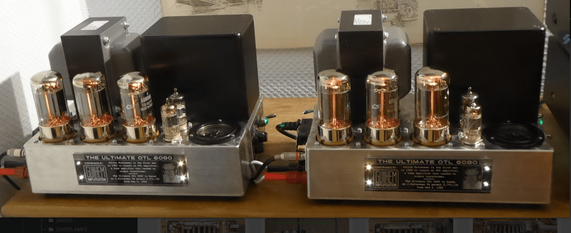

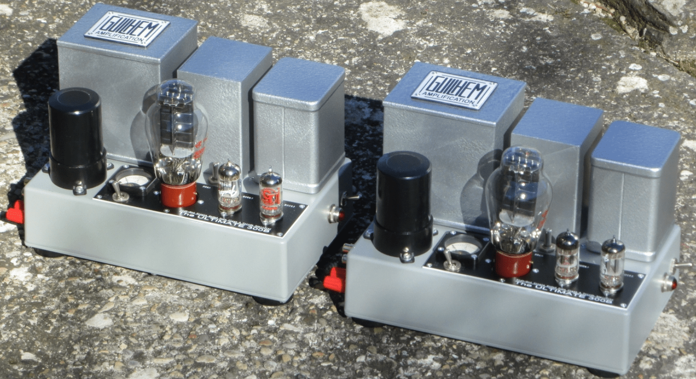

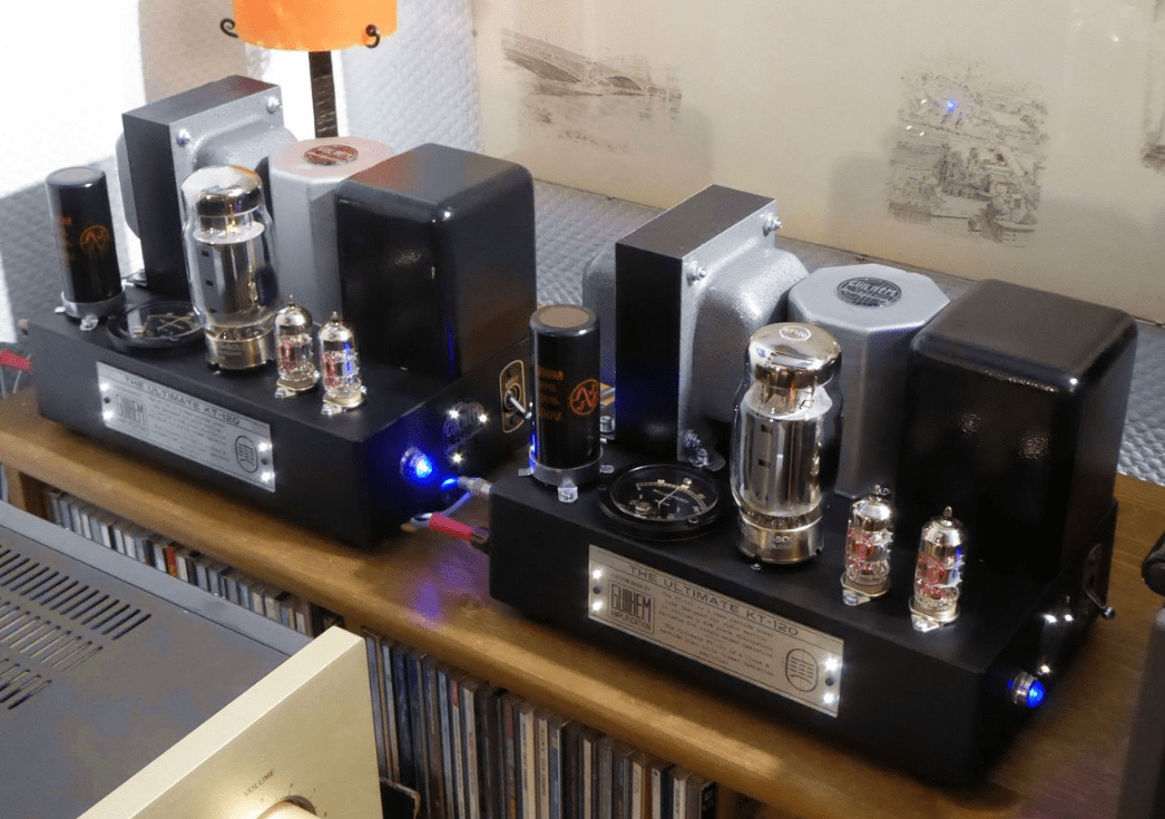

Considering your list, @6A3sUMMER, here are my matching items - more or less :
single ended :
single ended parafeed = 🤔 🙁 ⁉️
push pull :
OTL :
All with . . .
no negative feedback = U-300B, U-OTL
local negative feedback and global negative feedback = U-KT120, The MICRO-AMP
nested negative feedback = Audio Research D76
