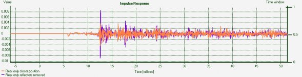

I've attached some impulse responses to show the difference between forward firing and reverberant field elements, plus the effect of using reflectors to deal with specific wall reflections.
The first shows the energy from the reverb elements with and without some reflectors added to tame the earliest hard reflections. Orange is with the reflectors in place. The blue poking out is the reflections with the specific reflectors removed. Note that the direct energy (not shown here) is starting at the 0ms point.

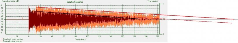

The second curve is a reverberant decay (log level vs. time) and shows the relative energy of the direct field chain (brown) and the later reverberant field chain (orange). There is about 15dB difference between the two over time although the greater initial energy in the direct response means that they are both about the same steady state level.
Also note that the rate of decay (the room RT) is not effected whether driven by the wide dispersing rear elements or the fairly directional front element.
Due to the slop it's hard to see, but interpolation + translation does suggest that the RT would be slightly larger for the dispersing element.
i'm not seeing that as the lines look fairly parallel. For my experiments my real concern is the separation rather than room RT.

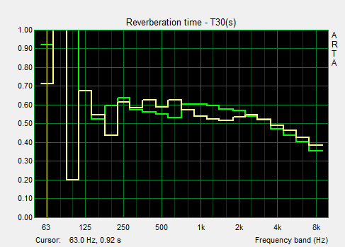

I do not think this is correct. Attached is the RT measured in the same room, with the same speaker (CD with high DI), just the speaker in a different location. There are already some clear differences just by this change in location. I will try to make another with a more wide directivity speaker, and see what I get...
Thanks for thr RT curves. They are very interesting.
I'm sure you realize that the considerable differences below 250 Hz are the modal nature of your room and that speaker placement is making the difference. Reverb time is only properly applied to a diffuse space and the commonly defined Schroeder frequency lets you calculate over what frequency range RT is appropriate.
Above the Schroeder frequency you are seeing differences of a little more than 10%. this is fairly typical.
