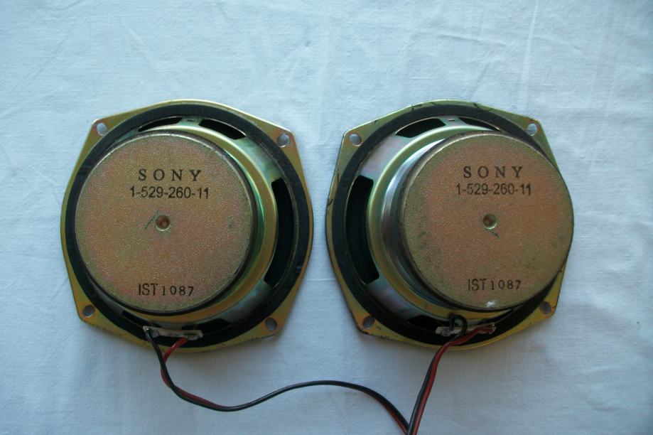

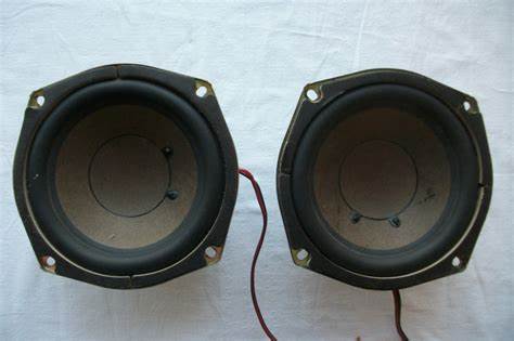

Hey guys!
I have a 5" 'subwoofer'. (SS-SW115 or SONY 1-529-260-11)
Here are the parameters:
Impedance: 6 ohm
Power handling :70/140 W (RMS/Max)
Freq: 50Hz-4 500Hz
Intesnsity(SPL): 89 dB (1W/1m)
I don't have any more because its a Sony speaker...
I'm trying to make a copy of JBL partybox 110 🙂
What would be the average box volume? I know its not that easy to answer, but a rough value would be good....
Maybe a rough port size?
Also can I somehow import this speaker to WINisd? If yes, how?
thx 🙂

Without knowledge of the Thiele/Small parameters, I can only make an estimate of the volume of a sealed box to suit a 5" woofer.
That estimate would be around 0.25 cu ft (around 7 litre). Not quite JBL Party Box 110 size I'll admit! 🙂
