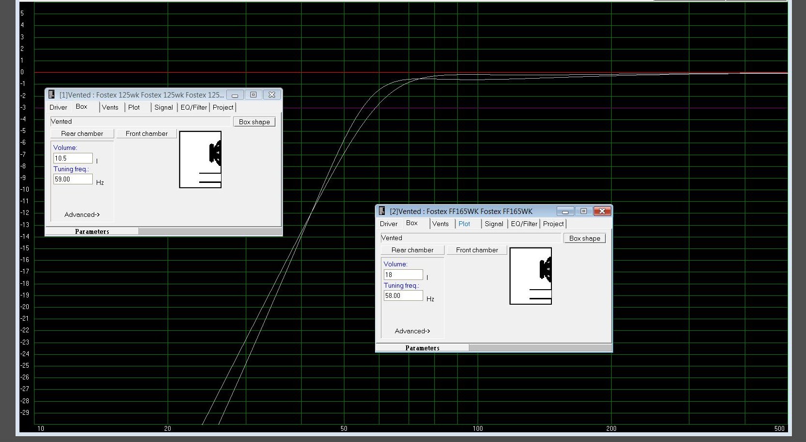

They perform nicely in approximately 1 cubic foot ported, although a stuffed port box can go smaller, down to 0.7 cubic foot.FYI Neat! Dayton Audio RS180-8 7" Reference Woofer 295-355 Daniel, what size box are you using? I think I would add thin layer of RTV 118 silicon on the cones.

I got a Pyle 4 ohm 6.5" white plastic woofer teamed up with a 4mh coil and some caps in a 0.5 cubic foot sealed box. Atop this went a paper cone 3" which was a bit more efficient in practice and allowed some treble contouring to boost the airy treble. This speaker was the new winner in the smallest size box yet still a realistic speaker. The efficiency is nowhere close to the RS180 and could not belt out the super low bass loud like the RS180 can do.

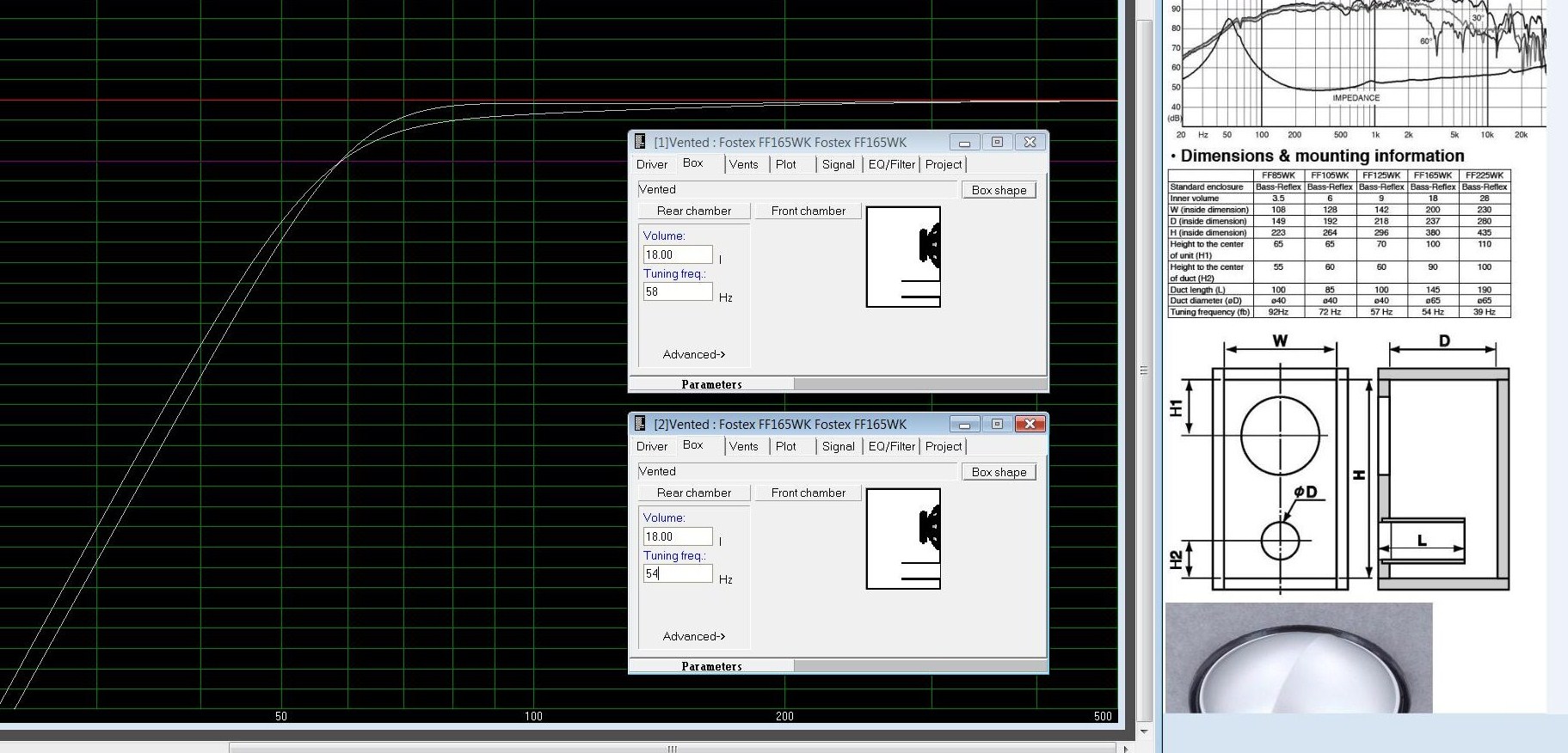

"could try a larger woofer in a W box" (this time a woofer without the peak)
E.G. 6.5" driver
The driver should be intended for a BR design, i.e. Qts 3.5 - .4 range.

Simmed the TangBang W3 in BR boxes; couldn't get anything but wippy curves.
