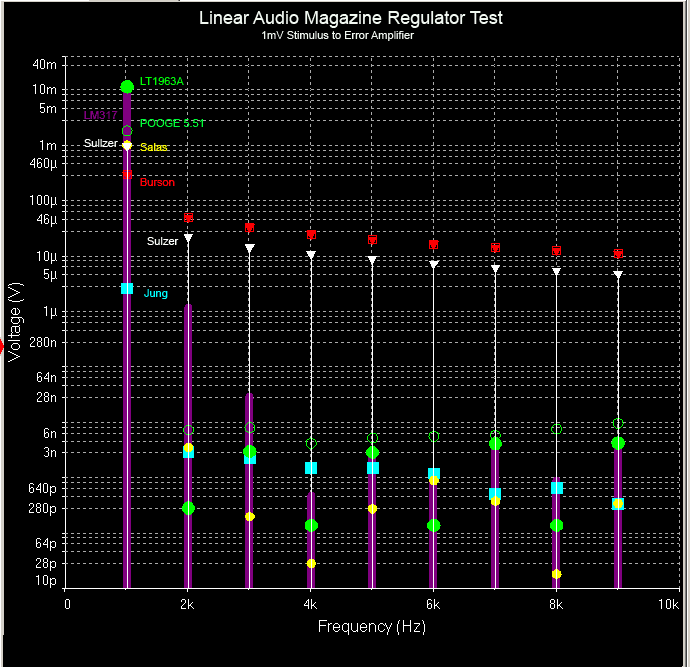

Pick your continent and you've already experiencing 50/60Hz and 100/120Hz on the rails...but there are other nasties which do impair the quality of sound. One of those is the distortion that a regulator error amplifier can inject onto a preamplifier. This was pointed out by a correspondent to the LinearAudio article commenting upon the article comparing various regulator topologies. I did as suggested and le voila, the LM317 (which rated poorly) did have a THD component when a 1kHz signal was injected into the error amplifier.

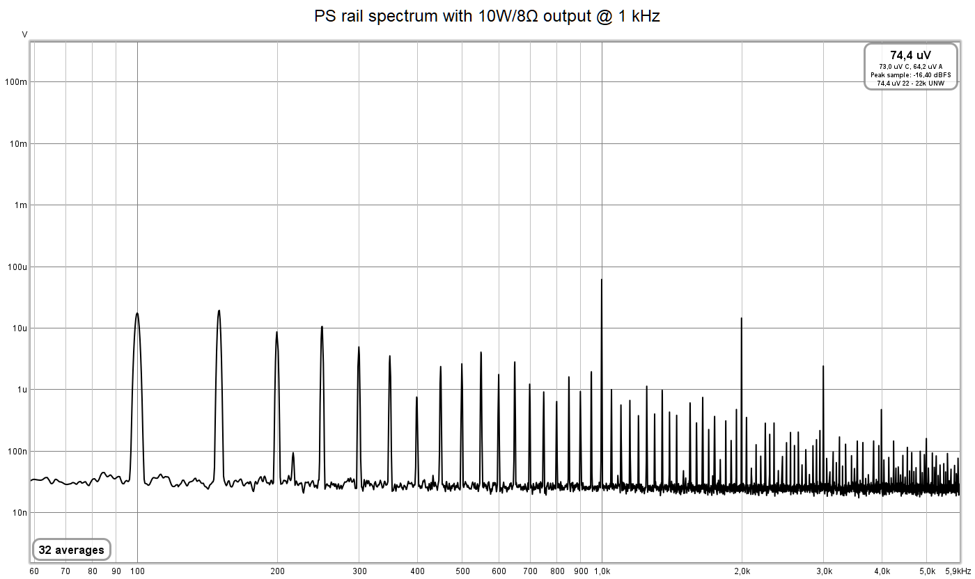

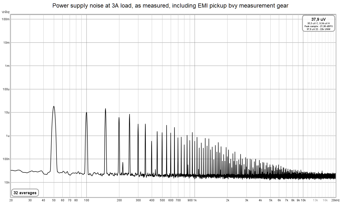

Well, on my PS rails is either low noise or harmonics under load from amplifier. Beside rails noise and harmonics under load, we should measure transient response with square wave load.
Rail harmonics here are consequence of amplifier pulling power for 1 kHz output signal, not obtained by injecting signal to voltage regulator's error amplifier.
