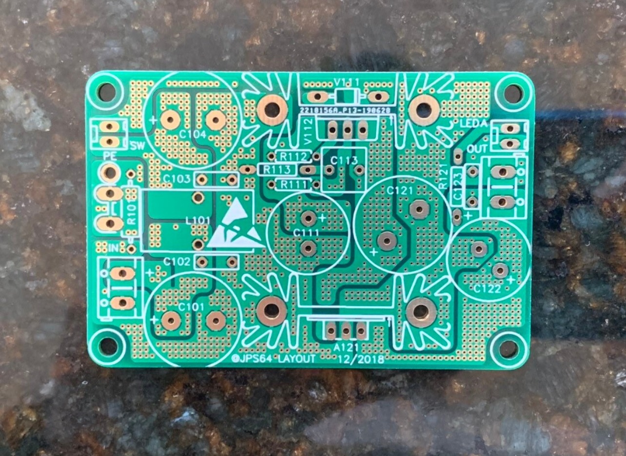

How about a small regulator to go from 15V AC secondaries to 12V dc for use with a BTSB in an amp?
If you use a trafo just add a bridge (or two 1N400X diodes for half wave bridge) plus 2200uF smoothing cap. You can use the first cap of the CLC as your smoothing cap, so really all you need is a pair of diodes to rectify the AC from trafo to this board. Feed that to this board which has a CLC filter followed by MOSFET cap Mx which gives a slow soft start ramp of about 15 seconds followed by TO220 78xx format regulator at A121. You can use one of those fancy TI TPS7A4xx regs for 4uV rms. Or plain 7812. If you don’t need cap Mx, just bypass it with a jumper on pins 2-3 on V112. The CLC filter is also optional. These are really handy for sub 1A circuits needing clean single rail supply.

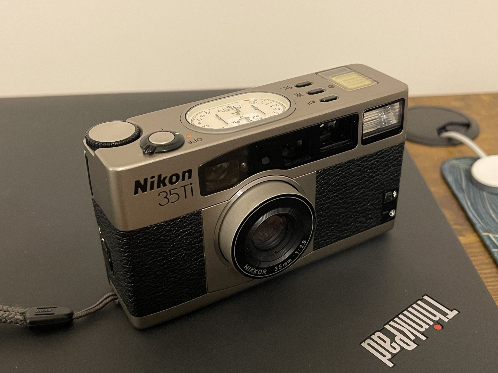

On the bench is one of my favorite cameras of all time. My wife got me this for my birthday 25 years ago. Too bad we don’t shoot in film anymore because this 35mm f/2.8 lens is one of the sharpest Nikon has ever made and it has a. buttery smooth color rendition and the out of focus bokeh was unique. It has a between the lens leaf shutter so can do flash sync at all speeds. Matrix meter was always spot on. It might be fun to put a roll in it and go photo shooting for a day.
Beautiful camera! It deserves a nice spot in a display case.

Yes, that's a great camera - just put a film into it.On the bench is one of my favorite cameras of all time. My wife got me this for my birthday 25 years ago. Too bad we don’t shoot in film anymore because this 35mm f/2.8 lens is one of the sharpest Nikon has ever made and it has a. buttery smooth color rendition and the out of focus bokeh was unique. It has a between the lens leaf shutter so can do flash sync at all speeds. Matrix meter was always spot on. It might be fun to put a roll in it and go photo shooting for a day.View attachment 1261875
I use film cameras (and digital ones too), from 6x7 cm (Mamiya 7II), through 6x6 (Yashica Mat 124G) to 24x36mm (Leica M7) and it's so much fun!
You have some nice cameras Plott! The M7 was always sort of unobtanium, like an AMG SLR or something like that. I have a very old Bronica S2A (6x6) in all stainless steel. The mechanical shutter still works, amazingly, and an old Nikon FE. I will go and get some film! My local drugstore still processes film but only as drop off (not 1 hr).

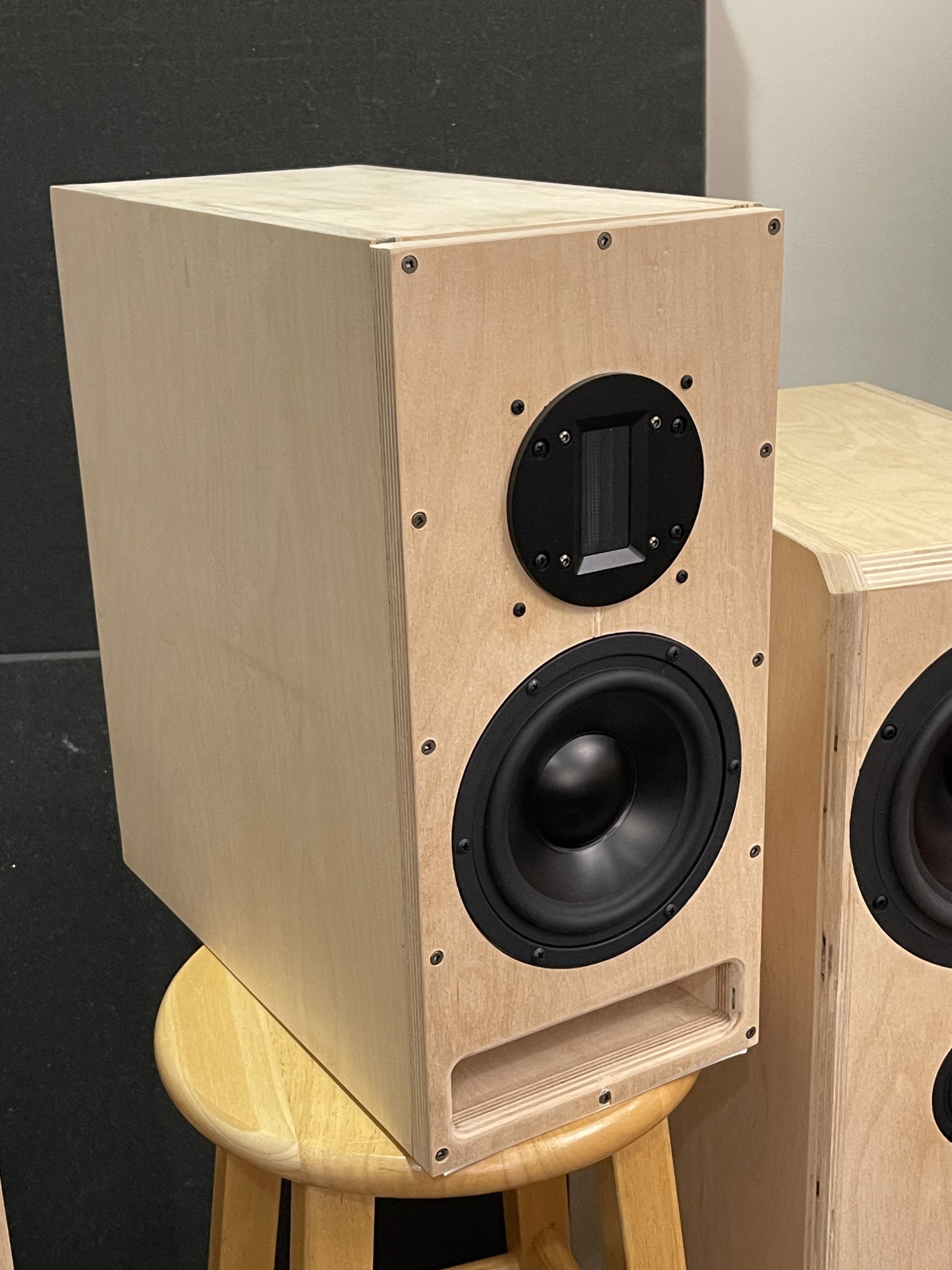

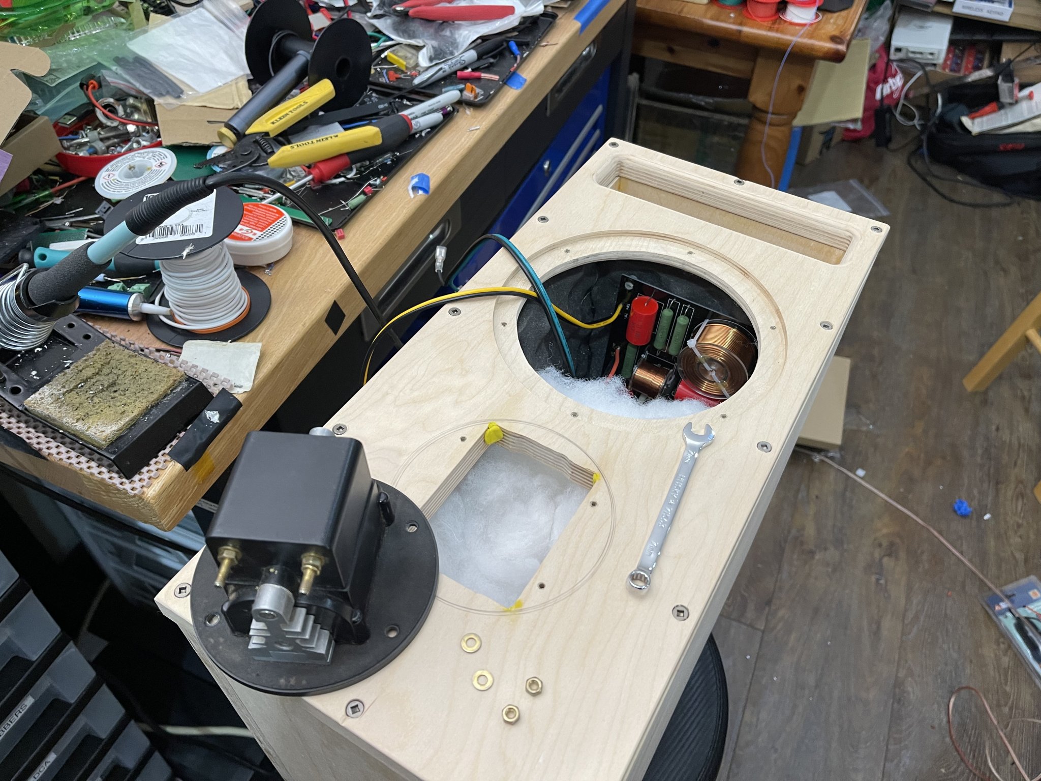

On the bench tonight, I am reviving the TL cabinet I designed for the Purifi woofer but now using with the Dan Wiggins aluminum cone woofer with XBL motor and a ribbon tweeter (both drivers are custom OEM). The woofer is known for its linear BL and high Xmax of 10mm.
New drivers are breaking in but initial sound is very nice. Ribbon has superb top end air without any fatigue. Midrange of aluminum woofer is great. TL bass is awesome - surprising how the TL adapted to this woofer so well. Also, bezel rebate, cutout diameter and screw holes are all a perfect fit compared to Purifi 6.5in.

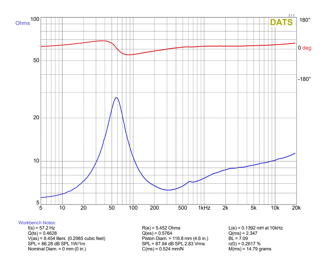

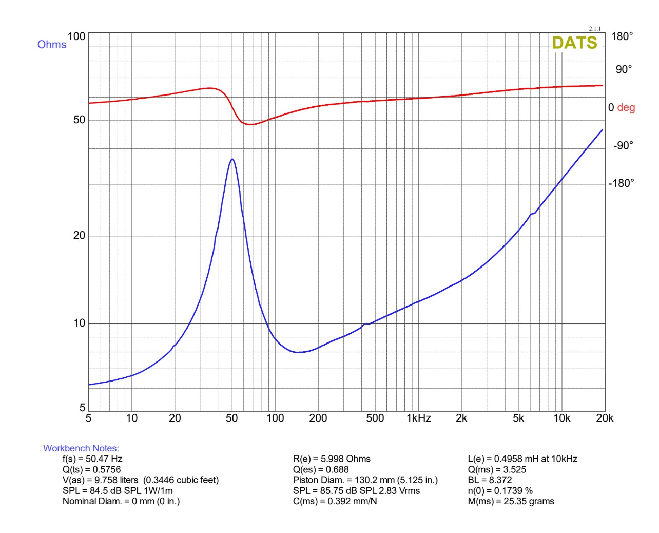

Here’s the DATS measurement of the woofer:

There seems to be minor issue at 600Hz. Perhaps detailed off axis or better watterfall would reveal what is going on there.
Let me redo the DATS on these new drivers. The one above is from an older used one that has a small dent on the cone.

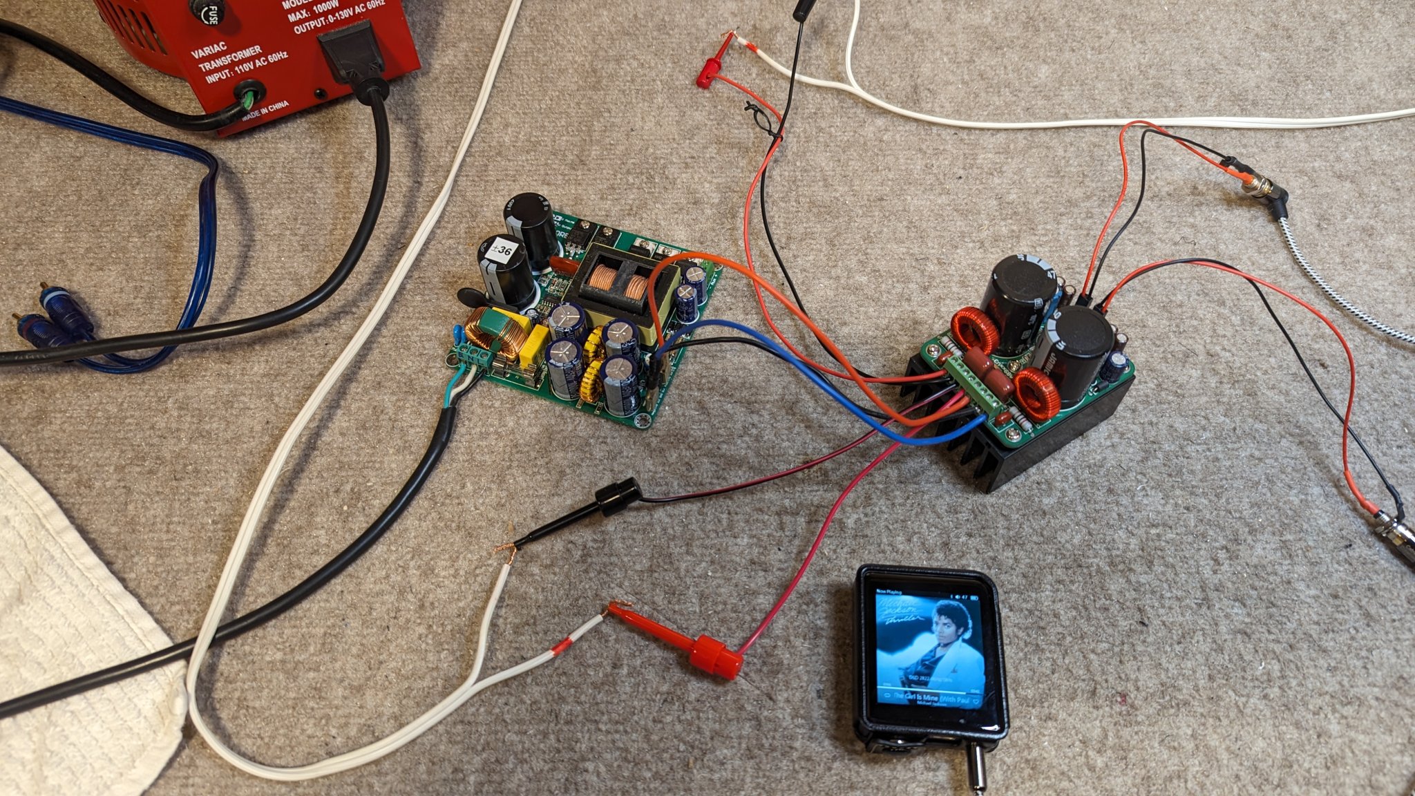

On the bench I'm testing my next project. It's going to be a companion amp for my newest streamer. It's based on the TDA8950 chipamp module I've had knocking around for several years. Testing using a +-36VDC supply. This should supply me about 75-80W conservatively using 8Ohm speakers. These are both commercial DIY products, so I didn't expect any bright flashes, sparks, or smoke - and didn't get any. 👍 The sound is pretty good if not excellent from my little shop speakers. Using a little portable DAP as the source. Thought I'd let it run a bit and see if any issues develop.
@redjr Nice. I have not heard of TDA8950 before. Is it Class AB?

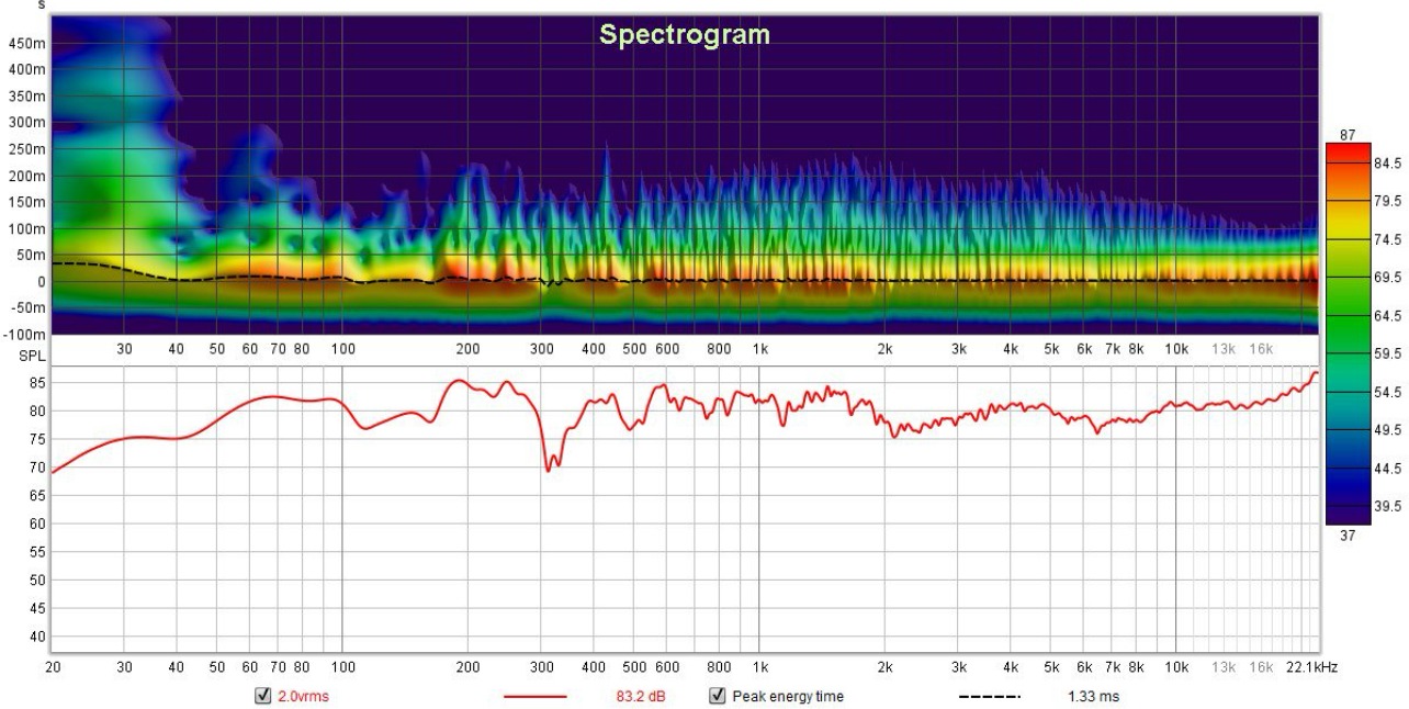

@adason - I took another DATS of a new woofer and it has less of a blip at 600Hz but something there. However, I don’t see anything anaomalous in the Freq response.
You can listen to the speaker here. Sorry about the stupid loud laptop fan noise. I forget that I need to cut CPU speed to 50% before doing stuff that requires silence or the fan is running all the time.
Not seeing anything particularly long lived in the Fourier spectrogram at 600Hz either.

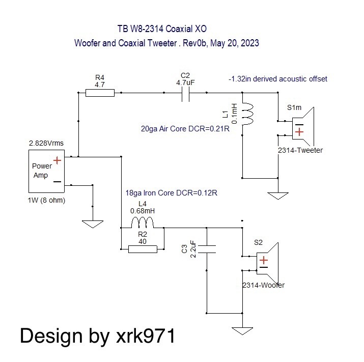

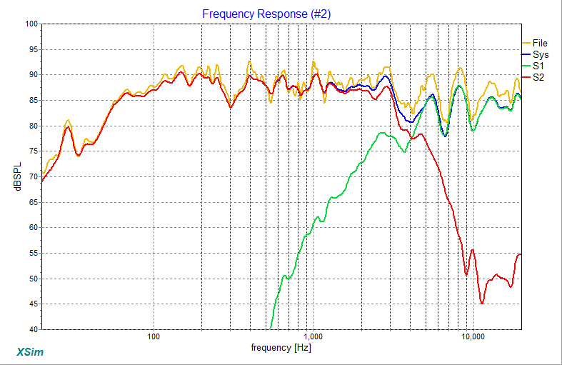

Hi @xrk971 and @Vunce , I'm looking for a new driver and came across your project with the W8-2314. Especially Vunce, but of course the others too: Do you have any long-term listening experience with this driver, especially how the somewhat jagged upper range affects it, as this cannot be completely smoothed out even with the XO. Or is it just there but not audible?

The W8-2145 is a nice driver if you can find it. I personally, would love to have one.

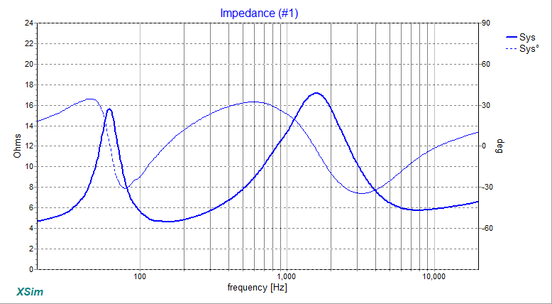

The crossover that I developed for it seems to sound very good. A refresher here for those who may not have seen the post in the 10F/RS225 FAST thread.
Our ears can’t hear dips very well. As long as the peaks are at about the average level, it should sound ok.

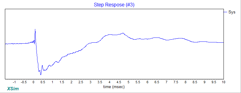

Microphone response is inverted (step should be positive rising edge)

Hi X, many thanks, it helps.
I would use it in an OB with woofer support, so I have to change the xo (I mean I have to build a completely new one).
Maybe you can use the XO because it is at 4kHz. The baffle width has more to do with bass extension. The crossover region is more controlled by the coaxial cone itself and to a lesser degree, the baffle width.
4kHz implies that the 1/2 wave cancellation distance needs to be at least 4.3cm from the driver edge to the baffle edge. I don’t think you have a problem there on your OB.
Thanks X, I will try it/start with it for shure, and the upper range could work without changes.
But I have to take care of the impedance and spl with the woofer, because the sensitivity of this driver is lower that that of the woofer.
