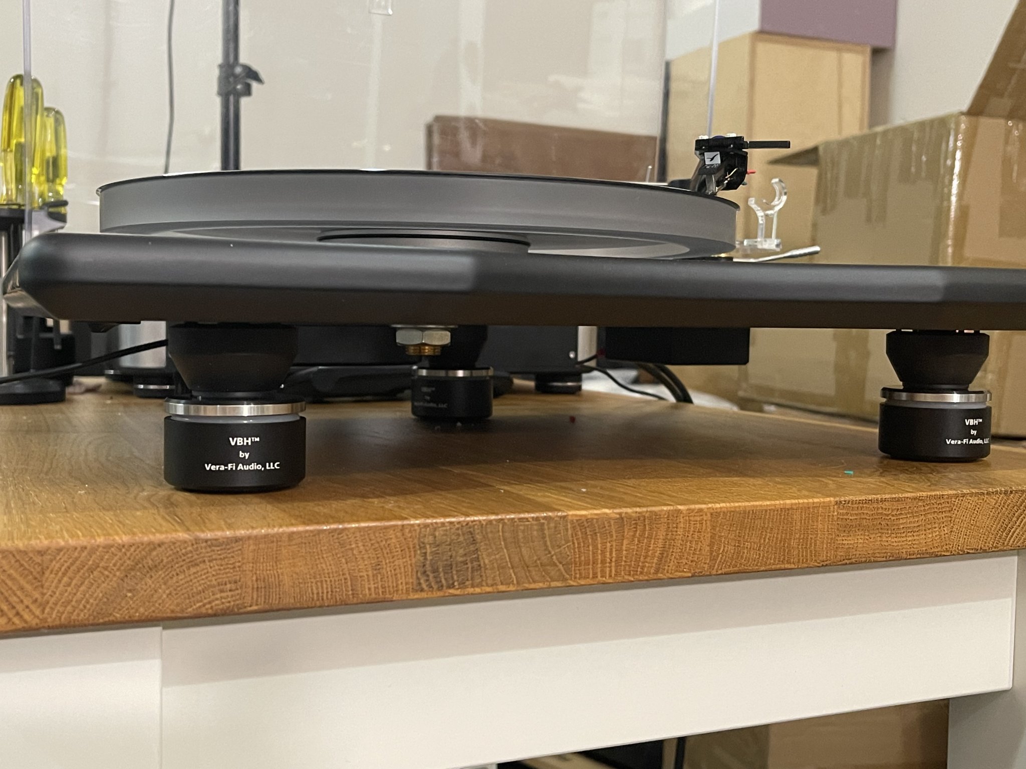

I just received some spikes that can be installed on whatever equipment you need to isolate from vibrations. The spikes come with 3M double sided tape to stick to the bottom of your piece of gear. The spike tips rest into the conical depression of the black nylon “black hole” on top. Testing how the spike feet work on my laptop (not that the laptop needs it - but it felt surprisingly nice to type on - seems quieter with key clicks).

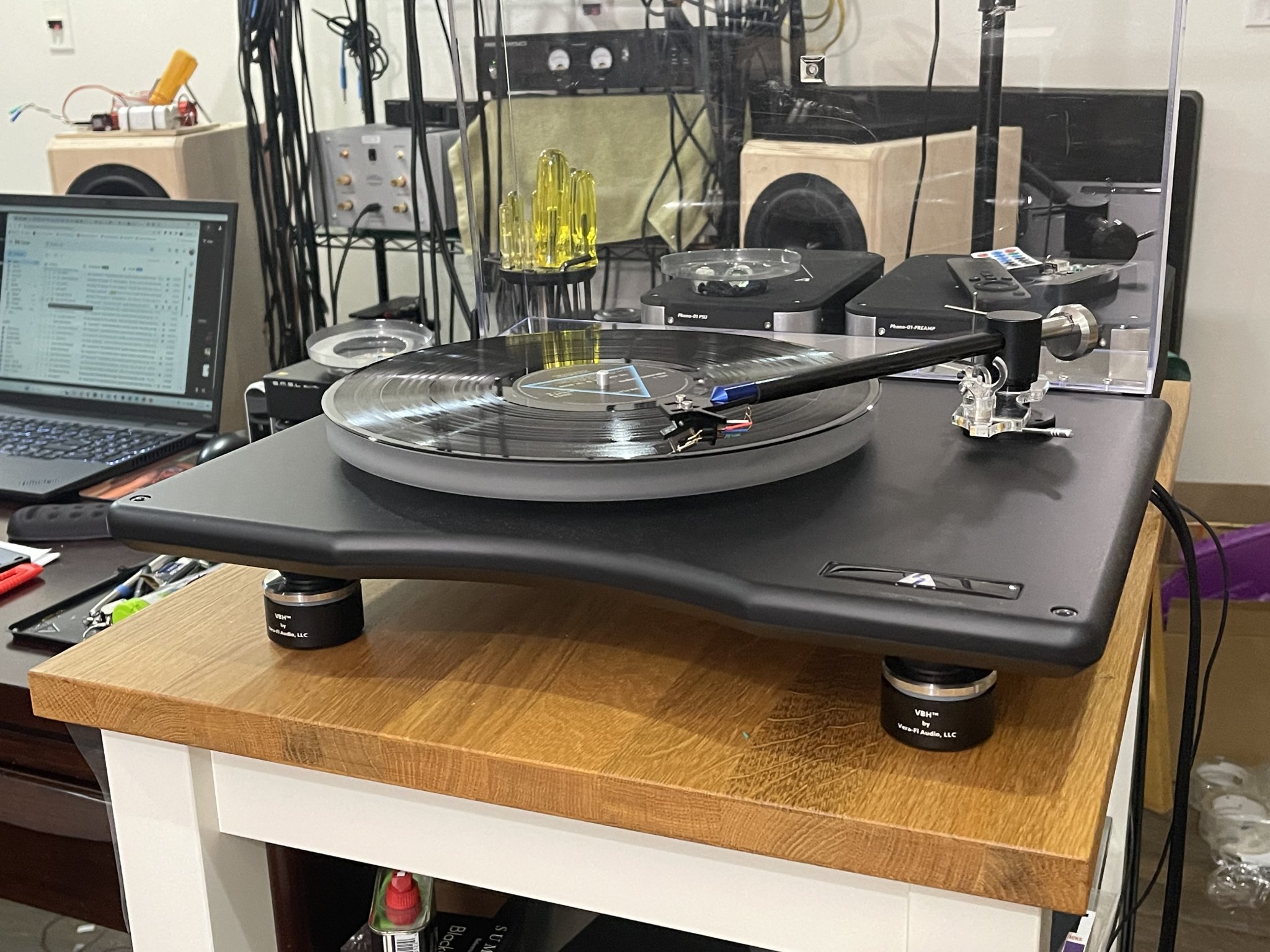

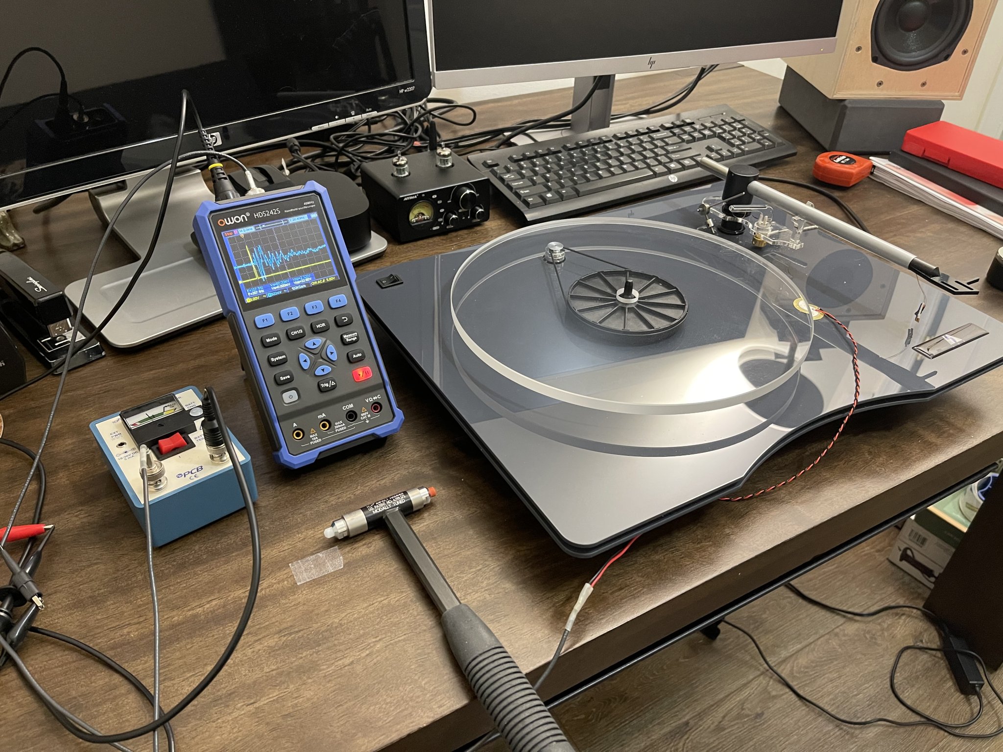

On the bench tonight is a test of the VBH using an instrumented hammer and piezoelectric transducer mounted to the plinth of a turntable.

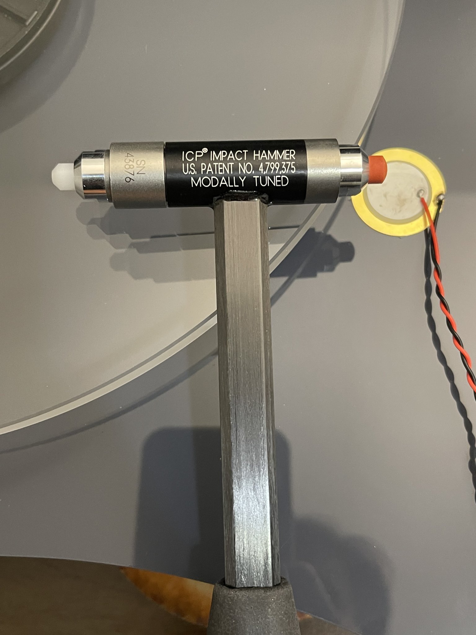

I find the instrumented impact hammer a very cool little tool.
The hammer connects with a BNC coax to its special signal conditioner (provides power to the opamp driver in the hammer force sensor head and cleans up the signal):
Various hardness tips can be exchanged and the hammer has a tuned carbon fiber neck.

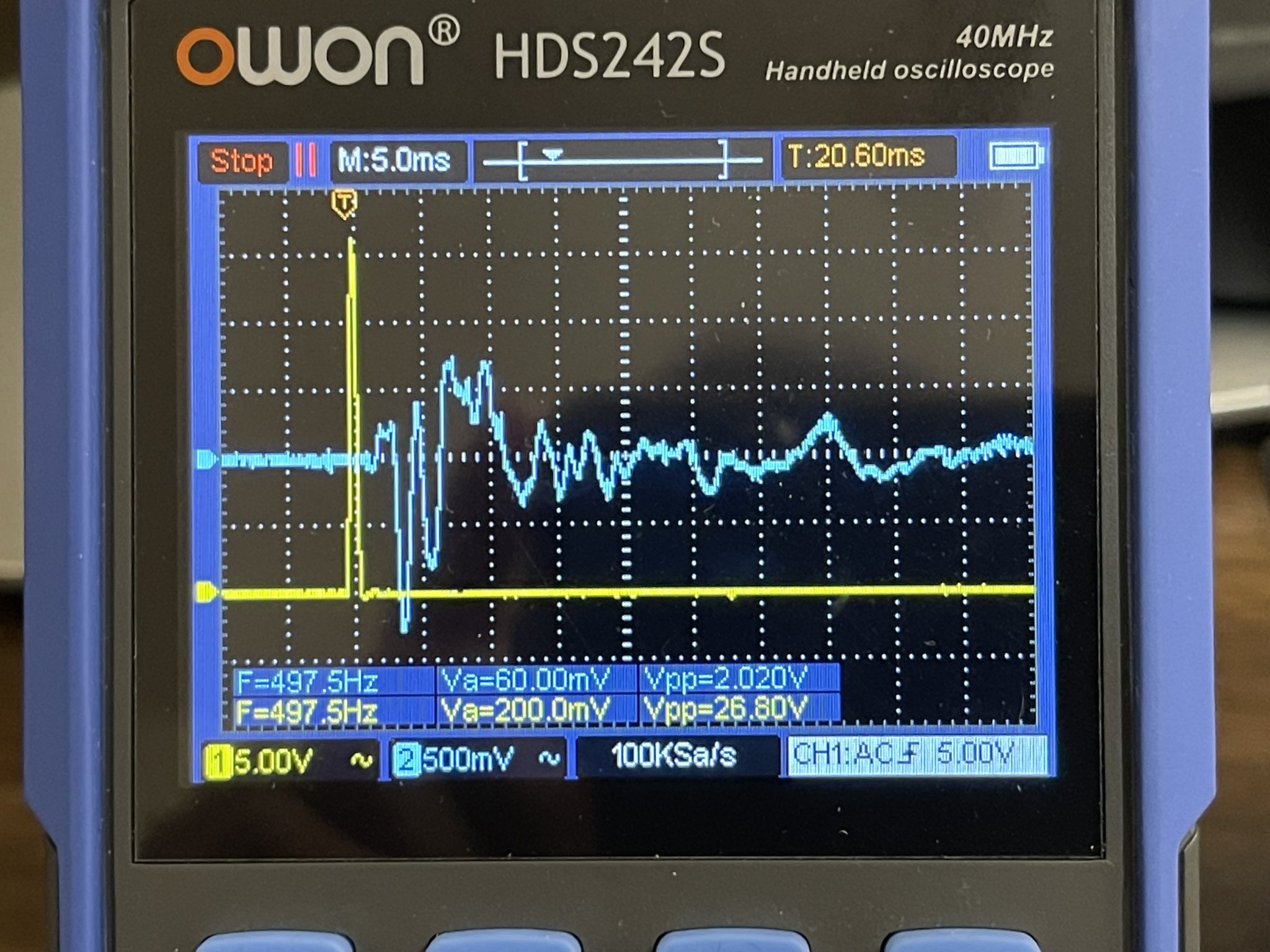

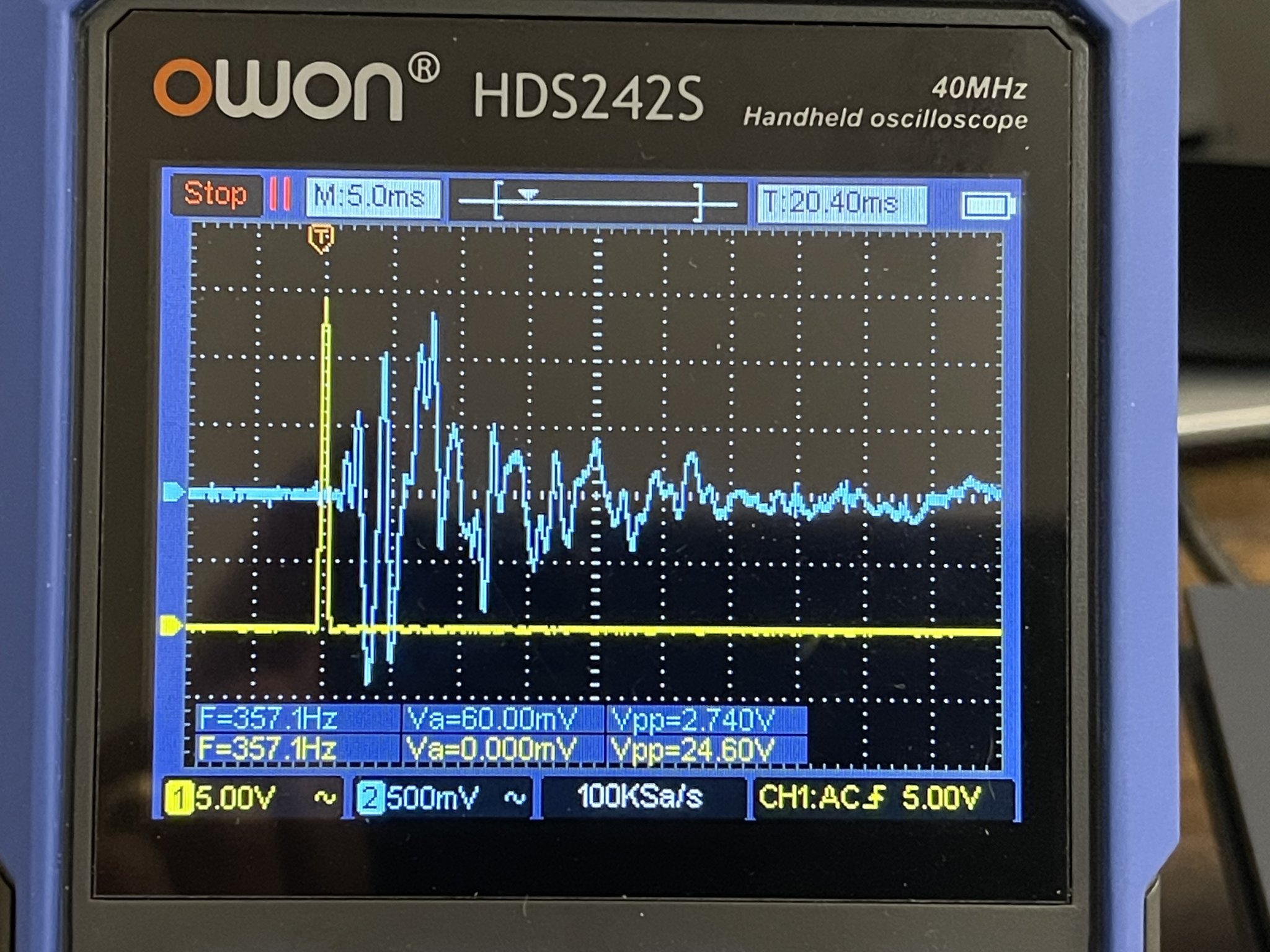

The yellow impulse is the hammer signal and the blue is the raw signal from disc piezoelectric transducer mounted on the device under test. In this case, a TT plinth. But could be anything like an amplifier, preamplifier, or speaker.
With VBH feet:
Without VBH feet:
The blue trace vibration is the wooden desk or bench itself moving after it gets struck. This minute motion is transmitted through the feet to the plinth.

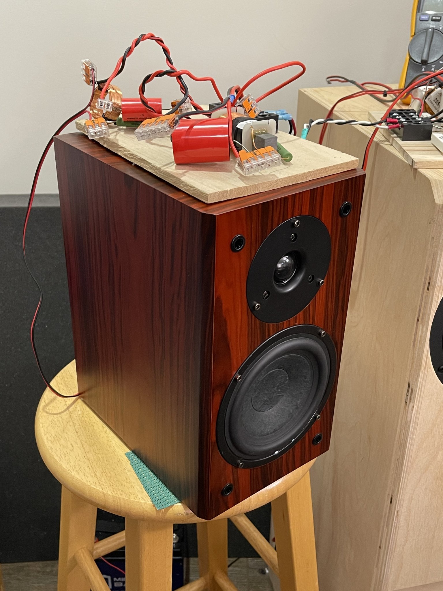

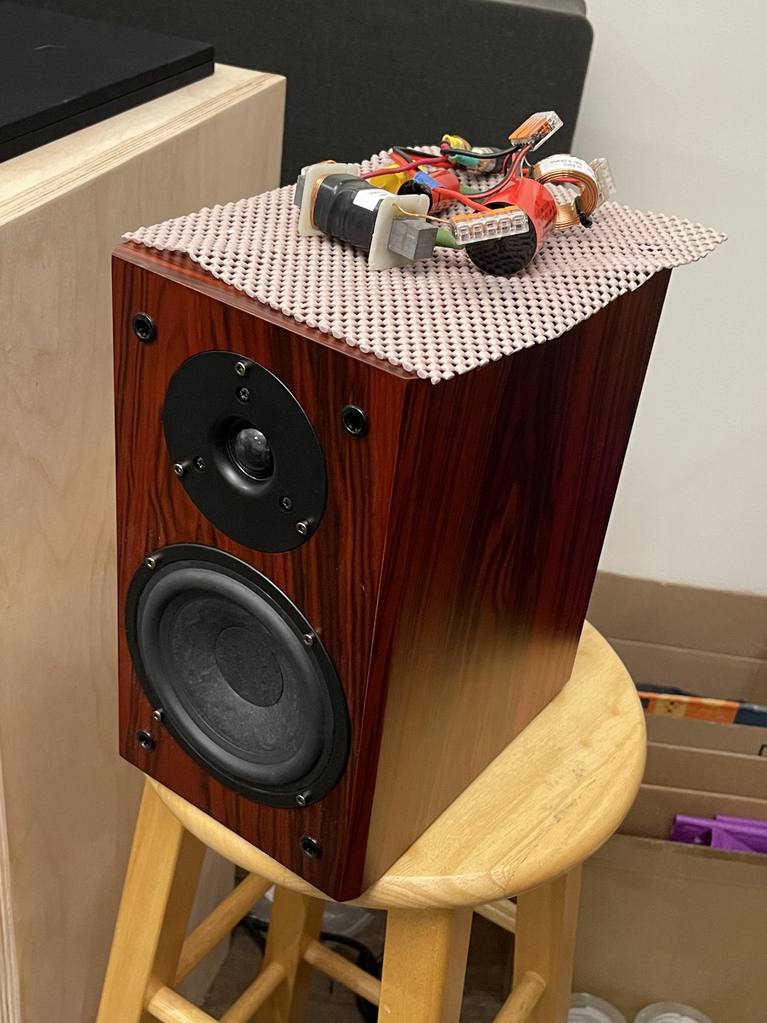

On the bench tonight is a new speaker crossover development. First measure the raw response then develop crossover in Xsim, then prototype using Wago connectors in P2P. This is a 5.25in paper cone woofer and 25mm soft dome. Bass reflex cabinet in wonderfully done rosewood veneer.
It’s sounding very good. Will listen and tweak XO voicing some more.

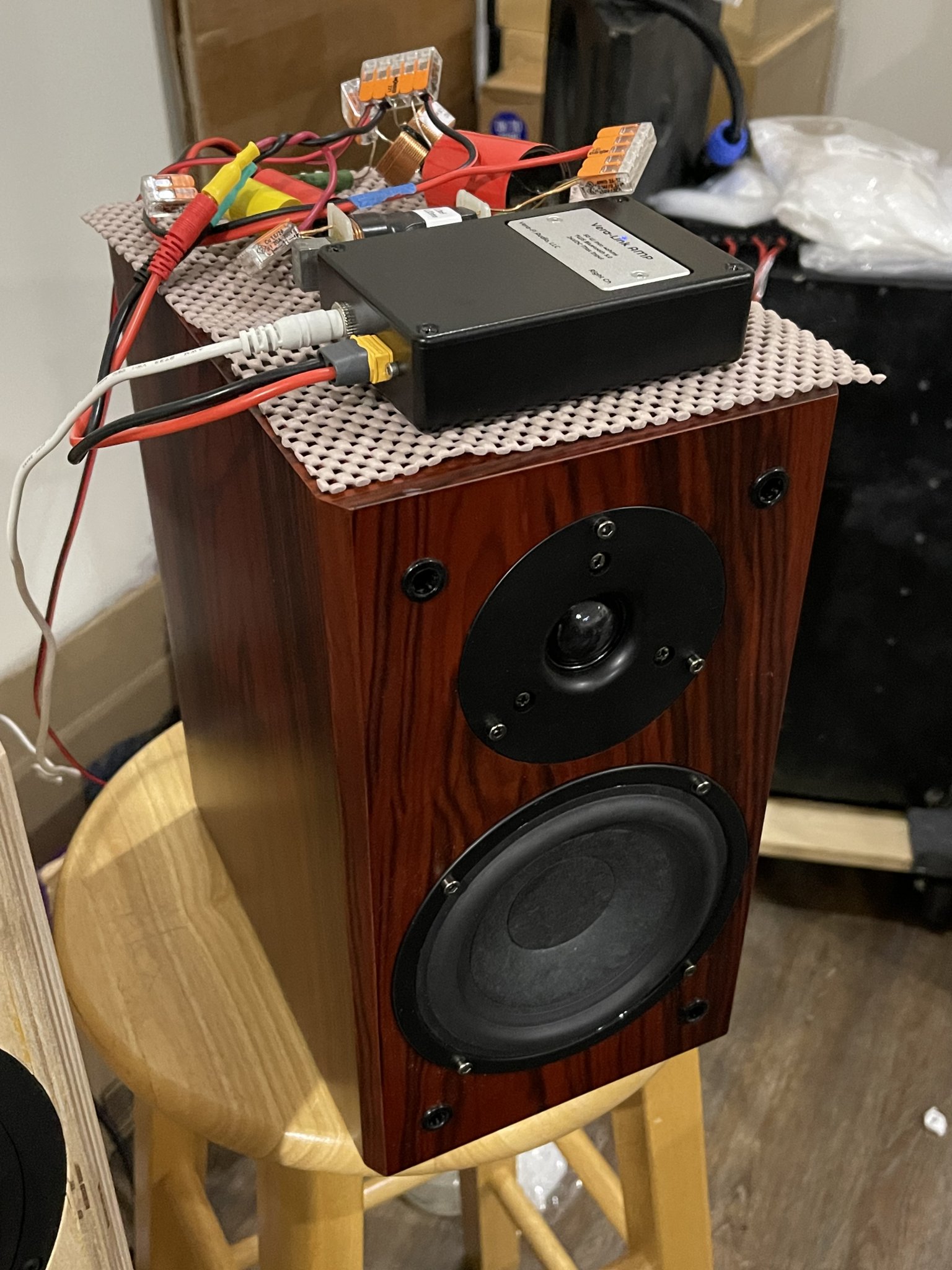

The Vanguard Scout is a 5.25in woofer 2-way with 25mm soft dome tweeter and bass reflex port superbly finished in rosewood veneer. I am getting close to the final crossover for this speaker. You can have a listen here - in mono.
Amp is EP600 and source is SMSL Su-9n fed by Amazon music streaming.

That's crazy! Did you just have one lying around? Or did you buy it specifically for the development of the iso feet?instrumented impact hammer
In just had one lying around - I have some other projects that used this. Bet you never saw an instrumented hammer before. 🙂
I should have fun and tap on various speaker cabinets made of MDF, plywood, particle board, foam core, etc.
