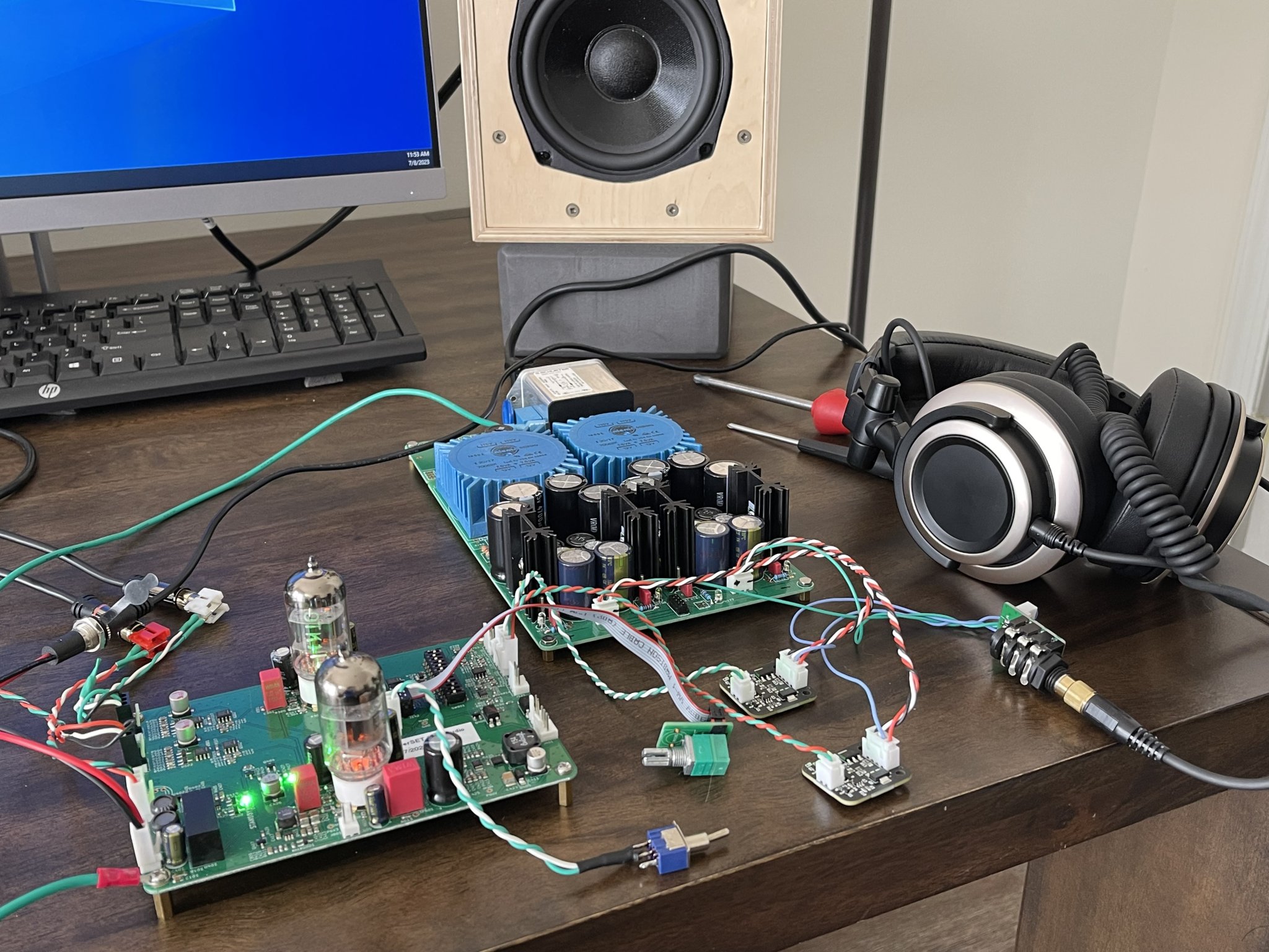

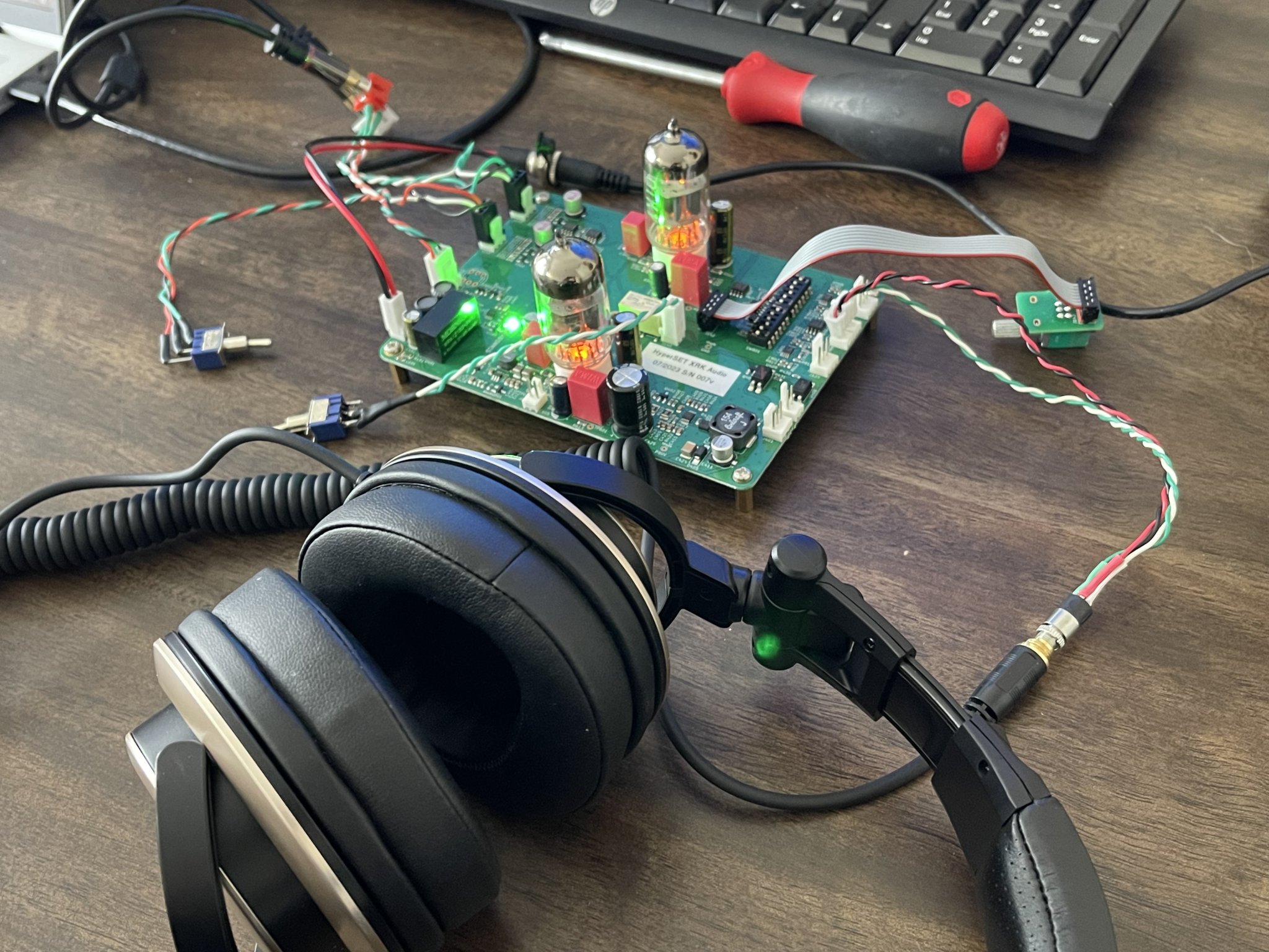

On the bench is the HyperSET being used as a headphone amp. It seems an OPA1656 (capable of up to 100mA) can drive 33ohm headphones just fine. 🙂

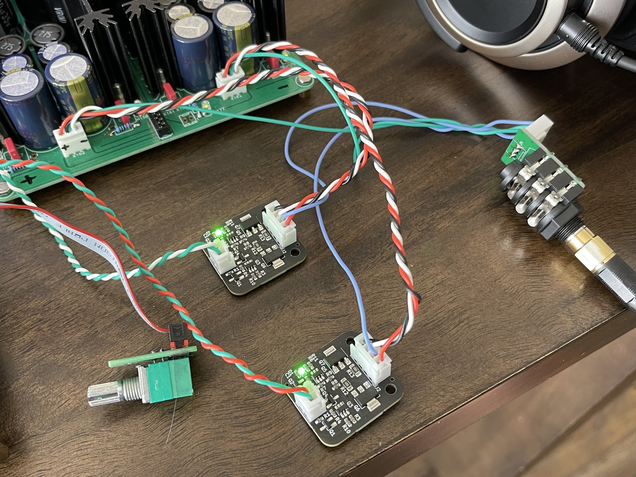

On the bench is a diamond output buffer designed by Jhofland. Driving it with BTSB hybrid tube preamp. Using Yarra Mk2 PSU with active bridges and TI TPS7A4XXX ultra low noise regulators putting out +/-20v. It’s doing a fantastic job driving 33ohm headphones. Very powerful snappy bass and super clear mods and highs. Superb resolution.

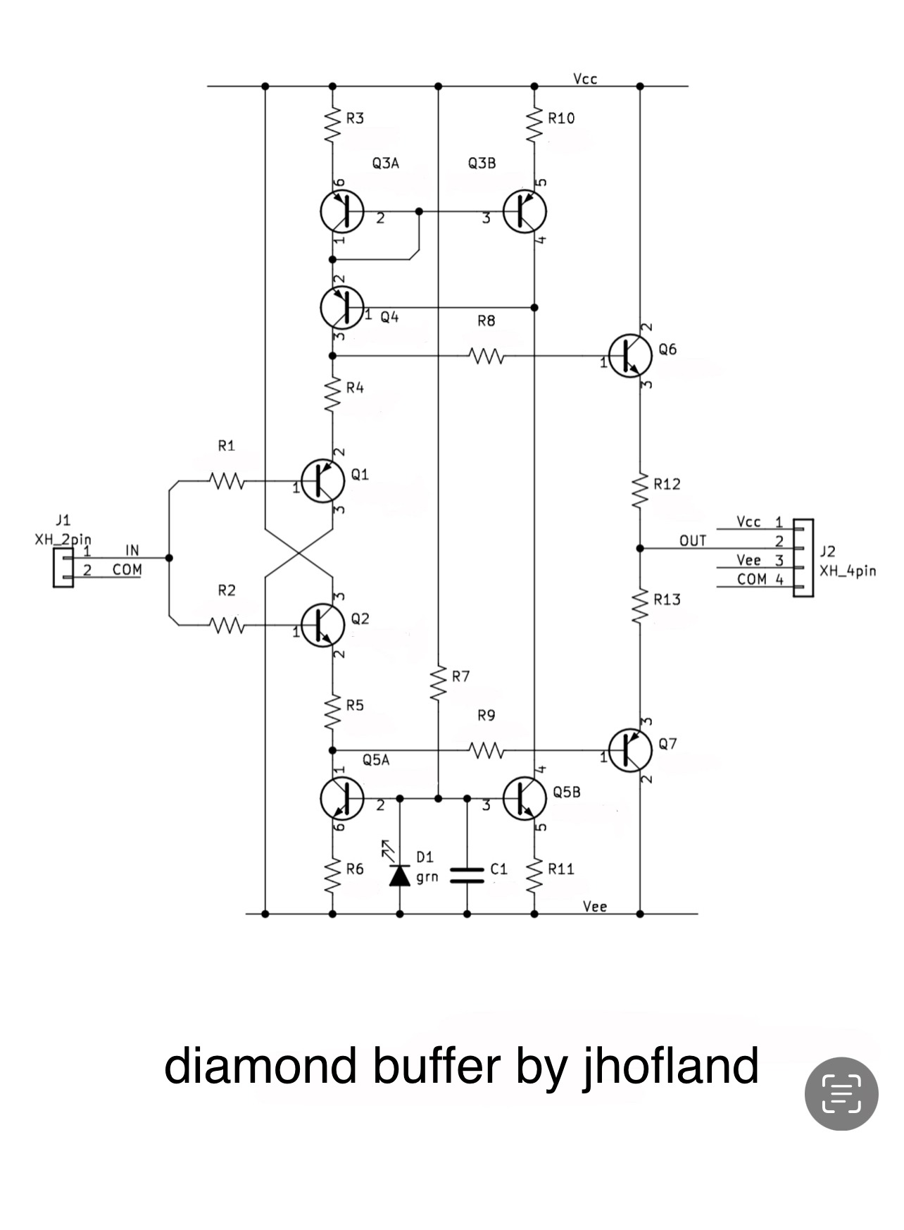

The design is still under development and testing. This is the topology. Not shown are some 100nF bypass caps on main rails. I connected the buffer to my HiFiman HE-400i planars (32ohm) and it drives them superbly. Great dynamics and bass punch. Very resolving.
Let me ask Jhofland to see when he is ready to release it for general DIY consumption. He’s testing it for stability etc.
Let me know what you find out!
Good news: Jhofland has graciously agreed to release the design. I’ll add it to my shop and may even offer a ready to run version (fully assembled SMT) and you just install the Molex KK or JST connector of your choice. I’ll start a new thread on it once details are available.

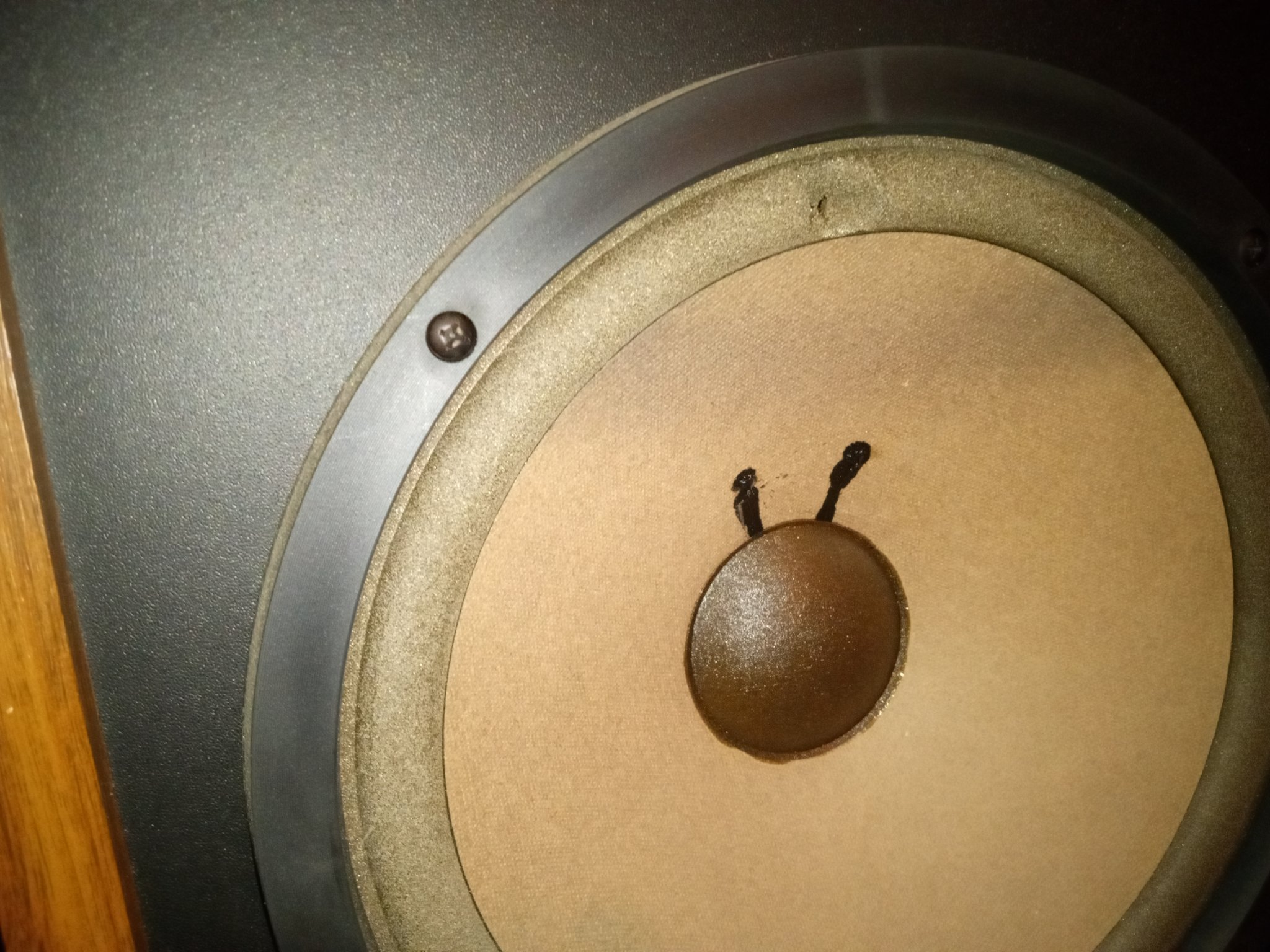

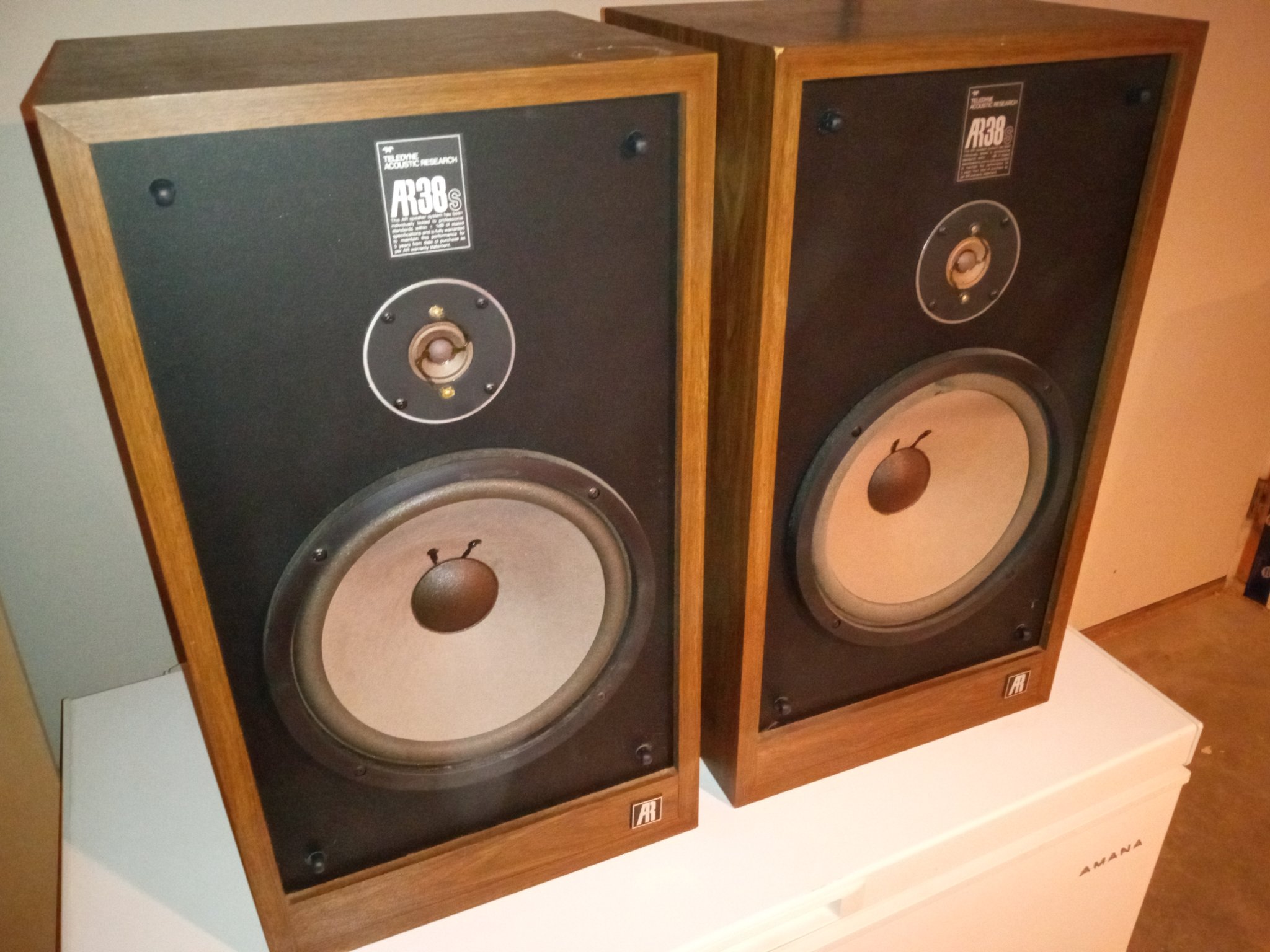

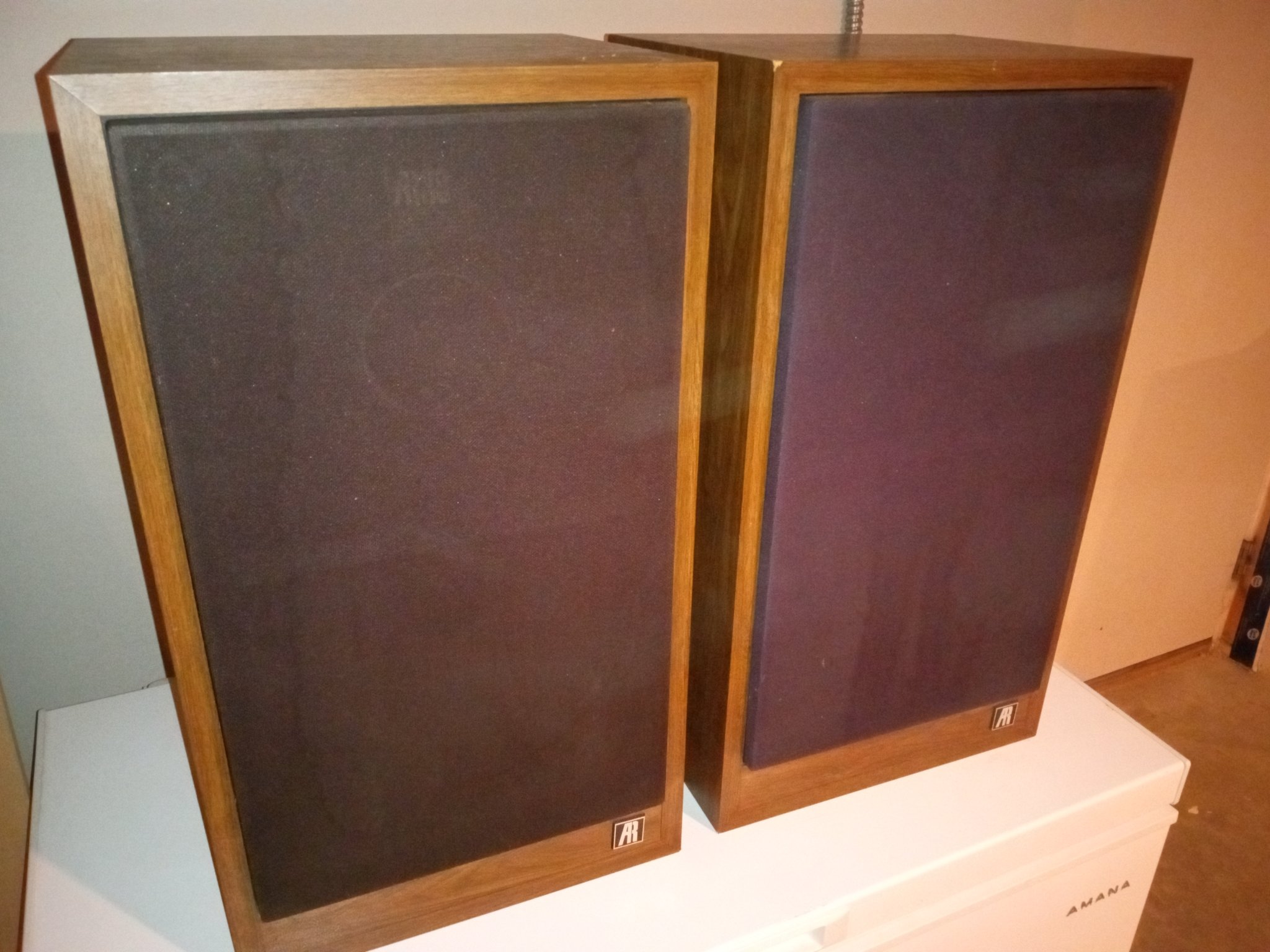

I scored a pair of AR38s speakers for free. I hooked one up and was pretty impressed by the sound. Probably not super HiFi, but decent for my old ears. As I was checking out the surrounds, my finger went through. Probably a good thing it happened now as I was planning new enclosures and a possible recap, and maybe a x-over tweak if needed. I will learn how to install some new surround material. See pic's below.
