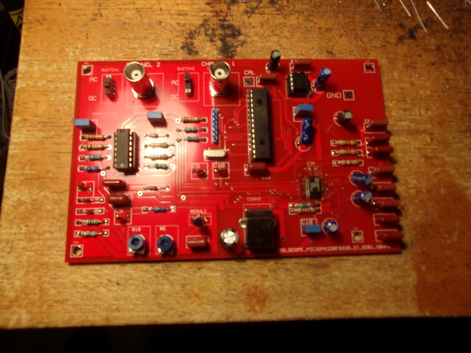

I have built up a USB PC dual channel 18 mega samples scope.
The scope end uses a PIC32mx230 and software was fairly straight forward.
The PC end was the more difficult end with numerous options to program in.
As well analogue display it has a spectrum analyser display which uses Fast Fourier Transform to convert from time domain to frequency domain.
It took a while to find an FFT that worked well. Even then I had convert output data for my use.
Powered by USB bus and powered inverted to get minus 5 volts for op amps.
Uses an AD9201 10 bit a2d converter.

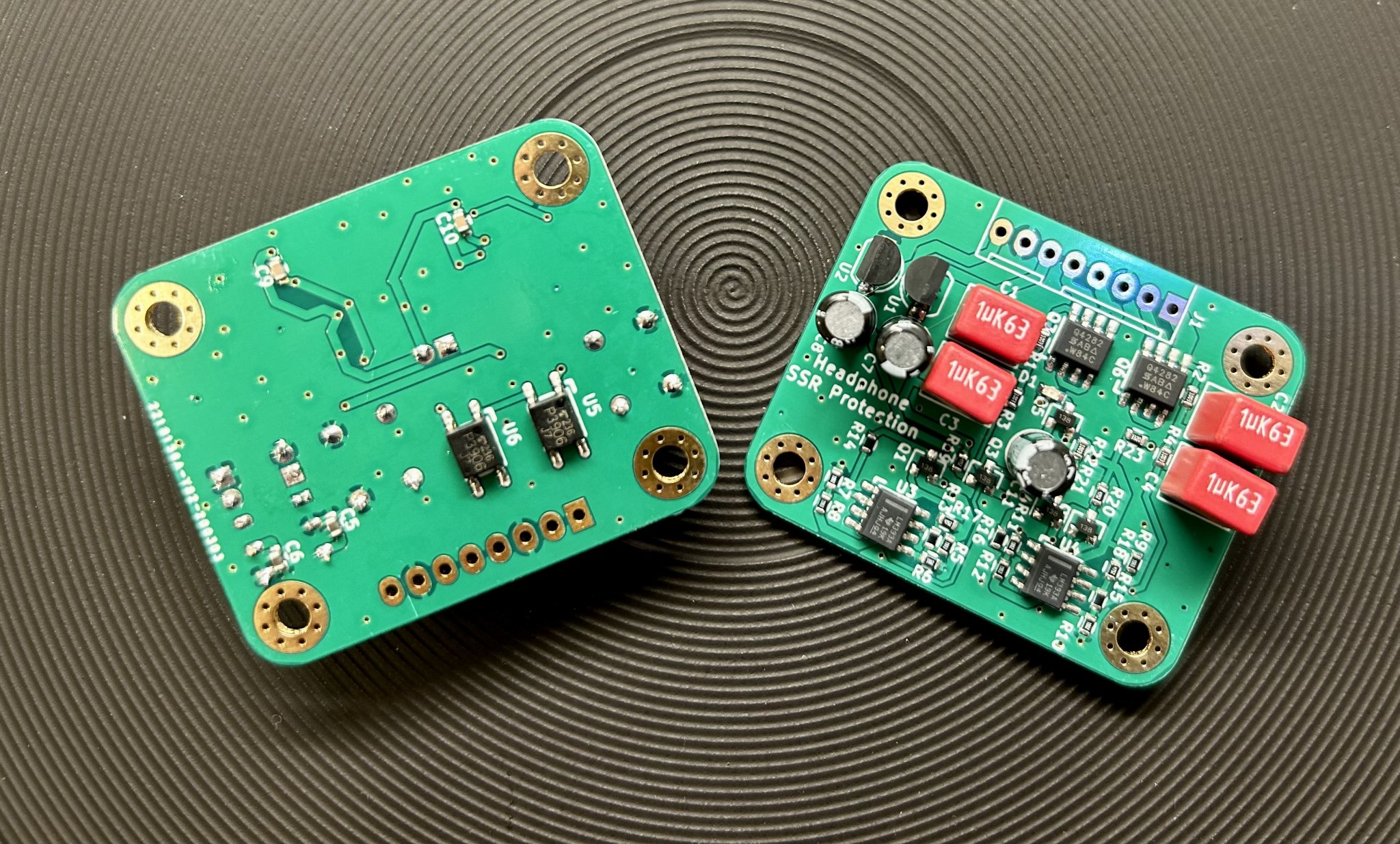

As practice prior to my BTSB marathon, I decided to build up the headphone protect boards that have 0603 parts, etc…used hot air only for the smallest resistors, caps and SOT stuff (Q1-Q5). Doesn’t look too bad.

Nice looking boards! Have you tested them for operation yet?
Simple continuity meter check for signal in to out and apply power. They should have a delay then conduct close to 0ohms.

Thanks. No not yet. I am in BTSB mode now. It’s likely I’ll test the BTSB before I even check these!

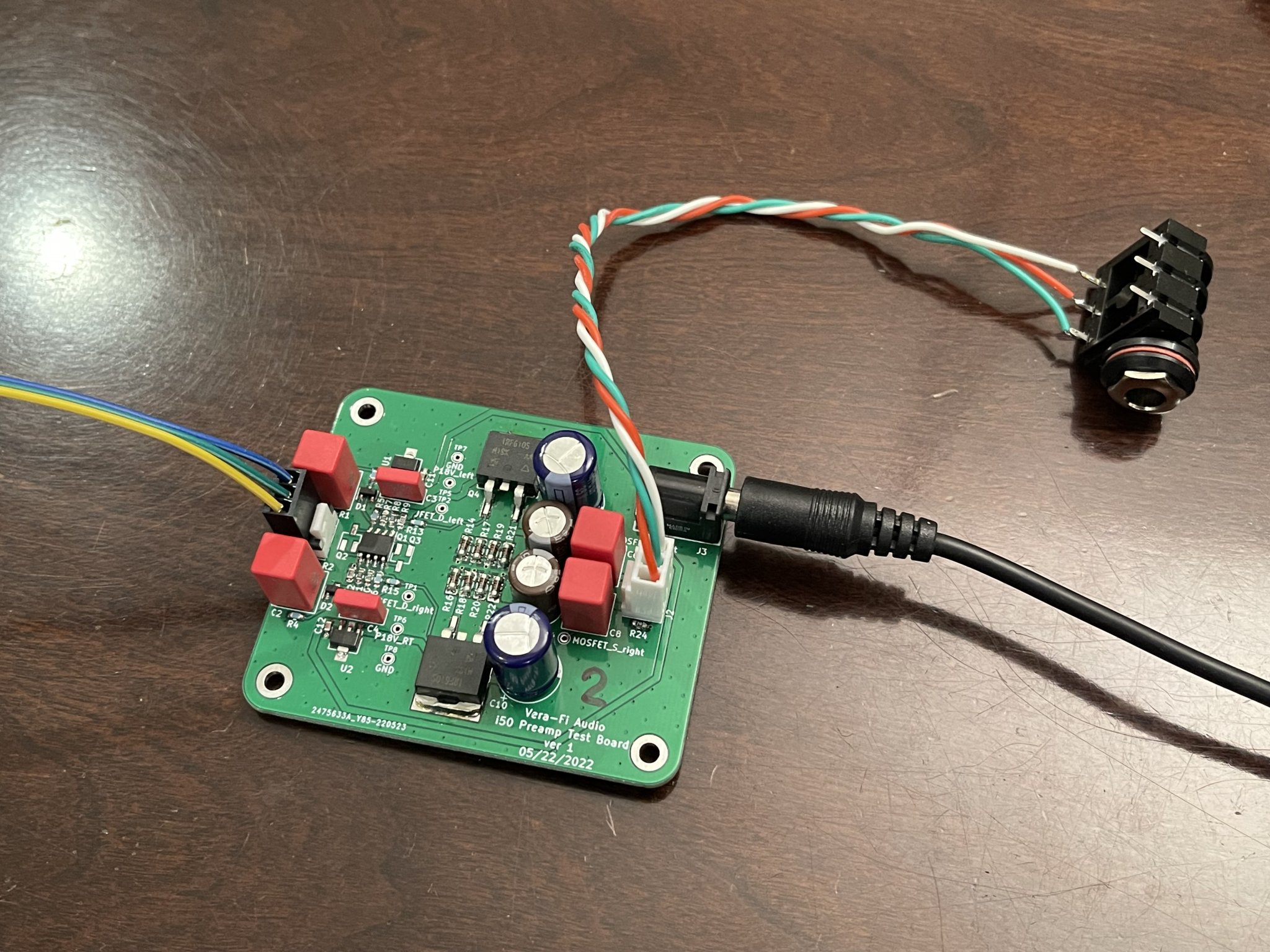

On the bench tonight is a new SE Class A JFET input MOSFET source follower preamp module for a new product under development for Vera-Fi Audio. The topology is similar to the DCA but uses an LSK389 for stereo and has a dual linear voltage regulator for each rail. DPAK output MOSFETs. I’m going to test it out as a basic headphone amp for high impedance headphones to check the sound.

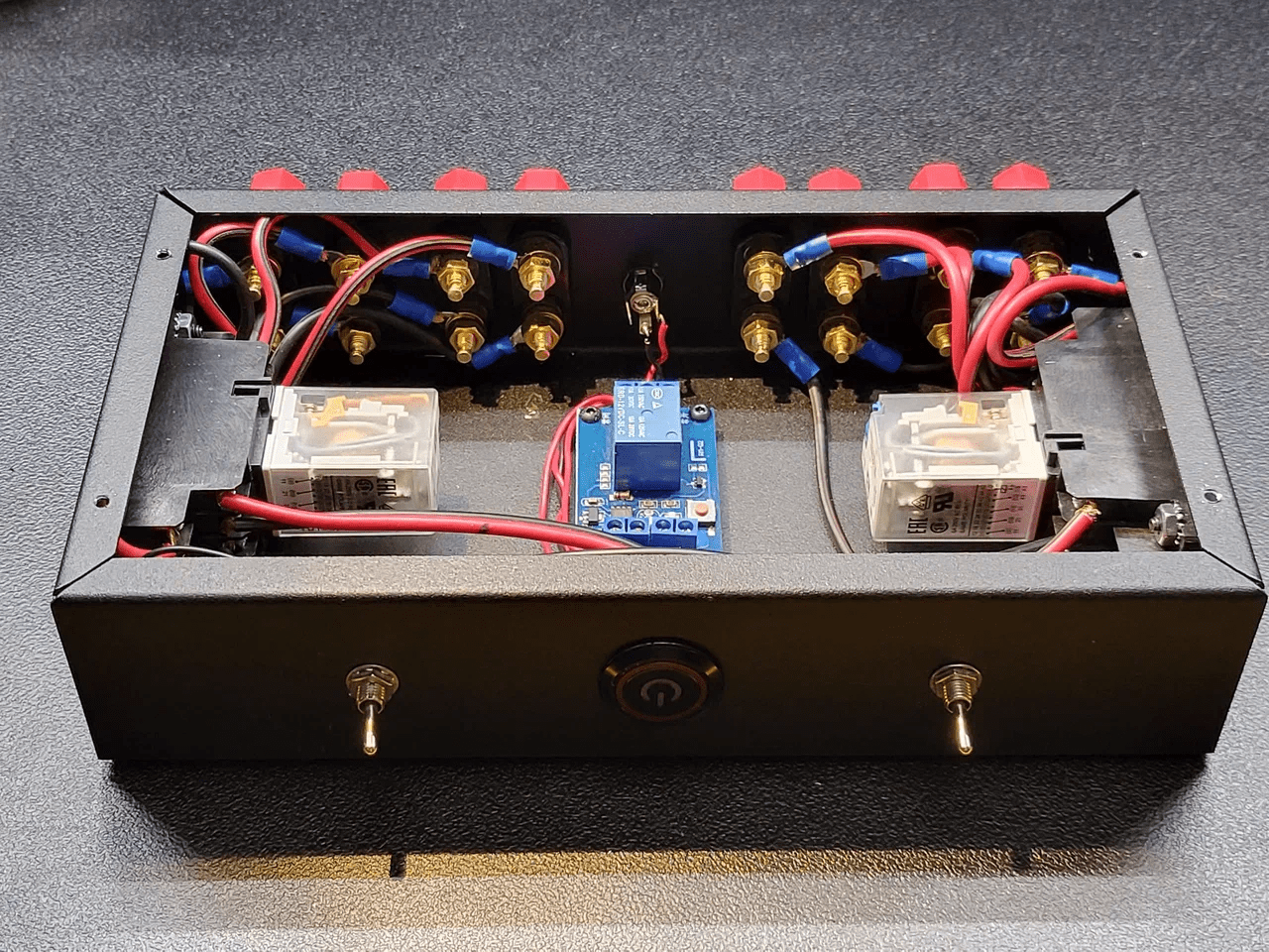

Just built a two in two out speaker switch for the bench so I can switch between the house amp and the amp being tested, and speakers or dummy loads.
I am finally listening to this preamp board as a headphone amp. I forgot how wonderful the PCA/DCA circuit sounds - fantastic. Something so pure about music from a 2 transistor SE Class A circuit. The dual JFET has perfect channel balance as setpoints are spot on left and right. The two voltage regulators isolate the common power supply for a stiff rail giving excellent channel separation for great soundstage.On the bench tonight is a new SE Class A JFET input MOSFET source follower preamp module for a new product under development for Vera-Fi Audio. The topology is similar to the DCA but uses an LSK389 for stereo and has a dual linear voltage regulator for each rail. DPAK output MOSFETs. I’m going to test it out as a basic headphone amp for high impedance headphones to check the sound.
I am listening with Beyer DT-880 (250ohms), which with 22uF caps gives a -3dB corner of 30Hz - so the bass is surprisinlgy good. Replace the 22uF cap with a 1000uF cap and this would be a great headphone amp all by itself for 32ohm cans.
The ability to connect a basic 24v Meanwell wall-wart for a PSU is very convenient.
