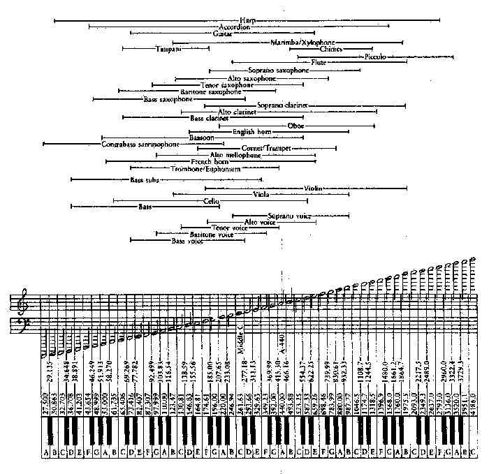

The fundamental of the A at the bottom of a piano keyboard is 27.5 Hz. Obviously we mostly hear overtones, but that note is there! Think about how much longer those strings are than those on a bass guitar. And don't forget that contrabass sarrusophone, too (whatever the heck that is). 🙂
Seriously though, harps go below 40 Hz (and play some great stuff there) and some pianos (Bosendorfer Imperial Concert Grand) have 96 keys and go to 16.35 Hz.
Bob's yer uncle.
