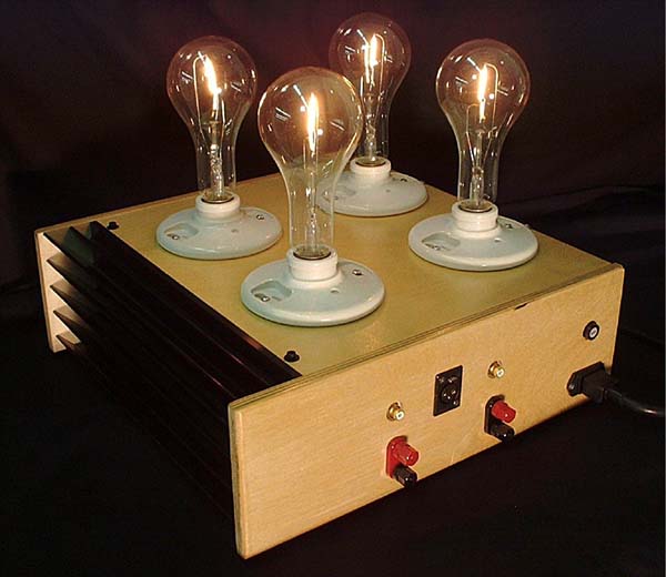

quote: It's difficult to make a high power SE valve amplifier, so most are <10W.
Not so difficult, just more expensive. SE up to 30 watts are pretty straight forward. It is difficult to get SE transformers above 50 watts, and many transformer designers believe that the limit is about 100 watts.
Going by what the RCA Radiotron Designers Handbook recommends, a 200 watt SE OPT (one channel) should weigh over 90 pounds.
I've got some 200W PSE 300B trannies under the bench, along with their parafeed chokes... Each measure about 14 inches on a side. The set weighs 550lb.
Woah! 200 watts PPPPPPPPPPPPSE 300B's that would take at least 20 tubes per channel. Tube cost alone would stop me from building this one. The plate current would be about an amp! Where did you find such things?
I have got some 2HY 1.5 amp chokes. They weigh about 75lbs each. Military surplus.
