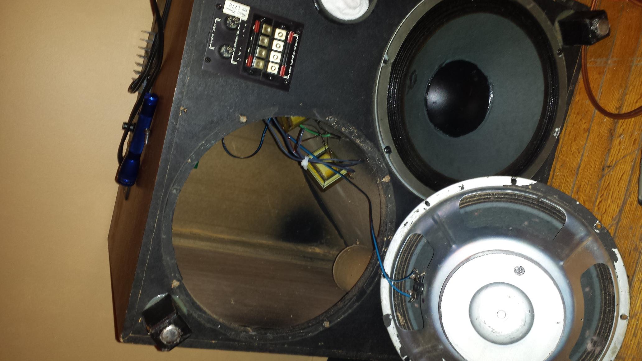

acoustic stuffing, no. Bracing of those large spans, youd think it would be a good idea, but they dont exist either. 70s tech, still pretty good Ill add. But it would hit certain notes and sound gawd awful horrible and rumble like a fat guy that hasnt eaten breakfast.
Its only ugly from the bottom, the other sides are quite lush looking.

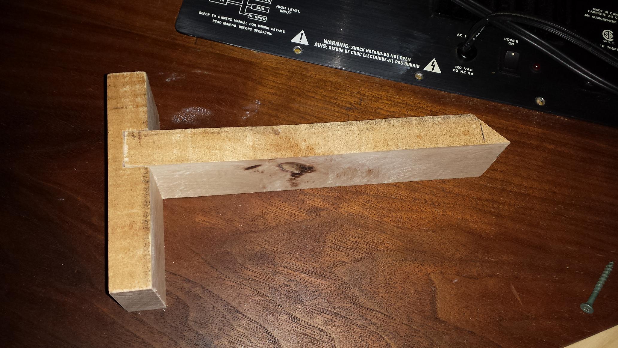

First I tried plugging up the ports for each 12 inch drivers chamber, that helped but didnt cure the problems. Some very rigid walnut bracing (two per side) should make a world for minimizing the ringing and resonating. Ill experiment with some batten as well. Its a good sub worth the effort. The original wiring is useless to me. Someone before me thought the same and added a plate amp. This sub in a medium room turns my organs upside down. Originally it speced around 22-23 hz I believe it was. Its tuned pretty low. Im trying it sealed firstly, then ill experiment with it open as well.
