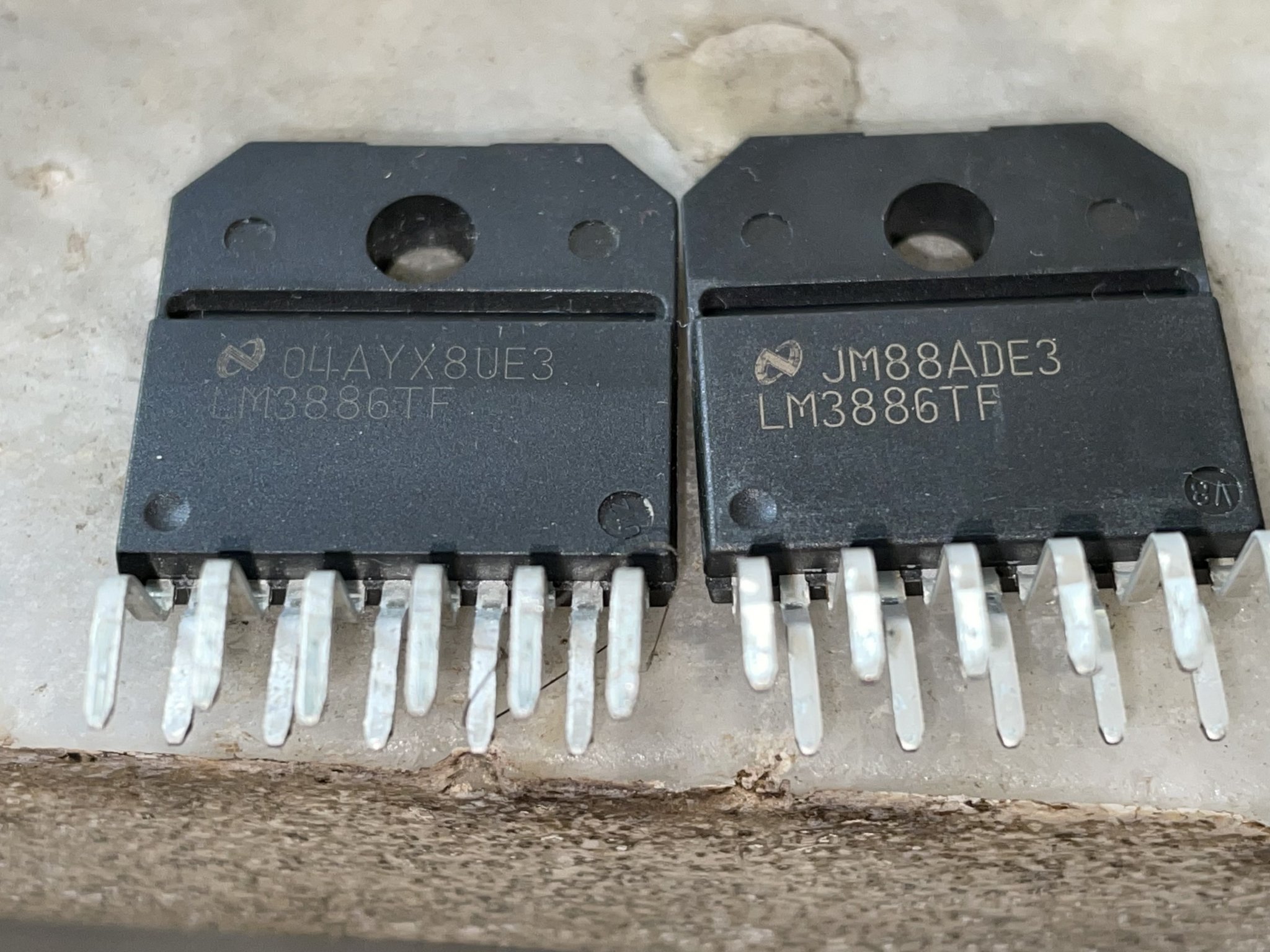

I think I have got originals from Micheal (USA) compared to the DiyAudioCart supply in India here is a pic
the on the left is India. Supply and right is from Micheal
currently using the USA purchased in a composite amp - My ref Rev A and it’s decent sounding
Left one fonts are same as right one. Should work okay, only 9 digits instead of 8.
Molding marks are the same. Letters on ejector pins on lower right are similar.
Very close copy, or original on left also.
I should know, I mold plastics for a living..

The ejector pin letter is different, rubbing marks on the serial area look closely, brightness of the etch and width of the etching laser is different.Left one fonts are same as right one. Should work okay, only 9 digits instead of 8.

picture taken after ipa clean with a swab
That is within range if made in 2 different plants, or in different years, same plant.
The molds are identical, and shape of letter 'M' and '3' and '6' are distinctive.
In fact such a close copy would fool merchants who knowingly sell copies.
They look for things like this, and metal tab chamfer, overall appearance to quickly distinguish good from poor.
Just check print area location with a vernier, that also will give a clue, if it is re marked, the laser may not be properly indexed. That will tell if it is fake.
Allow 0.5 mm tolerance.
Laser intensity and plastic composition can cause differences in marking results, so I did not pay attention to those.
There are no abrasive or solvent marks to show removal of old markings.
If it was a fake, the real mark would have to be removed, and the surface would not be rough.
Also, see if any other chip is sold in such a package, DIP 8 and DIP 14 are common, 358 sold as 5532 is a common example.
No idea about this package.
