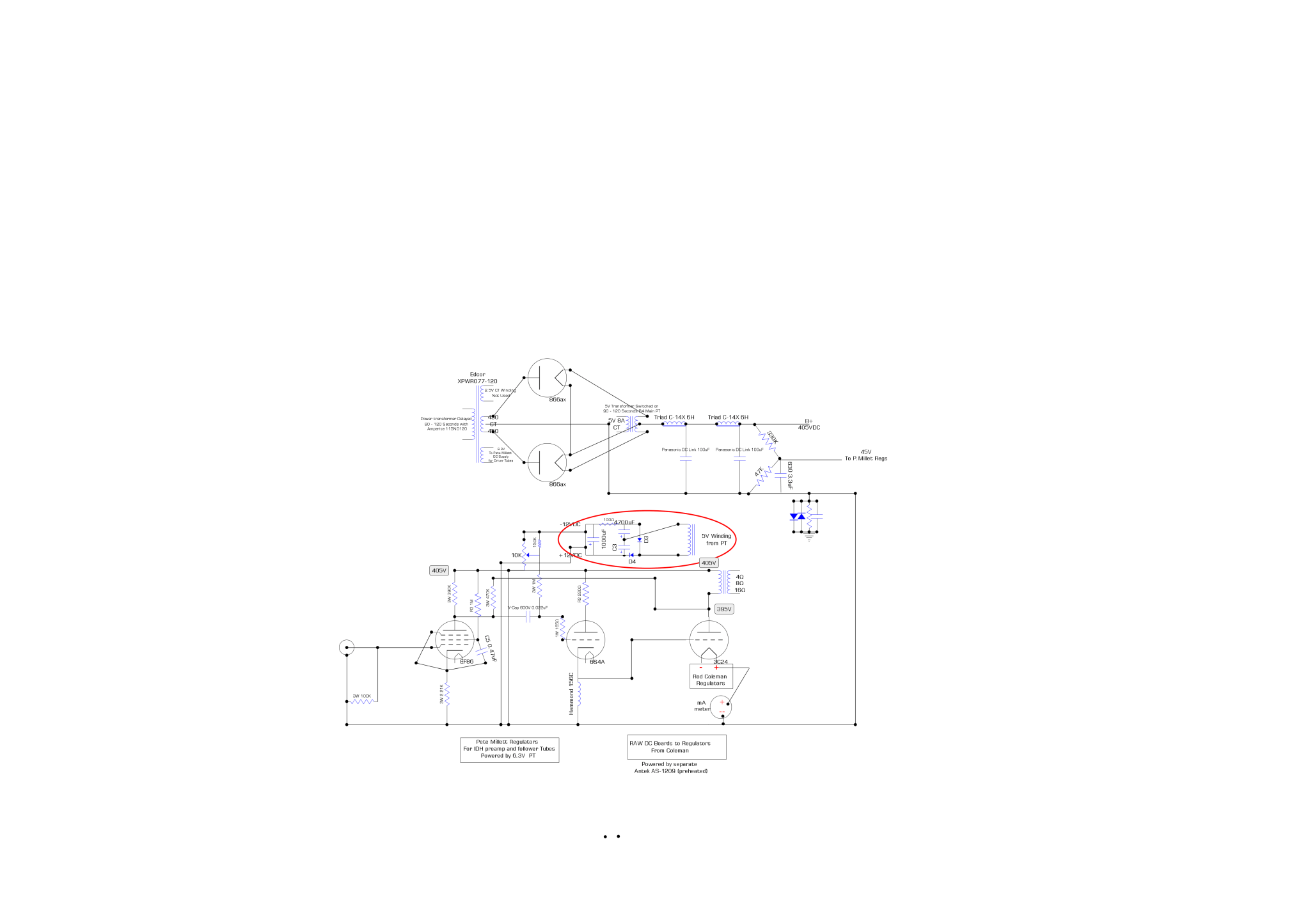

here is my revised schematic. The Bias adjust for the 3C24 is outlined in a red oval.

No, the 6H choke does not matter, you measured the B+ with 406V, and it does not matter what the choke resistance was during that measurement.
What matters is that we had 406V after the choke.
But we do not have the exact currents yet, because of unknown 3c24 grid and anode current, so i need the exact resistances of the 150H choke and OPT.
But sure, to be able to get accurate results when simulating the ps, we need to have everything as close to reality as possible.
Both 6H chokes must be measured also because theyr real resistance can depart from 150 ohm, according to datasheet, by -20/+50%..
So, measure all choke and the OPT primary resistances.
For best accuracy conditions during the resistance measurements should be as close as possible to the measuring conditions you had when measuring the voltages #43, when originally built.
Adjust the current to the same 60mA you had originally and the temperature of chokes and OPT temperature should be as close as possible to the conditions you had during #43 voltage measurement.
Make sure the 600uf caps are fully discharged before taking resistance readings!

I just recalculated with the now known (took a long time to get that info) original 60mA metered current at B+ 406V.
It turned out that the difference do to the 150H choke is quite small, because the choke current of 4.22mA gets swamped by 3C24 grid current of 19.18mA,.
The dcr of the choke with 75deg estimated temp increase would go from 3700ohm to 4785ohm, with 15.6V the chokes current would go down less
than 1mA. Total current draw would drop from 66.81 to 65.81mA
This is, given that the voltages WntrMute provided in #43 and the datasheet resistances are correct.
But something more worrying than 1mA errors is the fact that the 6S4A driver is not preheated bevor switching on the anode voltage.
This means that the 6S4A and 3C24 current draw only slowly builds up together, and during this heater delay the 600Vcap voltages could rise to much
higher levels than would be safe for them and also the EF86.
Hard to say by how much, but that could have been the reason for the Xformer fault, overvoltage on the cap led to a cap short that got suddenly cleared by self healing, currentinterruption, and the resulting voltage transient took out the transformer.
I guess at least some form of voltage clamping, a VDR, or zener, during start up is needed, what is your take on this?

The datasheet i found for the Hammond 156C choke differs from yours, mine from Hammond, states 150H at 8mA, Rdc 3700 ohm,
tolerance +-15% on inductance and resistance.
If this given nominal 3700 ohm is correct (measured "cold" i assume) with +-15% this can be anything between 3145 and 4255 ohm.
We must wait until WntrMute can give us the actually measured cold resistance. Then we make some adjustments to account for resistance increase do to temperature.
According to the values given in #43 the 3C24 ground to grid voltage is 15.6V.
It follows that the dc through the cold choke is in the range of 3.67-4.22-4.96mA.
With 15.6V across, the highest dc this choke will see is 5mA.
More than than 15.6V is a no no, because the anode of the 6S4A anode is rated fora 8.5W max., and based on my calculations with the nominal values we are with 9W allready above that. (could be easely fixed, since the 3C24 dissipation of only 16W on the anode and 0.3W at the grid is not even near to Its 25W max.

My concern was more about the 6S4A being cold heater when high voltage starts up, it will not supply sufficient current to the 3C24 grid and therefore the anode cannot limit the rising up voltage. Without loading it takes less than a second to reach 600V, the 6S4A needs 15 sec to heat.
I would have suggested a string of 5W zeners, 6 of those could surely take up 30W for a few seconds and they would drop out as soon as the 6S4A is heated up sufficiently to be able to supply current to the grid. MOV could also be an option, but those have higher tolerancess i thinck, havnt looked into it
WntrMute, if the 5V winding on yöur powertransformer is unused (as your circuit diagram indicates) we can use that winding to prop up your powersupply in approximatly 6V steps to the level you desire.
But before that, i would want to make sure that you installed startup voltage protection. Six 5W 91V zener diodes in series across C2 should do if some form of heatcapacity is provided (for example a block connector that can soak up heat ). Do not shorten the legs. Mount away from heatsources.
If thats so, then we need to make some changes and integrate that bias circuit into it, should not be to difficult, but not today, soon 4am here.

WntrMute, looks like your circuit diagram still needs some corrections. is there really the + side of the doubler grounded or is there a mistake in your diagram? (the doubler gives +- 6V, a total of 12V).. The 1000uF cap looks shorted, B+ looks shorted to ground, the outer connection of the 10k pot looks to be connected to B+ (should be connected across across the 1000uF i guess).
Anyway, I would have tougth there is a +- 6V regulation in respect to ground.
Please tell me the exact bias regulation range in respect to ground, is it really zero to -12V or +-6V?
Anyway, disregarding the implications of the biasing, I simmed what i had in mind and it should work even if your first choke would saturate at start up and the only load would be the 330+47k resistors.
The 5W zeners are only burdened with 5W each in case the chokes inductance plummets do to saturation and falls to 10% of the rated 6H.
Possible (because peak current is around 1A during start up) but only for a very short time. As soon as the choke L1 comes out of saturation it regaines its nominal inductance of 6H and the zener diodes heat burden will be maximal 1.2W each. And this 1.2W only during the time the tubes arent yet heated enough to take over the load. As soon as the tubes suck enough current to drop the voltage drops below ca 540V the zeners cease to conduct any current.
What I have in mind needs:
6 pcs 1N377B 5W 91V zener diodes serial connected. From ground first anode-cathode-anode-cathode a.s.o. ending with cath (the white ring) toB+.
