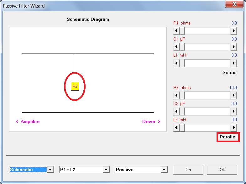

Using the Filter Wizard in Hornresp will give you the answers to your questions, and allow you to see exactly how the response is affected by inserting a series or parallel resistor between the amplifier and the driver.
