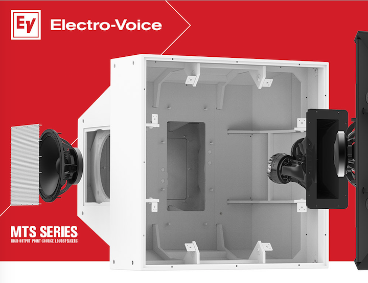

It is interesting (sad...) to see EV now using B&C drivers in their large scale designs:EV is like JBL in that their top of the line stuff is as good as any I presume. It will be difficult and frustrating for most to find contemporary drivers of equal quality to the top performing EV and JBL units just through trial and error though I believe there are a few that are as good or better. The places to look would be Radian, and couple Beyma drivers, and then maybe Faital, LaVoce, PRV, BMS, and maybe Kartesian. That said I believe compression drivers are best suited for large scale sound reproduction and overkill and less performative than certain properly implemented direct radiating designs at near to midfield listening distances.
25 years after it closed, I still miss EV's Buchanan, Michigan factory.
Don't miss the toxins it released...
