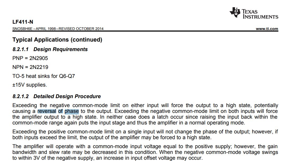

It competes well against the 741 for sure, but the phase-reversal issue and high distortion go against it. Early datasheets tout it as high bandwidth and low distortion, because this was before the really performant opamps had been designed and 3MHz was high bandwidth and 0.02% was low distortion...
The TL072 overtook the LF411 in audio gear due to the ~20dB lower distortion. I don't think it recovered from this.
These days you can get yourself for instance an OPA1652 if you want a good FET opamp that proves that old opamps are definitely not the best. It has protection against phase-reversal which is a bain in the old JFET amps. And the OPA1652 datasheet is way better than those for old devices - so many more parameters graphed and characterized.
So in what instance creates said phase reversal? It won't latch up. So what is the worst that can happen? I know I preffered it over the TL072 and 5534 in my listening tests and my oscilloscope liked it better too.

Yes well tons of gear has been stuffed full of TL072, which mostly have the same ill effect, and nobody dies. If you don't clip the stage before, you don't flip your bit. If you do, as in my headphone amp for live performance, the "tik!" is very short and supersonic. It is mostly a danger to people who listen with an oscilloscope, but I'm sure it has killed a few tweeters and ruined some master wax.
It competes well against the 741 for sure, but the phase-reversal issue and high distortion go against it.... ~20dB lower distortion.
Has anyone verified that?? IMHO the LF411 and TL071 are not so different, except the TL is many cents cheaper. An OoM different THD could well be that Linear had not yet got a good meter, and TI did.
