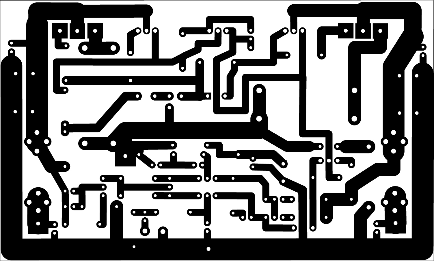

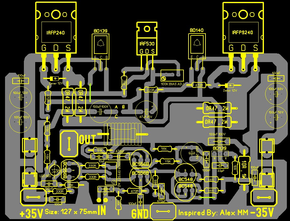

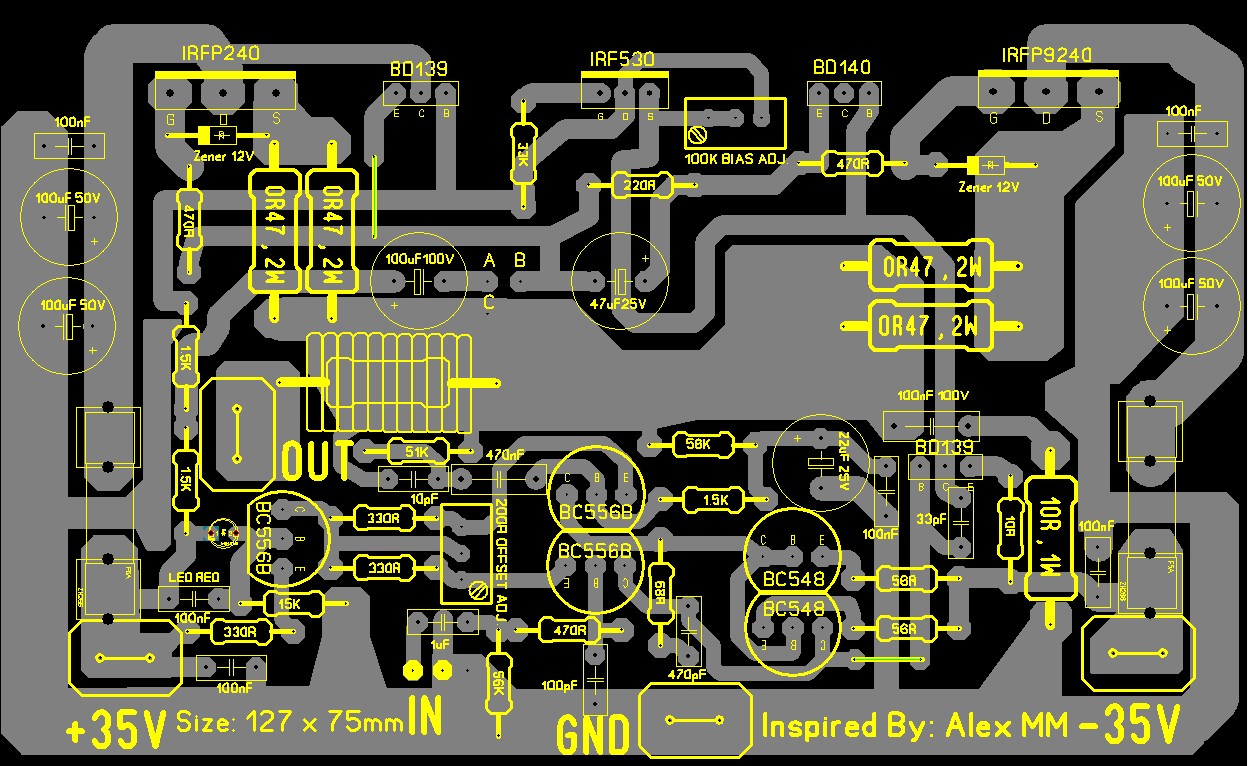

Attempt for PCB
Inspired by Alex MM and his pieces of art PCB's I decide to try to create one for this project because this actually is my amp that I listen every day and enjoying its very good sound. Now is build on veroboard and I think it deserves a PCB. Some day will rebuild it totally with nice PCB's better heatsink and better box.
Attaching the schematic and PCB top and B&W images.
On the PCB and on the schematic there are tree link points - A , B and C.
Previous in the thread I was suggested to move the bootstrap source from output to the emitter of the BD139 driver transistor. I did not try this yet but made the PCB to be able to try it. If you link A and C points source will be at the output and if you link A and C points source will be at the emitter of BD139 driver. So you will be able to change the source according to your taste 🙂

Like that you won't be able to twist the supply leads together. I don't see separate input and output grounds either?
What do you mean with that? Can't twist supply wires together which is possible or what? On the PCB there is no output GND it is taken directly from the power supply. Amplifier work like this now and it is dead silent - if you put your ear to the speaker you won't understand whatever amp is turned ON or is OFF.
By twisting the supply leads with ground you magnetically couple them so the magnetic fields cancel and don't radiate into nearby circuits.
The power traces as they are now form a big loop around the PCB, radiating into everything inside. At significant currents these are highly distorted rectified waves. Look at how OStripper did the DIYAmp PCB:

That may give you some inspiration. If you can keep the power/ground lines close and twist them together (or perhaps better just to heatshrink them into an untwisted triangle; for a more uniform magnetic field and close coupling), there will not be so much inductance between the board and the offboard large lytic caps, again reducing EMI.
Unfortunately the nice symmetry is lost. Bummer. 🙁

Well OS is a master and I'm a newbie 🙂
His PCB is good but it has two layers also and I cant make two layered PCB.
We always can ask for better but I think this one is OK anyway if you can see any big problem tell me.

I just noticed you added an option for my bootstrap mod. 🙂
I looked at your PCB in detail and it looks like you covered all your bases. Pretty good I think, though I'm not one to ask.

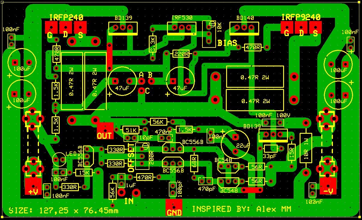

PCB Second Attempt...
Alex told me that is using Sprint Layout 5.0 so I decide to give myself a try. After a day for trying to learn the software and another for creating some custom elements and yet another day for drawing I came up with a new PCB.This software is difficult but it have much more capabilities than ExpressPCB so it worth it to start learn it.
So here it is. It is not perfect but don't forget that I'm still learning 🙂 Any comments are welcome!

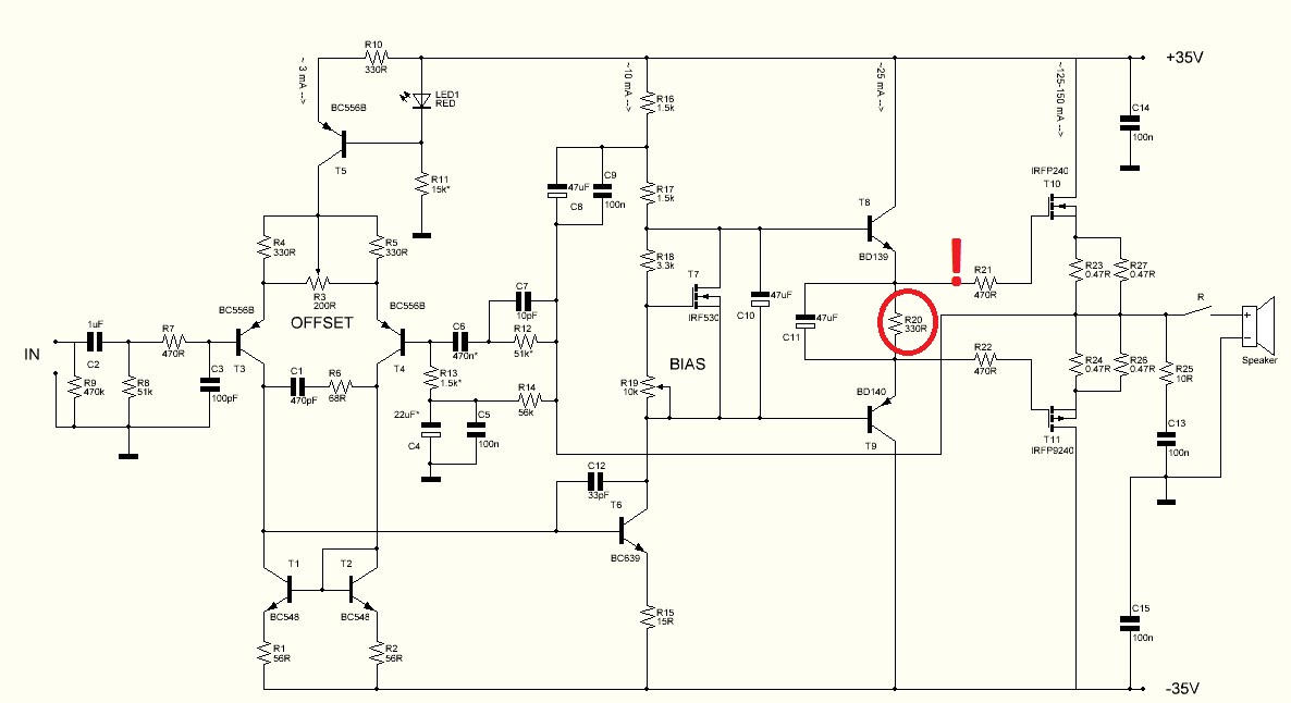

Hello People I'm back...again...
I want to present you my new update to the schematic.
I discovered that lowering the current trough the driver stage resulted in better sonic performance of the amplifier. I tried lowering it from near 50mA to near 25mA and results are excellent. I think that 50mA was too much...
The only thing that need to be changed is the resistor pointed on the picture from 220R to 330R.
Are you lowering the driver current or increasing the output current? 🙂 The IRF loves much current for sure.
Lowering the driver current and yes they love much drive and idle current but that's the result that I experienced - it is a bit paradoxical isn't it.
Simulation also confirms my discovery it shows less THD but this can't be absolute accurate - we know very well that sim's and real world are two completely different things.
Regards!
I think I'm lucky that I found simulation is very "accurate". The THD number is not accurate, but the relative performance most probably is. The difficulty is when each amp/setting has strength and weakness in different area, then it will be hard to judge which factor will decide the final performance.
