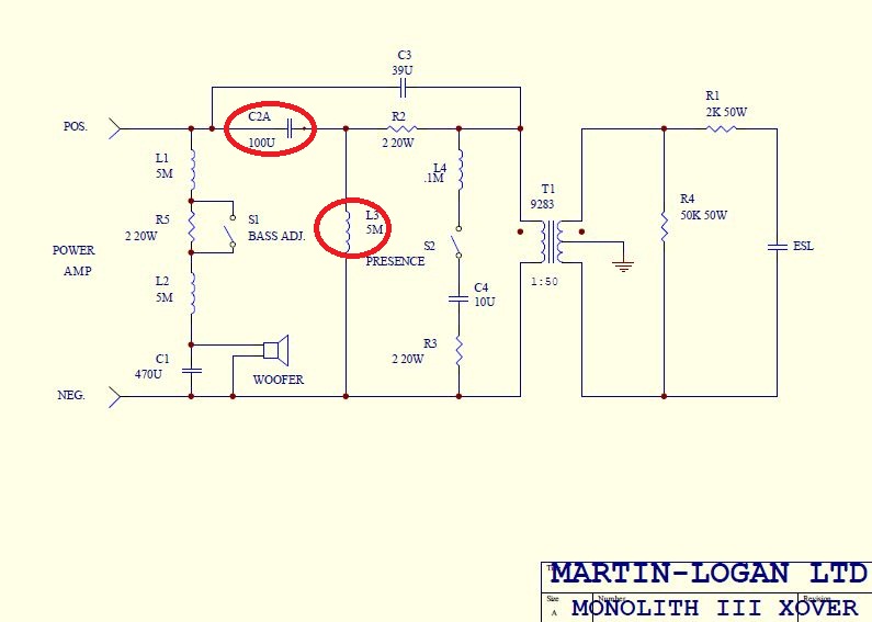

Not so sorry, Martin Logan have rolled off their ESL panel to the 12" bass driver at 125hz with their passive xover at 12db per octave.
Cheers George

Yes, many of us are aware that there do exist (in theory) large enough (iron-core?) coils and large enough (electrostatic?) capacitors to cross-over at 100 Hz. Of course at a mere 12dB/8ave, you end up with less cut (and less protection) to the ESLs at 50 Hz and below than the "rumble filter" on my pre-amp... so why bother?
I'll stick with saying that for Audionutz it isn't practical, makes no construction sense, hard to measure, expensive, can't be tweaked without heroic efforts, the design requires coordinating with the unknown present frequency roll-offs of the drivers (as ML has done), and likely won't sound right at first if ever.
Does it make sense (at 125 Hz) for a manufacturer of speaker systems you take out of a box - who at least can make, measure, and closely-pair (and closely-pair again for stereo) giant iron-core coils and electrostatic capacitors? Seems ill-advised - but that's a different question.

Sorry again they are all air core for the ESL and for the the bass xovers, I have the bass active though at 24db and bypassed the passive xover for it.
I tried active for the esl with both discreate and opamp based active 24db, but they always sounded electronic, they could not compete with the soothness and transparency of the good quailty passive xover that came with the ML's, but the bass I aggree is better when done active.
Cheers George

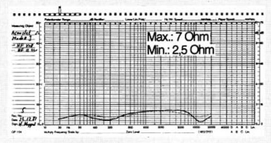

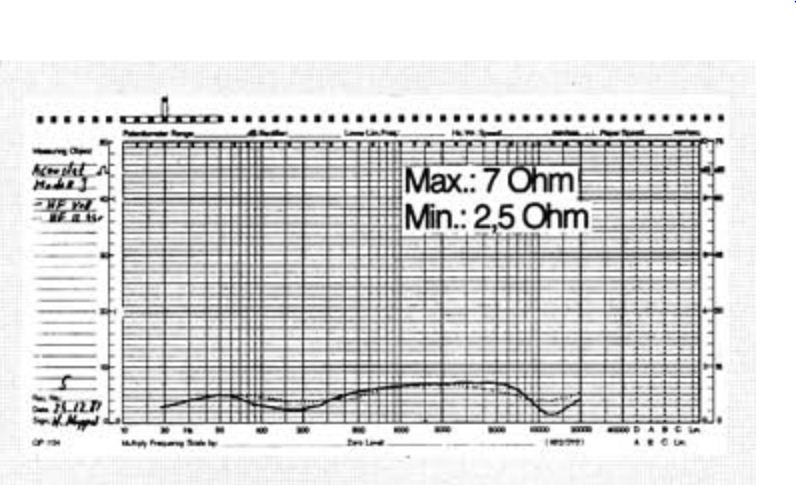

Found a very bad quality x2 impedance graph done by some German company, looks like at 100hz at where you want to do the xover it's about 3.5ohm.
So now you need a guru to work out how many uF series capacitance and how many millihenry air core choke shunt to ground, and you'll have a second order xover at 100hz.
Cheers George

Any serial component, be it resistor , cap or coil connected to the ESL transformer primary winding will raise distortion : the nonlinear current caused by the core will lead to a nonlinear voltage drop across the serial component - ESLs are best driven active with short speaker cable to the transformer...by the way it makes sense to keep resistive part of the primary winding low for this reason...
to sum it up : core distortion ideally is only in the current, not in the voltage..
the amp should be able to drive an almost pure cap with low distortion...most of the existing amps unfortunately fail to do so..

OK.... we're fast off to a bad start. I'll try not to say "told ya so...."
The intractable (and intrackable) impedance curve (and other comments) are just a start. You also need to know just what the speaker output is in the crossover range and below. Traditionally, one of the ground-rules is that the driver/speaker is pretty flat across the transition band, for very obvious design reasons. That band is monsterously wide at 12dB/8ave. Do the numbers.... sort of like 50 to 200 Hz.
Let me add, it IS possible to do what your want. ML tries to do it, albeit 125 Hz is a bit easier. But the development effort to get something even half-passible is enormous and needs test gear. On the other hand, using an electronic crossover is as simple as could be.
