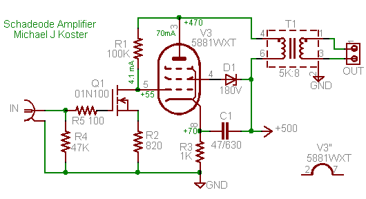

I could not find a complete 5881WXT data sheet.
I hope its maximum screen voltage is rated higher than a 5881 maximum screen voltage.
5881 (non-WXT)
I hope the Screen always draws enough current to keep D1 in its true Zener region.
Otherwise we will have a discontinuity, with the sonic implications, possible distortion,
possible transient "kicks".
And when the plate swings down to 50V, it will be drawing Lots of screen current.
I hope the zener takes that much current.
And, the screen voltage will be at 320V, but the 5881's screen is only rated for 270V.
It will probably always be drawing screen current, since it always is 50V higher than the 5881 screen' maximum voltage rating.

EL84 Single Ended:
The Edcor CXSE25-5K has a 40% screen tap.
An EL84 optimum UL tap is somewhere between 20 to 33%.
40% will be closer to Triode wired mode.
Try the 40% tap.
And try the 100% tap (Triode wired).
Those are easy things to try.
Be sure about the B+ voltage you use, versus the EL84's voltage ratings.
They can do more than those ratings, but do so at your own risk.
Your Mileage May Vary.

Thanks, everybody! I think I'll try out multiple configurations since I have most of the components on hand already, at least I will whenever the Edcors show up. You guys made me realize I can just play around and experiment, which is obviously the most educational and fun way to proceed anyway. I still need to better understand what's in the pages of my copy of Morgan Jones' book, too.
