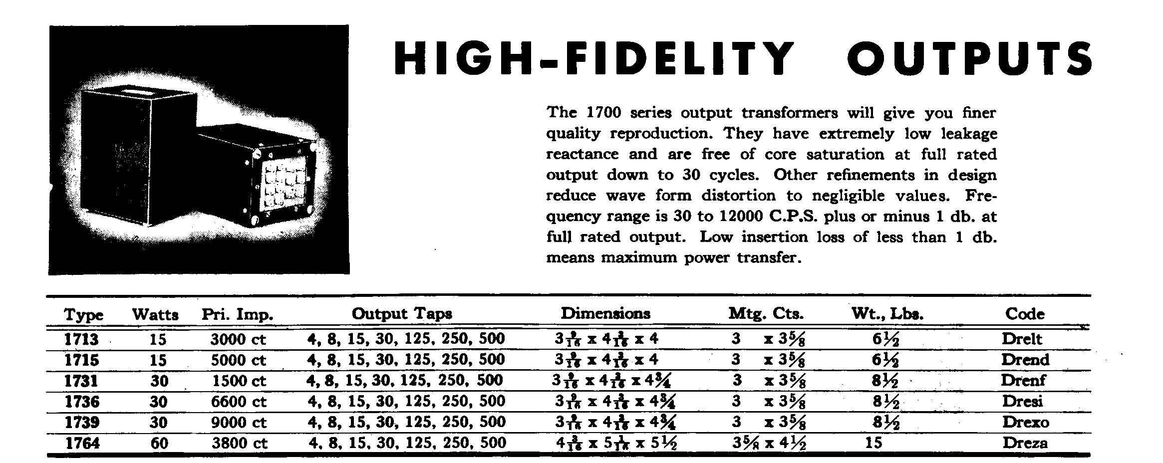

Pair of Hammond 1739 from 1950s-60s era
Specs are 9k P-P primary (no ultralinear windings) to 4/8/15/30/125/250/500, 30 Watts

With those secondaries the first thing that came to mind was something like this amp with added switchable headphone outputs.
Looking at the "data sheet" I wondered though. Enough bandwidth for you? Maybe best to start with what you have on hand and see what they do? Differential 5881?

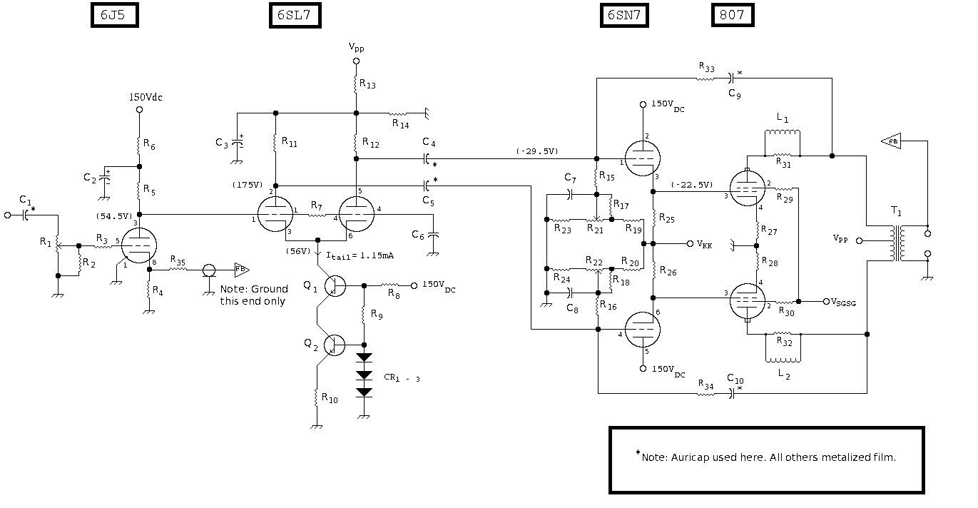

What is INFB? Is there an example schematic anyone can point me to that uses this type of feedback?
lNFB: Local negative feedback -- the output of the finals is fed back into the grid circuit, or at least not more than a gain stage behind the finals.
I did a design using 807s that incorporates this feedback implementation. R33 and R34 are the lNFB divider resistors (C9 and C10 are DC isolation capacitors). These, in combination with the impedance at the node formed by the plate loads of the 6SL7s and the DC return resistor of the 6SN7 cathode followers is the remaining divider resistance: this being:
Rp || r_p || Rg
Since the calculated r_p= 73K8 at the Q-Point of the 6SL7s, that becomes:
220E3 || 73.8E3 || 1.0E6= 52.4E3
Since the Schade white paper recommends feeding back 10% of the plate voltage, that establishes Rf:
Rf= 9 X 52.4E3= 471.31E3 (Select Rf= 470K design nominal value)
You also have to take into account the extra load this presents to the previous stage. In this case, it makes the effective plate load for the 6SL7s look like 144K. Redrawing the loadline on that basis gives a stage gain of 50, for Av= 25 for the LTP, designed measured, for 0% error. :D
It works, and the lNFB recommend was spot on. Sounds great, and a much needed improvement over open loop performance.
Awesome answer guys, thanks. Appears I misread the first letter in the "lNFB" It's an "L", not an "I".
By the way, if others reading this aren't familiar, I believe Miles is describing his Vixen 807 amp design in post #10.
That's what I was describing. For some reason, the attachment didn't take. So let's try again.
