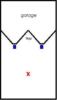

Here's a brief overhead view of an installation I did in the mid 70's.
This is an infinite baffle because the unusual wall keeps the rear wave of the woofers from the listening room.
The woofers are mounted in the wall just behind the mid/hf units (blue boxes). There was one 12" woofer per side. X represents the listener.
Although originally not used in this installation because we didn't know much about standing waves at the time, "trap" represents tightly compressed fiberglass which will get rid of the axial standing waves along the length of the room.
Probably not applicable to your situation but this gives you the general idea of an infinite baffle installation. When the volume behind the woofers is many times Vas, you have an infinite baffle. The garage could be replaced by an attic, crawlspace or large closet.
4 12" woofers per side would be jaw dropping. Of course it needs to be bi-amped. You need to select woofers with a Qt between .5 and .7
