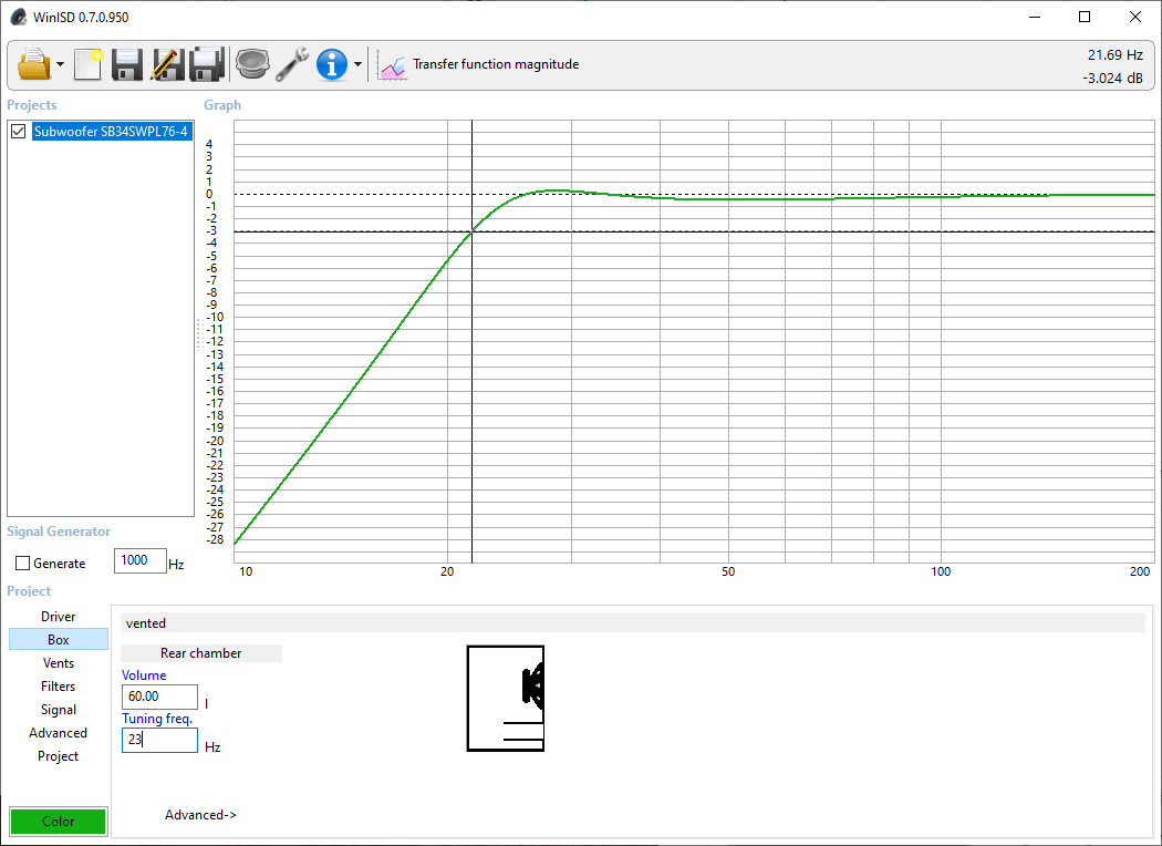

The subwoofer driver I am using is SB34SWPL76-4 and its EBP is 55.9.

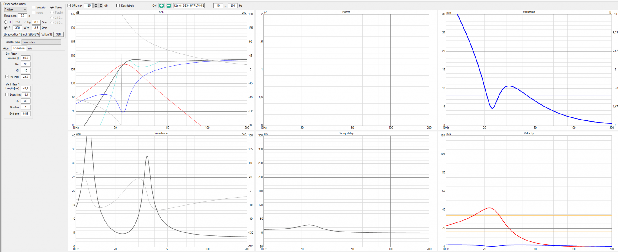

I have modelled a vented enclosure in WinISD for this Sub and am getting a group delay of 30 MS at 23 HZ. The subwoofer enclosure will have a volume of 60 litres.
Group delay is the inevitable outcome of the phase response of a linear time invariant system. GD is just another representation the system's phase response. The phase response is determined by the frequency response of the system and any filters applied to it (crossover filters). Essentially the phase response at any given frequency is a weighted sum of derivatives of the frequency response around that frequency, with less weight given for more distant frequencies (Bode's Relationship). The steeper the response falls off the higher the derivative and the higher the group delay.
Typically the group delay (without filters) magnitude can climb to as much as 50msec at low frequencies. Don't worry about it. You are not really sensitive to GD below 100Hz, and even 50msec is only 1 cycle at 20Hz. At higher frequencies 1 cycle worth of GD is around the threshold of audibility, roughly speaking, with the threshold falling to around 1-1.5 msec by 1kHz and more or less remaining at that level for frequencies above about 2kHz.
The subwoofer driver I am using is SB34SWPL76-4 and its EBP is 55.9. I have modelled a vented enclosure in WinISD for this Sub and am getting a group delay of 30 ms at 23 Hz. The subwoofer enclosure will have a volume of 60 litres.
Note that, of the various vented box alignments that can be used, the QB3 alignment has a quite good transient response. It's a bit better damped than a B4 alignment, which would need a driver with a somewhat higher Qts value. However, the required box volume is smaller, and the cut-off frequency will be a bit higher.
With a 60-litre enclosure and a vent tuning frequency of 23 Hz, WinISD produces the following response:
I expect that the slight peak in the response at about 28 Hz will be reduced a little bit by port and enclosure losses.

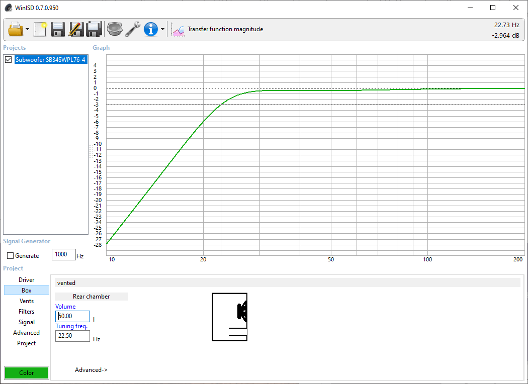

Reducing the box volume to 50 litres and the vent tuning frequency to 22.5 Hz produces the response below. This has a shallow shelf before the roll-off starts, and it will be a slightly more damped response, especially without the presence of a peak. It may be worth considering as an alternative.
Thank you for taking the time to share the details. I am also planning to go with 50 litres and 23 HZ as the final volume for the vented enclosure. I will be using Baltic birch plywood for the enclosure and there is enough space available to build a sealed version of the subwoofer also.
The final plan is to get 2 Subwoofers and I will decide which one to settle on after testing both vented and sealed. Suggested sealed volume in Win ISD is 22.71.

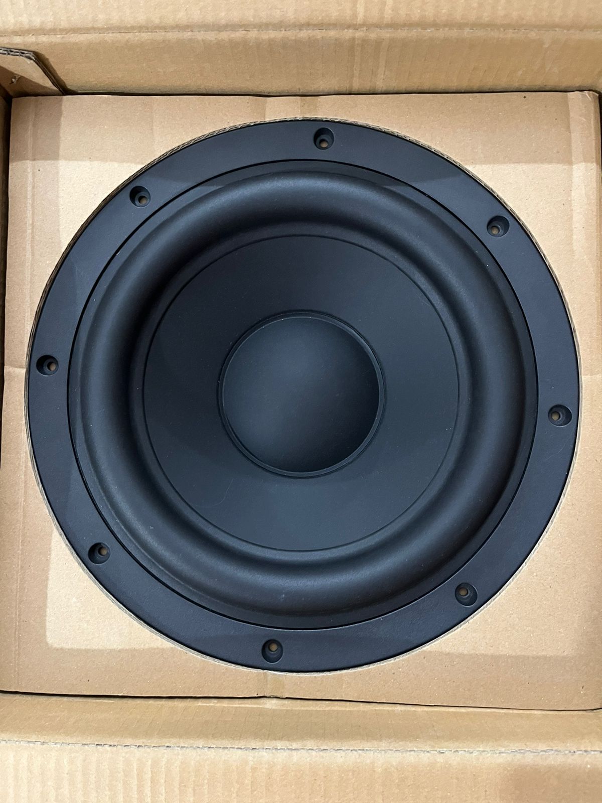

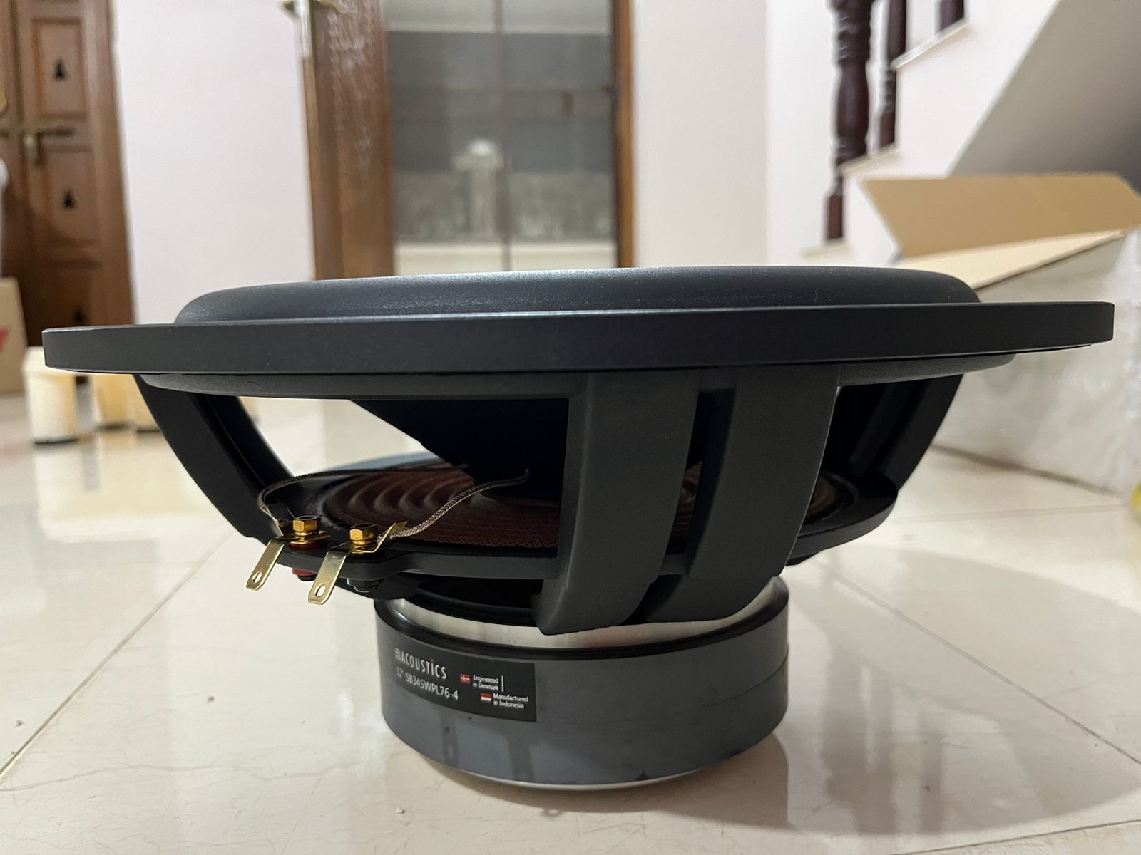

Sharing some images of the driver.

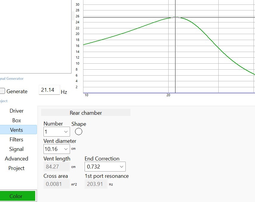

I am planning to use a 4 Inch (10.10 CM) diameter port and the port length is 33.18 Inches (84.39 CM) Hopefully flared port will reduce port noise at listening levels. The final design will have 2 subwoofers so I won't be driving them very loud.
