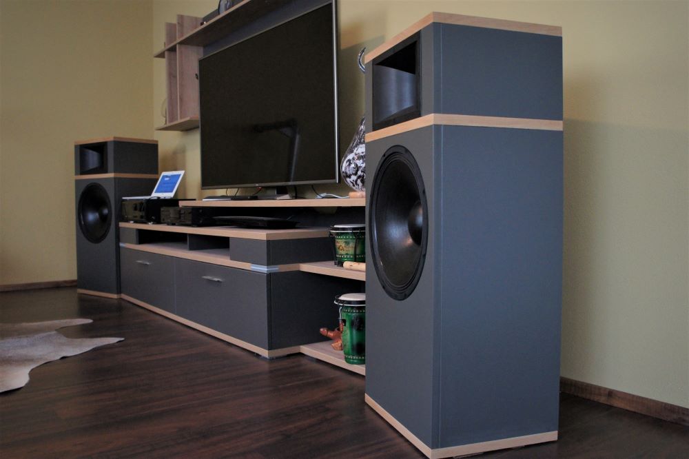

I am currently thinking about this mini JBL M2:
The height of the whole device is 1.04 meters, and with a bicolor baffle, it might be possible to hide its size even more. The waveguide is 32 cm wide, the speaker 36 cm.
1 kHz crossover on the compression driver and a ath freestanding waveguide with a wide radiation pattern waveguide. This one is my current attempt and between 68 degree at 1000 to 60 at 8000 Hertz.

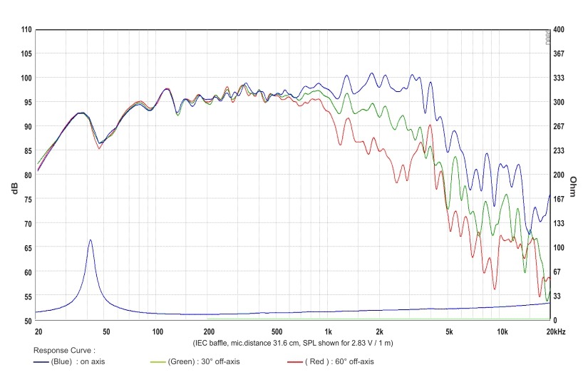

This is how it could perform metrics-wise:

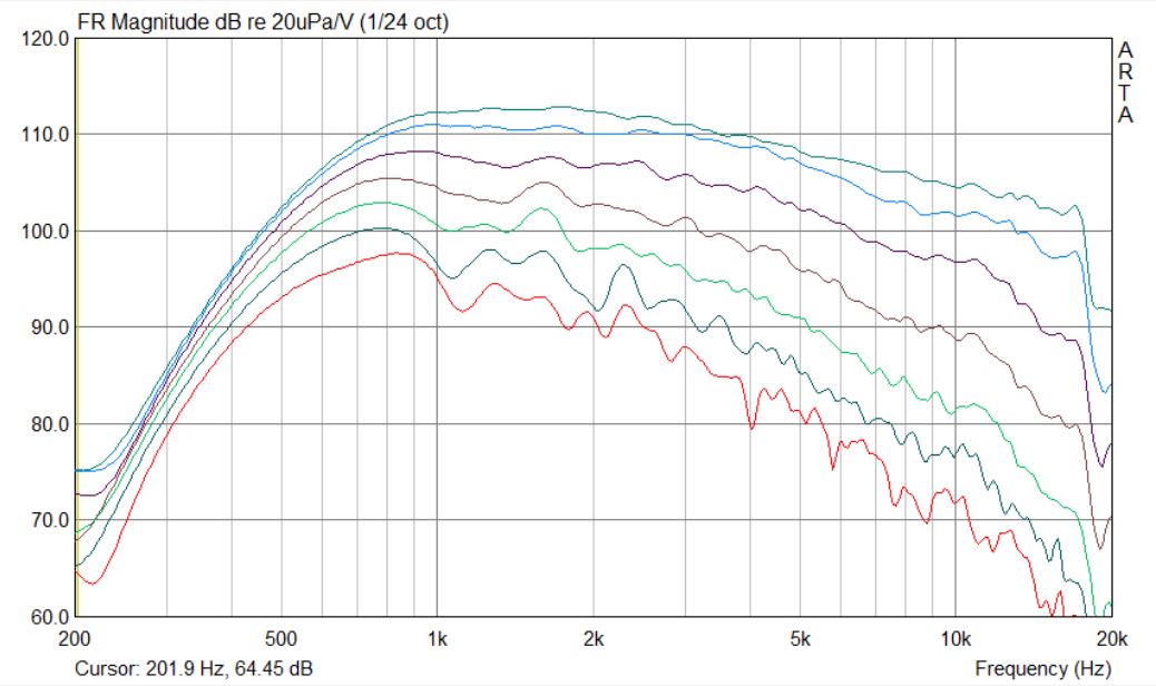

Here are some measurement of the overall SPL and phase.
LF are 2xEminence Kappa 12A
MF are 4xCelestion 5" sealed back
HF is Peerless Tymphany 2525s
Sound damn good now!
RH
LH
These are taken at 1m from the homebrew SH50s.
I did of course take some of just the Peerless HF driver but I can't find them now.. next time
